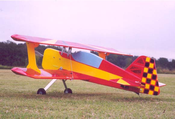

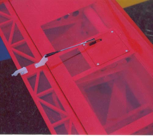

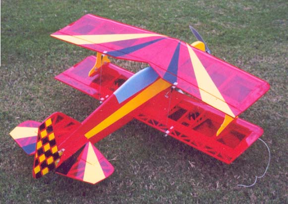

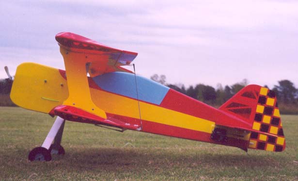

YeeeeeeHaaaaawwwwww!!!!!!!!
Well, after a marathon 2day building, covering and finishing binge, I finally completed this doggone thing......
I don't know what it weighs, but the guys at the field today told me that it feels pretty doggone light.... I will wait and see. All servos are standard size Futabas except for the HS 81 on throttle. Batt pack is a 5 cell 700mah Nimh pack. I put an 8 ounce tank on it to feed the TT .46 Pro (thanks Gator, it runs grrrreat). I made some special mounts for the engine that allow the right thrust to be adjusted pretty easily. It will also allow me to change motors should I ever need to. (don't think I will need to).
After finishing her out, I took her to the field and let a couple of buddies check out all the connections, etc, to make sure that I did not miss anything. The CG was just right the first time, no weight added, and did not have to move anything.
I taxied her around for a minute, and pointed it into the wind. 3/4 throttle and it was instantly in the air. It only took a click or two of aileron and elevator.
After feeling out how it responded, I did some flat spins and even pulled up into a hover for a second or two... (all my skills will manage). I tried knife edge, which it does pretty well, and some aileron rolls (very axial). I finished off this first flight with a three point.
It still needs some dialing in on elevator movement, but I am pretty happy with this one..
I hope ya'll like it.

Just tell me how much and where to send it!!
Old 10-05-2003 | 09:00 PM
Banned
Posts: 1,984
From: Tulsa, OK,
Default RE: Profile Pitts Model 12 Complete and Hovering.....
Wow, that looks great!!! Very good looks, and I'm sure a great flier. congrats!

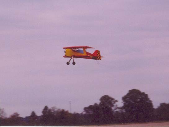

Almost forgot the hovering shot.....
In a hover, it hangs there pretty well. On the second and third flights, I got it to hang in the hover pretty well. It stays on its own for a pretty good while, and I think I will be able to 'control' it back into the hover when it gets out of shape, but I am still overcontrolling it and making things worse. One of these days, I will get better.....

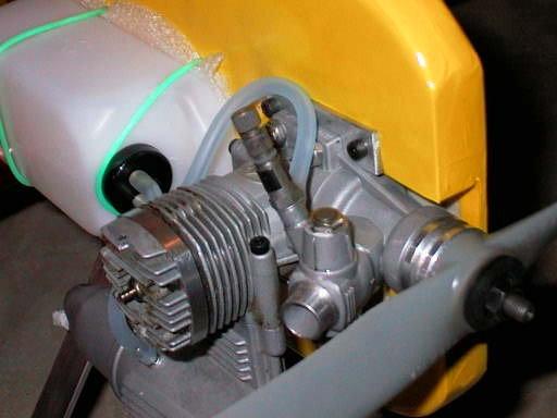

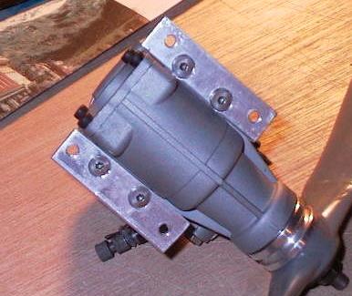

I'd like to get a better look at how that engine is mounted:-).

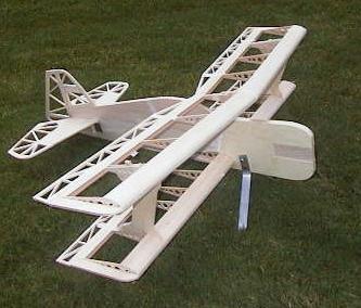

Jeremy..you ought to post a couple of the "bones" pics so guys can see what she looks like "nekkid". I've seen it in the bones, and it's a work of art.

Thats sweet dude, I saw it in the bones at nashville and it really looks great. You gonna kit it? i want one

Thanks a bunch for the compliments ya'll!
I did all the design work for it in CAD, so I do have CAD plans. They are almost 'done', just need a little more detailing on one of the sheets (2 sheet plans) for someone else to be able to build from them. (I draw plans for myself, build the plane and then go back and label/detail/make changes to them if I need to....). The other benefit of doing the work in CAD was that I was able to have a 'short kit' CNC cut for it, which I used to build this prototype. Finally, I took pictures of almost every construction step in high res digital so that I could do instructions if needed (and I do mean every step, I took over 100 pictures...).
I would like to make the short kits and plans/instructions available, but I want to make sure it is 'right on' before I do so. I don't want something out in the world with my name on it that is not right.
I mounted the engine using metal 'sub' mounts. The engine bolts to the mounts, then the mounts are bolted to the maple engine rails. Makes the mount extremely strong, and engine changes can be done in a snap. I could take this on from a TT .46 Pro to a .63 4stroker in a pretty short time because of the rail/submount system. Other advantage is that it makes setting the right thrust easy to experiment with and set.
Here's some pics of the mounts and the bones.....
