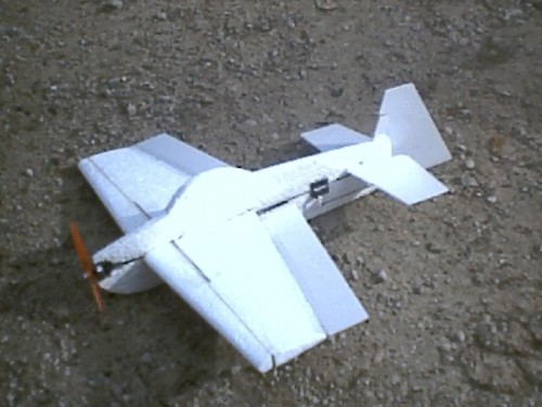

This is my latest scratch build. It was inspired by the Top Cap. AUW is 3 1/8oz, WS and length are both around 20". I maidened it in 17mph winds, so I don't know if it hovers well, but it should be able to since it has 8oz of thrust at WOT. Hover tests in the living room resulted in a slight pull to the belly, and I had to grab it before I could get my hand to the TX. I think I need to adjust the vertical CG. I'll try again in the living room once I get it tweeked.

Looks GREAT MIKE! Why didn't you maiden it in the living room? Can you balance a model through the prop nut to acheive a low maintenance hover? I've never tried that and maybe that's why my planes are alot of work to hover.

Too much work to dork it into the couch on the first flight. I'm gonna get a feel for it in a bigger space before I try the living room again. I usually don't balance mine vertically, but this one looks like it might need it.
The prop in the pic is a 5x3, but the 6x3s I ordered came shortly after those pics were taken, and the second flight was done on that prop. I would love to try a 7x1 or 7x2, but I don't think that prop exists.

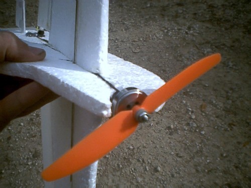

I've seen that motor before. What are the specs.? Where do you get it, and did it seem to have a lot of power in hover? and was that 3.1/8oz ready to fly? Looks really good!!

Its a cdrom motor I made. It weighs about 1/2oz, puts out 8oz of thrust, and draw about 5.5amps. It will hover at 1/2 throttle. Yup that weight is rtf.

There were some holes in my stator between the bearing and poles. I fed some thin tubing through 3 of them and then fed the magnet wire through the tubing. I left just enough wire sticking out to solder the controller wires onto and then put heat shrink over the joint. I know most motors don't have these handly little holes, but they help with the wire breaking. I'm working on a bigger one for a Shock Flyer that I will have to think of another solution for. I'll let you know what I come up with.

ORIGINAL: mike feuilly
I found out my motor only puts out about 6.5oz of thrust at about 4 amps with the 340s.
Hi Mike,
I'm working on my first direct drive CD-ROM. I have built a couple of geared units on which I run 10x4.7 prop getting around 12 oz static thrust from 5 Amp (3s1p 700 LiPo). But I didn't do direct drive yet. I want to save a weight on my 16inch wingspan Ultimate Biplane so direct drive is the option here. What I need is around 6oz thrust from less than 5A from 2s1p 340 LiPo. Exactly what you have.
So here are the questions:
1. What winding did you use (how many turns, what wire)?
2. Is it delta or star connection
3. You did use 6x3 prop, right? Did you try 7x3 ?
RysiuM
Old 01-21-2004 | 09:03 PM
mike feuilly's Avatar
Joined: Nov 2003
Posts: 89
From: Weatherford, TX
Default RE: Micro Profile
1. 14 turns of 26awg
2. star. I also tried 30 turns of 30awg in delta configuration and got similar results
3. 6.5oz@4amps was done with a 6x3, but I've been flying with a 7x3.5 lately.
Unless you've got REALLY good stock magnets, I would recomend replacing them with 12 5x5x1mm n45 magnets, or your results will be a lot different. Another thing to consider is stator size (seems to be what everyone goes by when comparing motors). Mine is 20mm. I'm working on another one with a 23.5mm stator like the Chipsledde motor.
