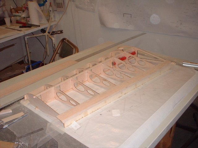

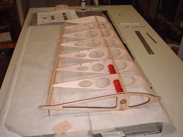

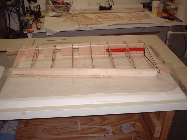

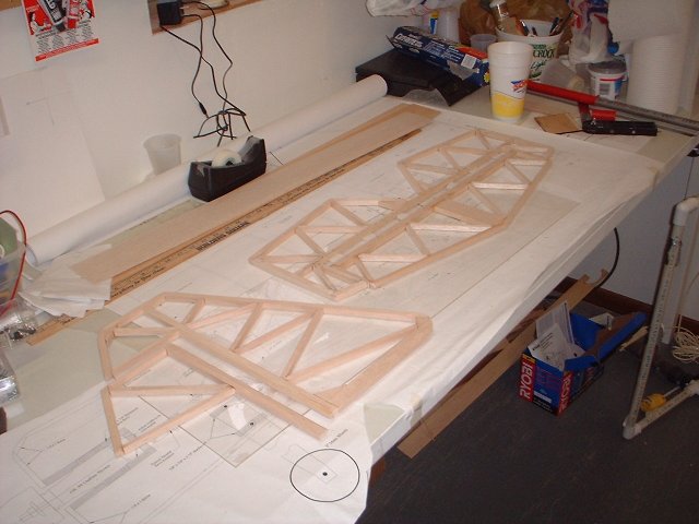

I guess I'm not doing to bad, made some head way on the wing.

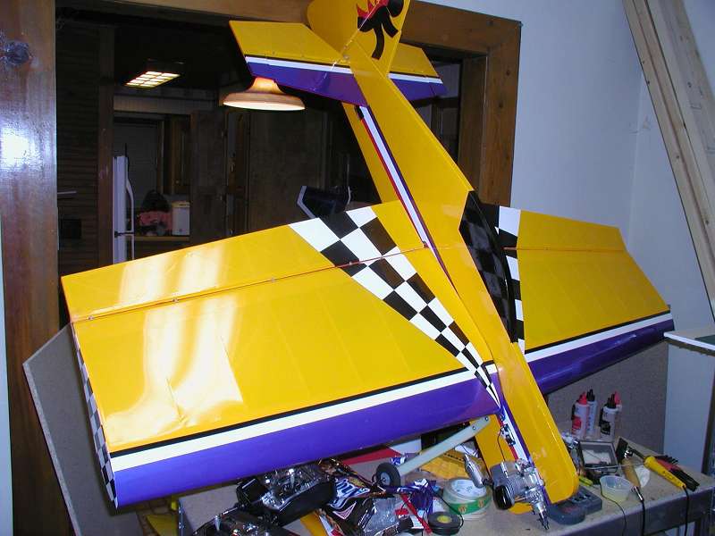

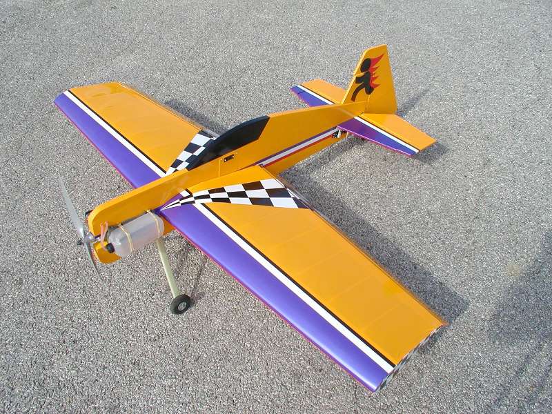

Ok ive been meaning to get photos of my yak for awile but my crutches have made it difficult but here is a picture inside the clutters work room. Ill take a better picture outside later. Ended up weighing 6 pounds 15 oz when i installed the bigger battery pack and YS110. Cant wait to maiden

Wow, very nice Constrictor. What is the wingspan and length on the Yak?

Should be 65.25" wingspan, 59.5" length.

Looks good steve, you should be happy with the YS. I saw Chris Hinson fly his 9lb EXTREME FLIGHT full figured YAK this weekend at the Perry Ga. swap meet and it had plenty of power to spare, very impressive

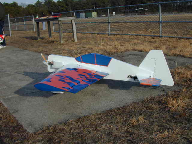

Hi guys,here my modified yak.Webra 1.2 @7.75 lbs rtf with 13oz. of fuel. and w/p.Its not a high wind operator,the wing loading is very very low.K.e. with no forward movement.
