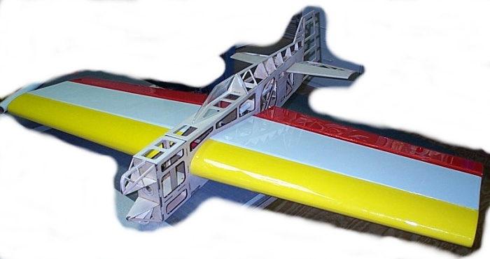

Default Another Pic
Just another pic.

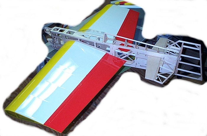

Default Wing Pic
Last pic for now.
Let me know what you think!
Kevin

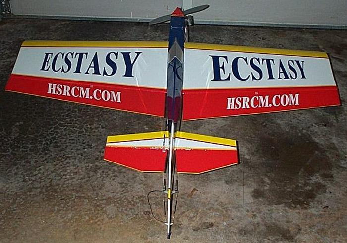

Default Covered!!!
Here is a pic of the Ecstasy completely covered.
Kevin

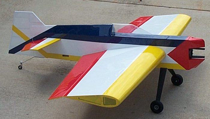

Default Covered 3
Here is the other side.
By the way, the Ecstasy covered, landing gear installed, engine mount installed (as seen here), weighs in at about 4-1/2 lbs! I don't think that is too bad for a 90-size Fun-Fly.
Do you?
Kevin

Default Finished!!!!
Well I finally finished the Ecstasy. It weighs in a 7-1/2 lbs. There a few changes that I made to the product version of the design to cut some weight out, though I don't imagine it will be much. It has a ST90 with a Mac Header and tuned pipe, 4- MPI870s and 1 std. servo, 1400 mA 4.8V batt. pack.
You can see more pics of the final product on my website at:
http://www.hsrcm.com
I hope to test fly it tomarrow between the rain drops.
Kevin

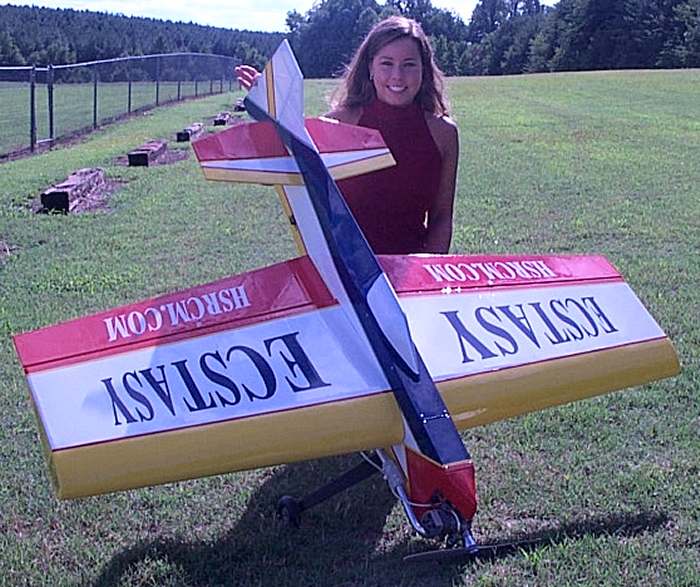

Default FLIGHT Report!!!
Simply AWESOME!!!
Its a keeper!!!
Climbing flat spins! - both inverted and upright! This is the first aircraft I've seen perform the climbing upright flatspin & inverted. Climbing tornados - no problem. Floats like a dream. I forced into a stall. It needed high rate elevator to force it into a stalled condition in level forwarded flight. It drops the nose about 4 to 6 inches, then picks up the nose right away. Knife edge loops - no problem. High alpha knife edge - no sweat! I still have some tweaking to do on it. The engine is not coming onto the header quick enough, so I still need to tune the header some more. It currently hovers just over 1/4 throttle, though right now since the engine is not coming onto the header at this low rpm, I have to fluxuate the throttle to hold it. It wants to tail slide, which it does very nicely as well.
I am charging it tonight so that I can spend some time at the field tomarrow to tune the header properly.
This one is going to make the kit form.
By the way, I got a better picture of the Ecstasy - at least a better looking model. This young lady is Kimberly. Kimberly is wife to a good flying buddy of mine.
Kevin

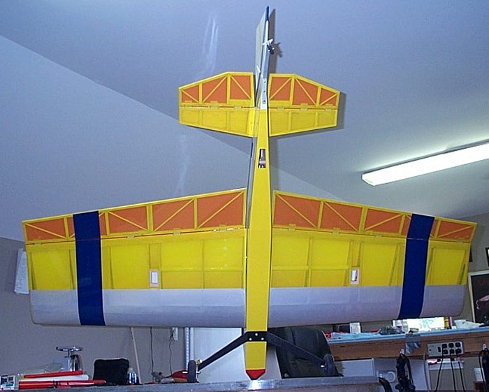

Default The model's a keeper huh,
but I thought you said Kimberly is married he he.
Happy to hear the good progress on the model (Extasy, that is). From the picture it looks like you didn't cap the wing tips. It looks like you just have the lightened wing tip ribs in there, any reason for that?

DKJens - Yes she is a keeper - but not mine (Ha Ha!). I had to get a pretty young lady to model with the Ecstasy like the Big Boys. I'm just too old and ugly to model with it, so I've been told (LOL)
The ends of the wings are covered with transparent yellow monokote. They just look open, but they are not. I just updated my website with some test flight report info. I can't wait until the ST90 is broken in and I get the header tuned better. I took some movies today of a friend of mine flying it (Kimberly's husband). When I find some time, I'll edit the movies and post them on my website.
