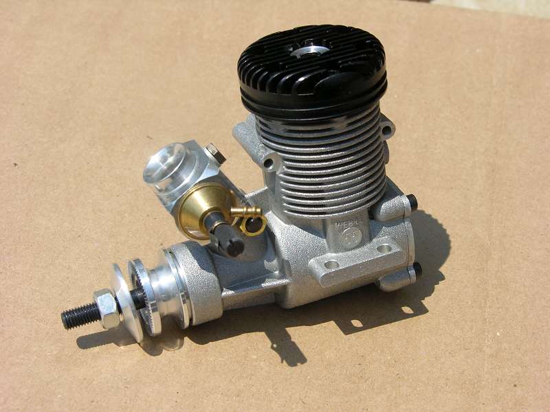

Old 05-19-2005 | 11:12 PM
depfife's Avatar
My Feedback: (14)
Posts: 5,057
From: St. Louis, MO
Default RE: Katana 40 ...Which 2 Stroke?
I think the Webra 50 and Irvine 53 are great 40 size two strokes for profiles. The TT 46 Pro is also a good engine at a reasonable price. The Webra and Irvine will run you around $125 - $145 new. The new Webra Speed 55 looks like it may be the new 40 size powerhouse. I just got one, but it is still in the box. It weighs the same as the Webra 40, and is advertised to have almost as much power as a 60. The bad news is it costs almost as much as a YS 63.[:@]
Eric

Old 05-25-2005 | 09:21 AM
depfife's Avatar
My Feedback: (14)
Posts: 5,057
From: St. Louis, MO
I got a return call from Horizon last week. The lady that called said they were picking up the engine and it would probably be available around the end of June. I have got my Webra 55 mounted on a Burrito and like it so far. With the stock muffler it is turning an APC 12.25x3.75 @ 13,000 rpm. I have less than a half gallon of fuel through it, so it may have a few more rpm in it.
http://www.rcuniverse.com/forum/Webr...2740682/tm.htm
The link is to a thread in the Glow Engine forum about the 55.
Eric
