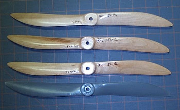

Default Eat your hearts out!
I got the wood versions of the APC 12.25 x 3.75 props from Andrew today. I can't belive it, but the mail showed up at 6:30 PM
Here is a pic for you guys to drool over.
Kevin

Default Some Test Results
Andrew - winds were too high here today to fly. We are having gusts of over 30MPH, so I didn't even try to fly, though I did set-up in the backyard and run them. This is my results for just taching them in the backyard and weighing them. My daughter happen to bring home from school a precision scale so I used it.
Manuf. Size WT. Tach
APC 12.25 x 3.75 42 grams 14.3K
AJC #1 20.76 g 13.8K
AJC #2 24.8 g 14.1K
AJC #3 26.6 g 13.4K
Y&O 12 x 4 19.73 g 14.7K
It is strange that #2 did better than #1 since I had to do the most work on it to balance it. Usually I have found that it is the other way around. Hopefully the weather will be better tomorrow. By the way, the Brodak Y&O 12 x 4 prop broke in my hand at the hub when I went to remove it from the motor. Sure glad that it didn't happen in the air! It would have torn the plane apart before I could get on the ground, or stopped the engine. Needless to say, the throttle response on yours was significantly better than the APC. That I expected with the weight difference. The Y&O had the best throttle response, though it also flexes with RPM and is the lightest, but after it broke in my hand just loosening the prop nut, I don't think that I'll order any more. Too dangerous!
I let you know how they perform in the air first chance that I get.
Kevin

OK sounds good. Glad mine didnt break in your hand!
I think the #2 prop (the one that is just about 1/32 thicker than the apc) is better than #1 as it is much stiffer yet not too thick. Not too much down in RPM from the APC, at 200 rpm.
Almost 1/2 the weight, I hope it performs where it matters, in the air!

I ran the props Andrew sent to me today. We had a high of the mid 40's, cold wave for us, though there was hardly any wind, so I went out. I'd have to say that they were a great success. I tried #2 first since it produced the max. RPM on ground test. Response was great, pulling power was better than the APC 12.25 x 3.75. I have no idea why Andrew's version pulled better, but I had to drop my dual rates by 20% across the board to realize comparable performance. The APC must flex more than I realized, where Andrew's did not. I allowed a friend to try #3 while I ran #1. I firmly believe that #1 had the best response rate, though it should since it was the lightest. I may have been my imagination, but I believe that it was better than #2, though barely. #3 was better in throttle response than the APC, though should be. #3 didn't perform as well as #2 & #1, though expected.
I want to thank Andrew for giving me the opportunity to test these props. They worked fantastic!
