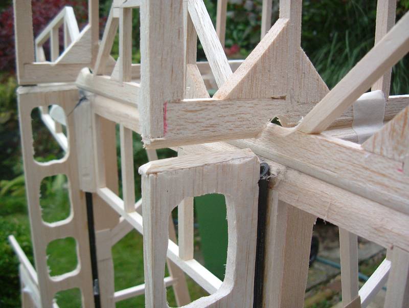

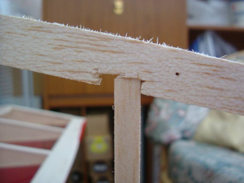

Enclosed a couple of errors.
First a slight difference with the rudder post [ooopps!]
And the second, oopps cut outs in the wrong place!![X(]
There is a reason and I will explain.
For the servos as there seems to be enough depth in the wings for standard sized servos so may be I'll just use ball race for the "flappy bits" and a couple of standards for the the throttle.

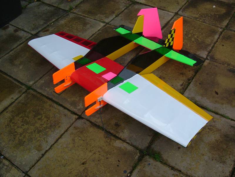

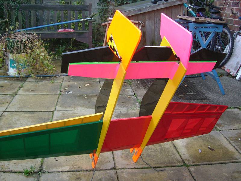

As promised the photos of the covering
Why all the different colours?
Most modellers have a scrap box, well, I also have a leftover coverings box, or in my case a large black bin bag. So to be a bit different I used some of the larger leftovers to cover this plane.
Naturally it had to be bright!
#30
Joined: May 2003
Posts: 179
From: Wilmslow, UNITED KINGDOM
Nearly finished!!!

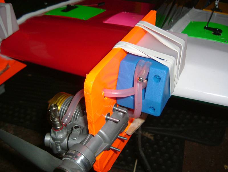

The first photo shows the engine installation. Which is relatively simple in the case of a profile. However I have since moved them both further forward to help balancing for the C0f G.
Although for a two engined plane I'm still experimenting for the Cof G, initially I shall start just rear of the main spar, which is about the place for the "Taco".
Note the white bath sealant at the wing joint. This is a quick and effective way to seal the joint against fuel penetration.

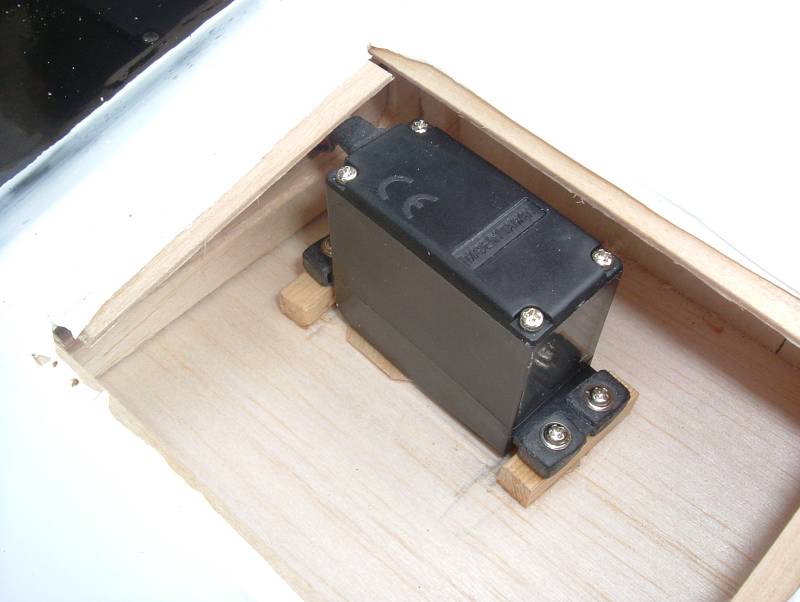

The second shows the dual rudder set up. I had tried to link the rudders by linking them using traditional horns connected at the hinge line but this failed to give dual movement. [ie both rudders moving in tandem]. With the ball joints and bolts securely glued into the rudders this systems appears to work.
Hopefully the third shows the all metal pushrod assembly has been followed from the "Taco" construction, which is still used successfully by Sig with their Fazor [my first introduction to profiles].
Note I've increased the "rigidity" of the pushrod by use of saddle clamps and tubing.
I'm not sure if it will work but I've glued hardwood bearers directly to the wing skin and mounted the servos directly to the assembly. Where the servo output head passes through the skin I've glued a ply "doughnut ring" to protect the edges. [Not necessary through the plywood hatches].

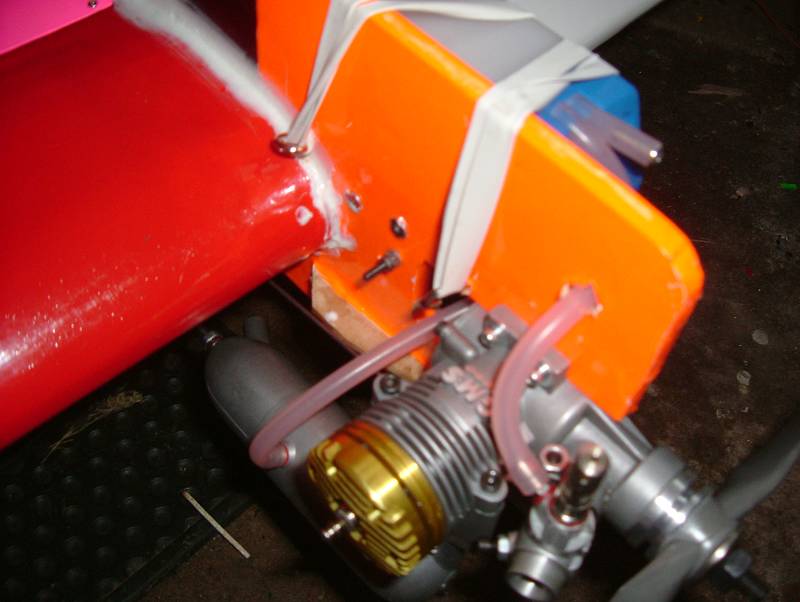

These first two photos show the installation of the 4oz fuel tank. The hooks and eyes were given additional strength with a little drop of thin "cyno" added to the hole prior to the hook or "eye" being fixed.
On a test run the positioning was just right for the engine to run smoothly.
All four access hatches have permitted the "radio installation" to be secreted within the wing space.
