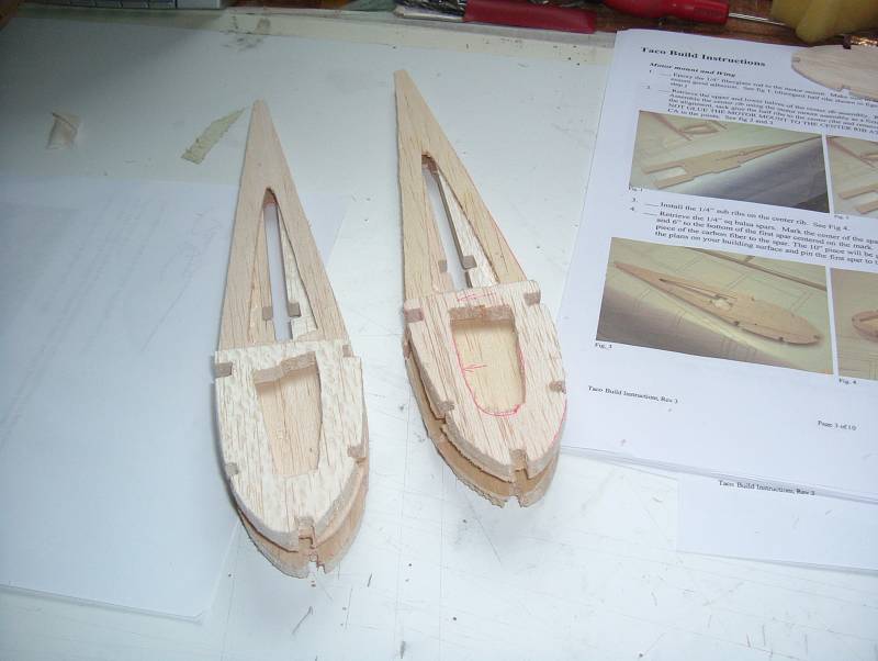

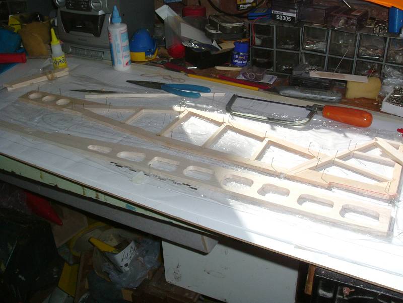

Having made the extra parts required. The instructions were downloaded from Paul's site.
Construction was relatively easy and quick.
The photos show the ribs and the sub rib construction.
The wing was easily constructed by building the right wing, left on the plan built inverted, with the addition of the centre section. When this was dry, fairly short time using cyno and having a "tea break", the structure was slid along and the remaining wing constructed.
In answer to the engines, the offer was for two GMS 25's which I know little about except reading the odd bit off the net. However I must say I was impressed when they fired up on the test bench with only a little priming and were fairly easy to adjust. I ran with 8.5 X 6 Bolly's.
If all goes well here are some further progress photos. With a little teaser taken tonight.

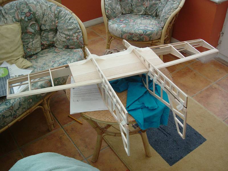

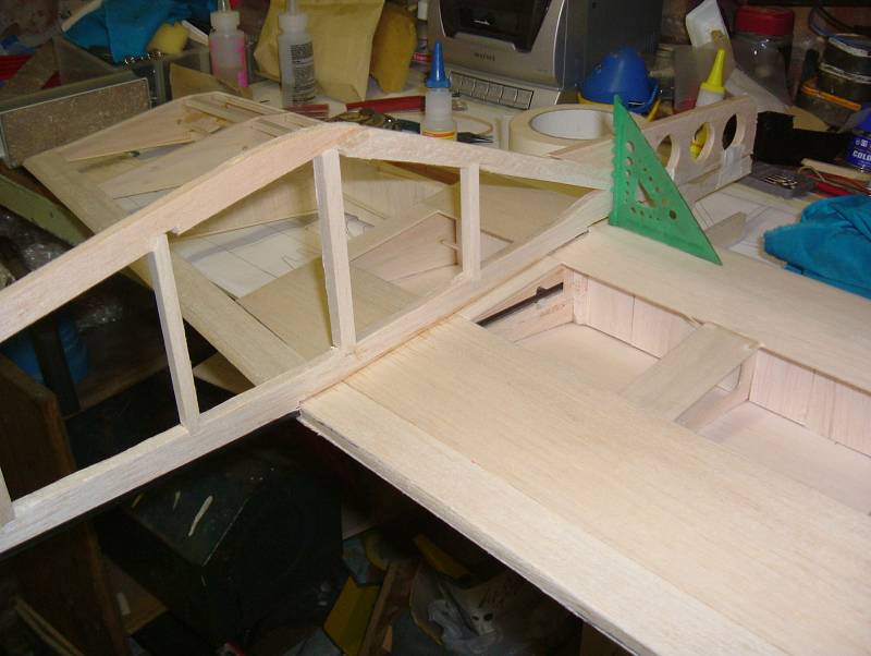

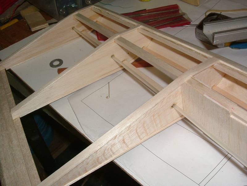

Here's a few more progress shots. with a little construction detail
Had a delay due to running out of 1/16th sheet balsa but that's now remedied.
Picture one shows the centre section now covered, with space for four hatch positions. This is to allow me the luxury of "carefully positioning the servos.
Picture two shows the inclusion of tubing to feed the receiver cable through the wing
And the third photo the engine mount just hung around

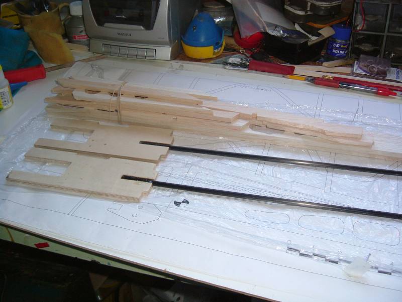

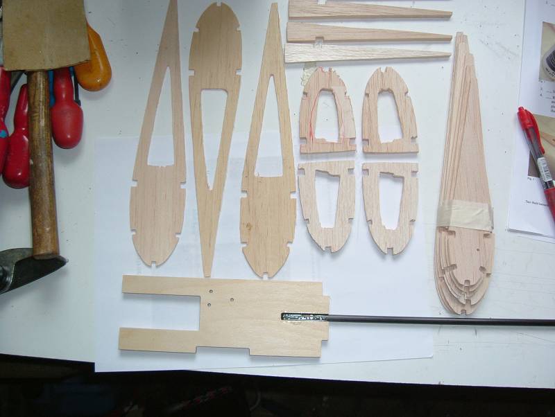

Fus construction and progress photos
A slight deviation from the instruction with the use of carbon fibre tube instead of fibreglass tubing. Other than that construction followed the instruction manual.
On completion of both frames these were taped together and any "highs and lows" sanded out.
As expected when "scratch building" discrepancies do occur, check the joint to the wing. This required some "balsa bashing" to get a good close fit.

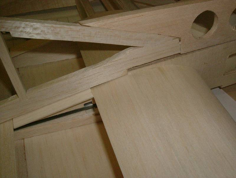

Some more progress photos and comments
A little "balsa bashing" was necessary to obtain a better fit to the wings.(A closer photo of the gap from the last set of photos)
With this achieved the upper fuselage was epoxied to the wing and the carbon rod was held in place with the masking tape and then cyno was run along the joint. (I've found that this is more than adequate to join carbon fibre to balsa).
The lower sections were then epoxied and cyno'd. And left to cure.

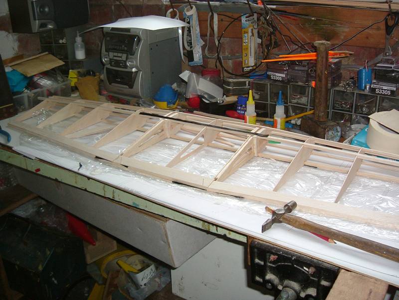

Well with one thing and another computer time had been down but a slight chance for an interim update with some photos. These are best described as building the "flappy bits".
Picture one
This bit is in fact not a "Flappy bit" but an essential part of the construction process, the "stabiliser". Like the wing the centre section is also separated by a 91/2" inserted centre section.
picture two
This is the construction of the elevator, which is all one piece.
I've taken a bit of a gamble here and reduced the overall area. This is because I have assumed that with the increased centre section this may cause the elevator to be too effective. I can always build a larger elevator if necessary.
picture three
Rudder construction is fairly straight forward, times two.
Except where the proposed leading edge of the elevator passes through the rudder I have put some balsa braces as some "balsa bashing" in the shape of a cut out will have to be made in the rudder edge.[picture four]
I didn't take a picture of the ailerons!

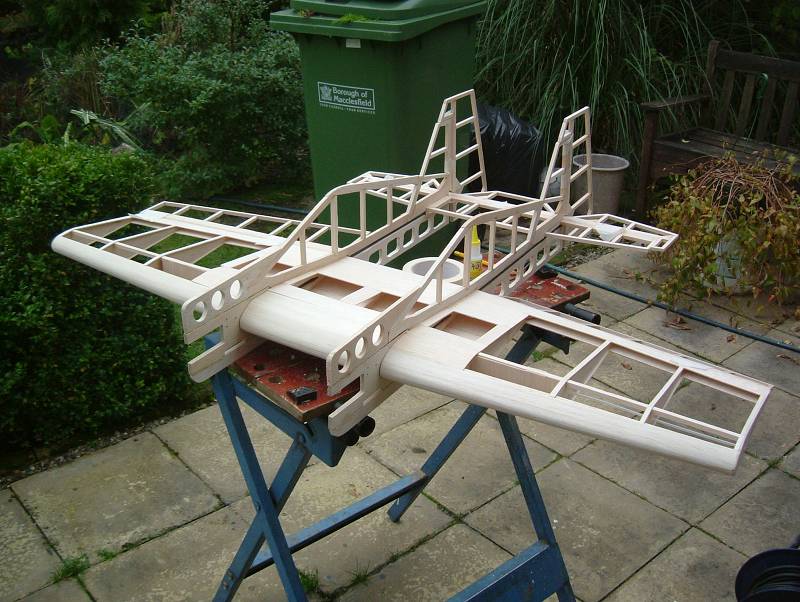

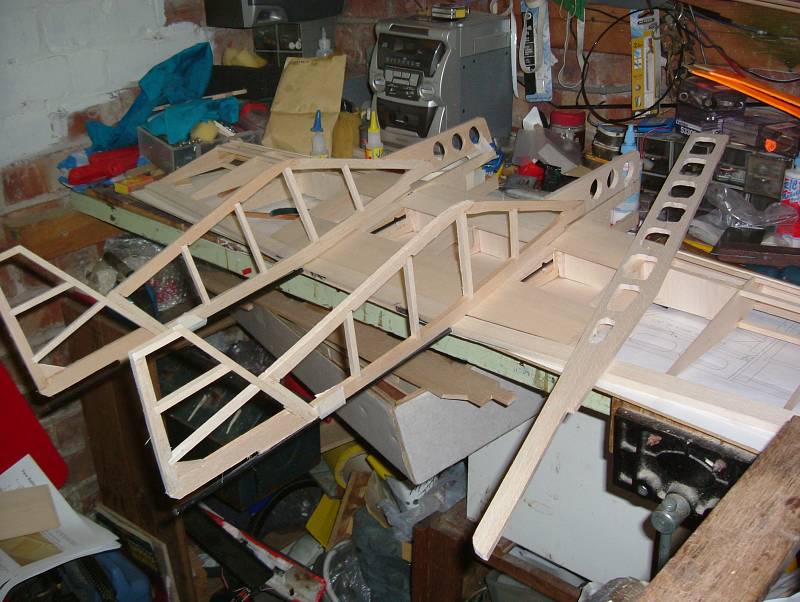

I've finished the construction, well major "balsa bashing" so below is a Naked Double Taco

Looks great. You didn't think about a flap in the center? You don't need flaps, but you might use one in a crow set-up.
I would also think about holding elevator and rudder servo placement until you cover and install engines. You might need to move 1 to the rear for CG.
I found I needed something stronger than HS 81s on ailerons. They just weren't powerful enough.
On my twin fuselage Sky Raider, I used double servos-2 aileron, 2 elevator, 2 rudder, 2 throttle. You normally use 5 so this is 3 extra. I also split my elevator in the center and mixed to get them together a la dual elevator set-up.
