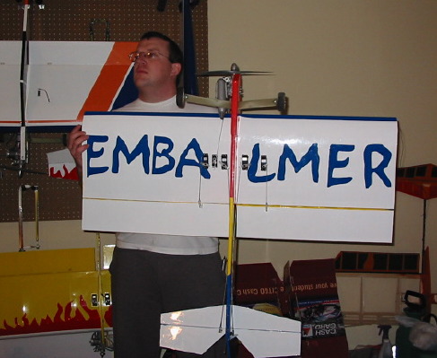

After a few months, I finally finished covering it today.
all I have to is install everything, balance it, then cover wing tips.

right now I have the bottom as all white. I might change that later.

Old 01-09-2003 | 12:06 AM
  #31
Posts: 1,145
From: Oskaloosa, IA
Default Knife Construction
Checkerboard that bottom Embalmer!
The plane looks great!

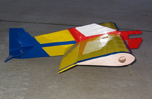

I aint got the heart to tell him he forgot the TIPS!!!! :cry: ......<GRIN>....Looks GREAT Mikey......how about that fish/duck/fish/duck thing..you ever seen that?????? your looking at ducks and then the next thing you looking at fish...I been waiting to do that on a wing sometime......Gator

Well I have an idea for the bottom of plane, but I left it off for now. Once I get it on I will post pictures. I am in the process of working on it. I might end up doing some graffics on top as well.
Gator, you know this trick. For the wingtips, not being covered. Instead of installing motor, radio gear, pushrods, clevis', then balance plane for CG and laterally. Then have to remove everything. Then cover it, then reinstall everything.
I cut a hole in each outer wing tip, once I install all my stuff. then when balancing, if I have to add weight to a wing tip, I can install it inside the wing, then cover wingtips, and I will be thru. that way I don't have any weights sticking outside the plane.
I really don't have an imagination. I got the scheme from the plane I bought off of Jeff Williams at the brotherhood flyin. I crashed the planed. But doesn' it look similiar.

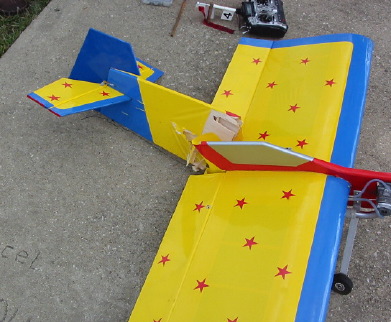

It's snowing here in the Memphis TN area today on my day off. I finished my knife.
I have New TT46 w/ stock muffler (for now) once I get it broken in I will put a moosecan on it.
JR R600 receiver
700Mh battery.
Hitec 225BB-throttle
JR-531 rudder
JR537 on elevator, and alierons.
all up weight is less than 4.5lbs (great job Paul) on my not so accurate fruit scale. Once I get the motor broke in, and put the moosecan on it. the moosecan will take off a couple of ounce from the stock muffler.
I have put any graffics on top yet. But here is the bottom. Its much better than just plain white. the lettering is monokote.
