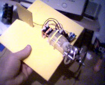

I built a tiny PBF
061 norvel with throttle

Have you flown it yet? I'd be interested to hear how squirly it is. The regular size one flies great, but can be a little touchy.
Keep us posted.
Andy

Not yet but when daylight hits ill try it

What is that, about 8" square!?
In the 1/2A forum, Dickeybird has built a 1/2A PBF but built it up from balsa, hasnt flown it yet. Interested to hear how your flies too!

A guy at our field built one of these for me. It flys great. It's a lot faster and a little twitchy but still very fun like it's bigger brother. He used 2mm to make a hollow, very light, fuse. I LOVE IT!!
Jason

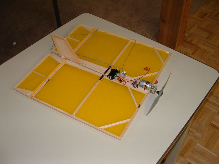

Here's a shot of my E-PBF. It's geared sp 400 with an 8-cell pack. It weighs in at 13.74 oz. My first one made from 2mm coro weighed over 16oz and was kind of doggy. This one flies much better but it still needs more power. I can only pull out of hover in the first 30 seconds or so of the flight. Any later than that and the battery has fallen off too much. It will still hover, I just have to let the nose drop and fly out. I have crashed it twice flying it in my front yard. The trees keep getting in the way! It has survived unhurt both times. It has done a spin into the grass that I couldn't save but it survived that as well.
later,,,basmntdweller

Old 11-19-2002 | 12:56 AM
Posts: 76
From: Tampa, Florida
Default Tiny PBF
it looks really lite
will it go strait up?

Posts: 1,752
From: Indianapolis, IN
Default Tiny PBF
It will but only for about the first thirty seconds of the charge. I get about 5 minutes out of a charge, most of which I can hover and maintain altitude.
Later,,,basmntdweller
PS it is 18" square giving 324 square inches and a wing loading of 6.1 oz/square foot.
