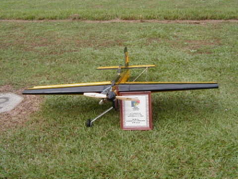

Default 1.20
1.20 4 stroke. Tried OS .91 Just not enough. Ready to fly with out engine 7.25 lbs.
