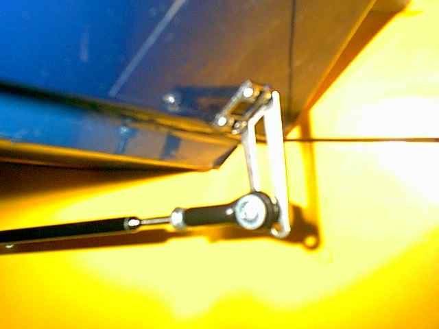

i 'am having problems with my gs 540 , the elevator flutters in knife edge attitude. the hinge's are all sealed, and i can't find any slop in the linkages the servo's are new hs 225's mg. what could be possibley be causing this ? i would apreciate any help!

Don't despair, there's something causing it. Can you post a pic of the linkage so we can see the setup?

hear are the pics , it has 2 hs 225's on the elevator. running on 6 volts= 67oz.

I'd bet money your control rod is flexing. Almost looks like 2-56 in the picture. If so, I'd go with 4-40's and ball links for connectors. Just a thought.

they are 4-40 rods, on a 80" wing fun fly, there is another guy at our club with the same plane and same set up and his doesnt flutter.
another thing is you can also see the elevator surface flutter in a hover, that is really stange to me , it doesnt do it much in a hover but you can see it from time to time.
the flying wires are an interesting thought !!!! maybe the whole surface is oscilating , how do figure out if it is ????

if i move the clevis out i will lose alot of throw, doesnt 3d well with less throw. however this may solve the problem. i really want to keep all the throw i have now because i was actually looking for some more!!!!

I understand your problem. The only other option I can give you is to replace the plastic servo arms (looks like dubro h.d. arms) and get some aluminum ones and use ball links. I wouldn't use ball links on the control surface due possibility of control arm flexing under heavy 3D loads.
Try it, it might work.
Andy

Normally it's hard to actually see the stab fluttering. It'll usually transfer it's oscillation to the weakest link..being the elevator.
Bracing is a good option, but I'd hate to see you drill holes and what not in your stab for anchors and discover it didn't help.
4-40's look small on a big bird aye ?
I would still seriously think about ball links instead of z-bends at the servo arm. It'd be an easy fix. They may feel snug but the extra precision in a ball link might just be enough to eliminate the flutter. What servos does the guy have you mentioned ?

I disagree with the full length threaded rod for push rods. That stuff is to flexible and will cause flutter. I buy the 4-40 rods that are threaded on one end. Great planes makes a solder thread for 4-40 rods. All you have to do is put your ball link on one end, measure and cut the rod off at the non-threaded end. Now scuff up the rod and I take a triangle metal file and file a couple of shallow grooves in the rod and then solder the 4-40 end onto it. I've never had one fail this way. This is much stronger than all thread and looks good. You can always make your rods from carbon fiber tubes, but not really necessary. I've got the above mentioned rods on a 36% edge 540 and have never had a problem.

For diagnostic purposes, move the clevis out to the farthest hole on the control horn. There is a possibility that the setup ie. servo arm / and servo that you are using, coupled with the inward hole on the control horn, could be the culpret. You are fine with a Z bend and a straight shot with a clevis (like you have). I know it isn't what ball link fans want to hear, but ball links can cause flutter by twisting the control horn. Many flyers only use them on throttle because of this. If you feel comfortable to fly it after the linkage adjustment, let me know and we'll go from there. If not, I suggest a larger servo. I'm almost done framing a GSE540 now.

I just looked at the photo you posted. I think Flyingdoc may be right. You definitely have the rod inboard on your control horn. I'd try putting it in the last hole outboard as Flyingdoc suggested. I doubt this servo could deal with a mechanical disadvantage like that. Just a thought.

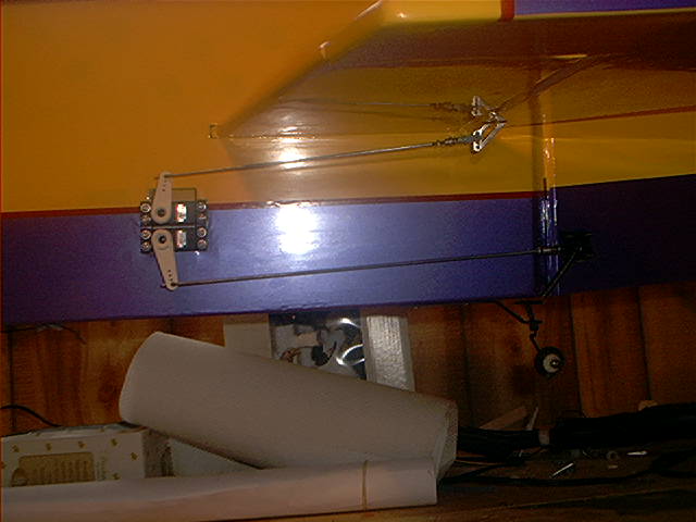

Old 12-25-2002 | 04:41 PM
Posts: 12
From: Racine, WI
Default my tail pictures as promised
Here are the pictures of my set-up that works very well. By the way what engine do you have in it? I dont think I have seen that yet. I am running the saito 180 on 30% morgans fuel. Awsome hovers and rolling herriers!!!!!
