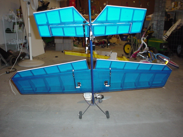

I used:
Dubro HD Control horns
Dubro Super Strength Long Servo Arms
Dubro HD Ball Links (4-40) for the servo side.
Dubro HD Clevises (with the locking pin) for the control horn side.
Homemade CF pushrods. I cut 2" pieces of 4-40 rod & JB Weld them to each end of a properly cut roud CF rod (I forget the diameter, but the 4-40 rod just slides inside it)
For the throttle, I use a dubro flex cable & just solder the ends solid & use dubro e/z connectors to attach on each end.
For the tailwheel, i use a sullivan. (the small one)
Good luck, it's an awesome 3D plane that's tough as nails. I've had some vicious cartwheel landings & lots of doinks out of a hover & it's still going strong. In fact, these pictures were taken after it had crashed 3 times that day.
