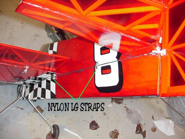

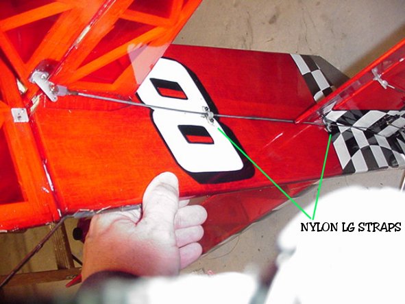

hey...its a profile...theres a chance it may not be around long......do the easy thing....go with 30" rods on the outside........try to get them and your servo arm close to the fuse with out touching the fuse.....and if you can make them run directly opposite each side thats a plus use nylon gear straps to keep them from flexing...no problemo's...
Heres a pic of my Knife right and left fuse sides...dont know if you can tell it but the rods area directly same height on both side of the fuse and then the nylon straps hold in place...
.gator

LEFT SIDE

Termagator, is that a fixed tailwheel? I can't barely taxi in a crosswind with a steerable tailwheel. (And what a beautiful airplane!)
Tom onrecess
Old 02-07-2003 | 01:37 PM
Posts: 2,776
From: MEMPHIS, TN
Default Morris Knife
thanks Tom
It is a fixed tailwheel.....alot of these profiles have hard time steering in crosswing...this one taxi's OK under normal conditions...thats the top of the plane in my avitar.......gator

Termagator, your installation of pushrods with the sight torsion/bow is the same way I do my profiles. I converted my Topcap ARF recently. It's a lot smoother than the internal pull-pull cables. I won't do the small profiles any other way after seeing how efficient and smooth they work. I guess some people may find them unattractive, but gosh, they are the ticket IMHO.
