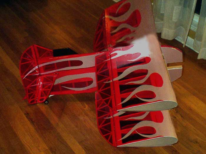

I have a thing for bipes and I have a thing for profiles. All you kit bashers and scratch builders, would this be possible and would it fly worth a hoot? Just curious to see if I should persue it....

Shorten the chord on both wings a bit (not sure how much) and I bet it would work great........John

I'd think it'd be a hoot.... You'll have to cut out some wing area... either cord or span.... remember... you'll have twice the area now....

Naaaaaaaaaaa Just a bigger engine. With enough power you can fly a brick lol.
But Let Kevin take a look and see what he thinks . I also fancy Bi planes.

I gave an enya 80 2c I could put on it. would you guys just makw 2 holes fort the wings top and bottom like it has for one?

Billy - remember that 2 wings do not = twice the lift. I believe that you loose about 40% (you'd have to research it to get exact formula) of the effective wing area due to turbulence. The wings' blunt leading edges would probably make this even worse, though is doable. If I was going to do it, I'd change my foil some, then install outboard wing supports (between the wings) and develop some cabanes. The problem would be weight / wing loading / CG, though like I said, doable.

How about sliding the bottom one a bit backwards
and moving the top one a bit forward, you get better
lift , and definitely you need more power, dead sticks
is a falling rock I guess!!!

Staggering the wing does help eliminate some to the ineffectiveness of a bipe's lift, though little. Realize that there are so many other factors that have to be considered that it is almost impossible to clearly identify its potential flight characteristics via just a rendering. Its a heck of allot easier to do it in the computer graphics , though I too love bipes! I just don't believe that bipes should be a Fun Fly (IMO)

ok, maybe not a good idea. i trust it to you designers. just a thought.

Maybe a
TopCap wing foil would work.
