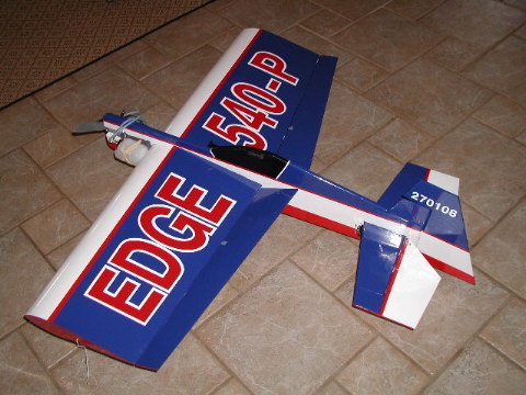

I managed to get the servos with regular extensions through the channel as shown on the plans. It was a pain, but it probably took less than 30 min. The connections DO need to be secured (I use GoreTex fishing line), but I do that on all connections. It is cheap, easy, and has saved me at least one plane.
Mine balanced easily with a TT .46. If you are looking for an inexpensive engine, than this is clearly the only choice. It provides enough power to pull out of a hover with modest authority, and costs about $75 at Tower. If you want more power, then the sky is the limit - try a YS .63 at three times that price.
Lastly, I have to say that the OMP Edge that started this thread is probably the ugliest plane I have ever seen. No offense intended, but it is really not my cup of tea.
Leonard
PS Here is my edge - you may feel the same about it.

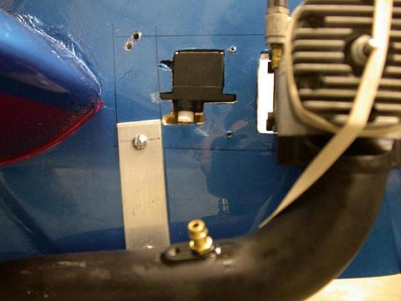

You should be able to mount the servo (HS-81) on the fuse behind the engine. You have to do some planning ahead of time and make a channel that goes through the wing. Cut and opening in one side (the engine side) and nestle the servo there.
This is a GWS NARO BB a little smaller than an HS-81 but they should work the same way. I love this setup and have had no problems with it.
