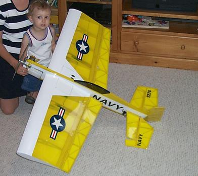

Old 07-24-2003 | 12:28 PM
Posts: 246
From: London, ON,
Default OMP FF540P engine?
I run a GMS47 w/tuned muffler on mine with a 12x4 and its ballistic to say the least. Pretty sure any 40 would be great and up to 47 if you want lots of extra power.
