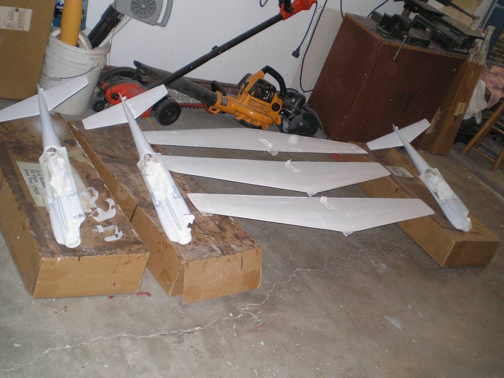

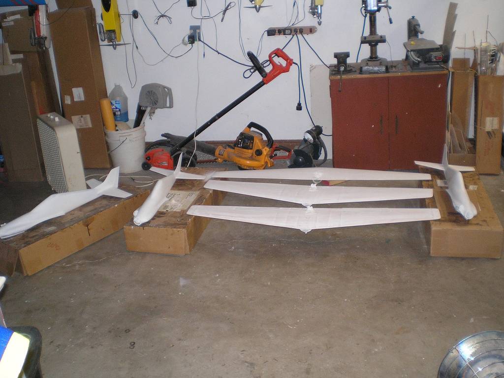

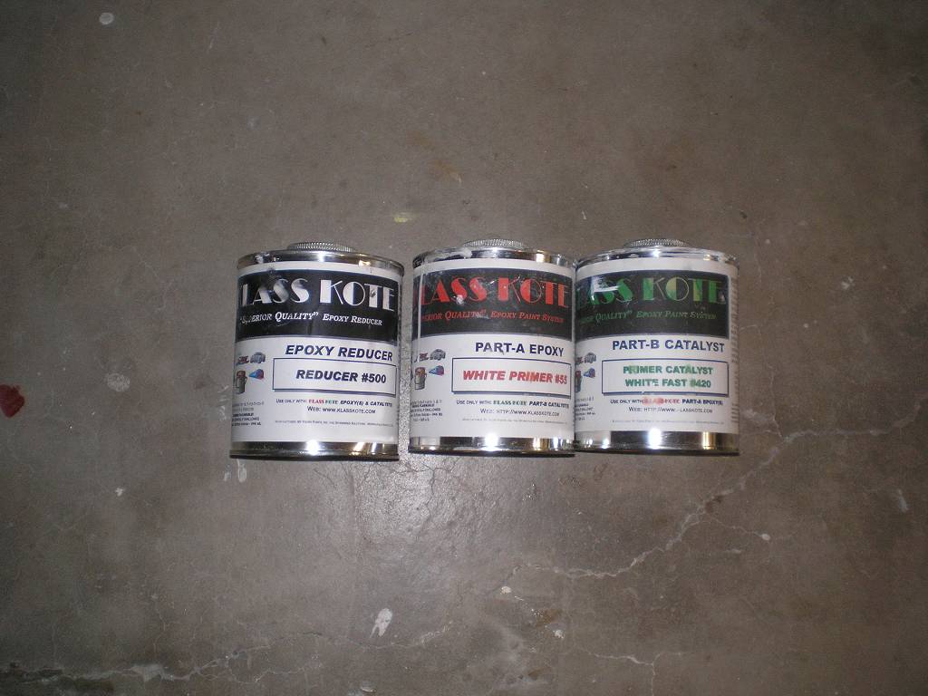

I used KlassKote white epoxy primer on the model.
Part A and B primer were mixed and allowed to set about 30 minutes.
Epoxy reducer was added until the mix was 1 part A, 1 part B, and 1 part reducer.
An inexpensive spray gun from Harbor Freight was used to apply the paint. Use a respirator when spraying epoxy type paints. The spray gun was about $15 and the respirator was about $25.

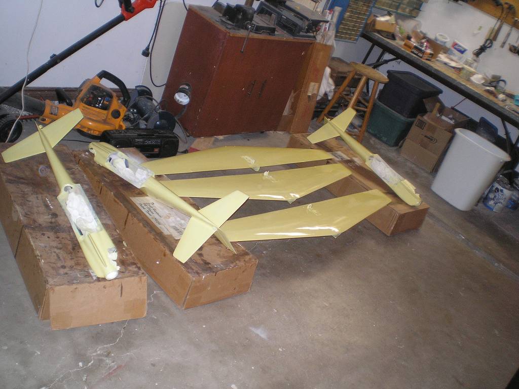

The primer was wet sanded as needed until it was smooth. It was then allowed to dry before going to the next step.
I mixed some Acrylic Enamel car paint per the directions and sprayed it on the model.
The Acrylic Enamel has hardener and is fuel proof.
The yellow didn't quite cover so it will be wet sanded and a second coat will be applied.

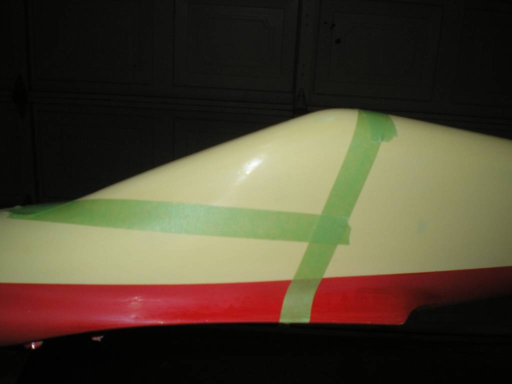

The model was masked for trim and it was painted today. The paint type was Acrylic Enamel car paint.
Next will be more wet sanding and then painting the canopy.

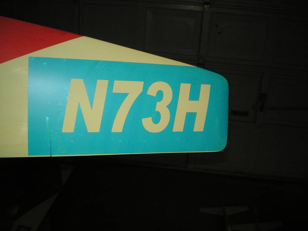

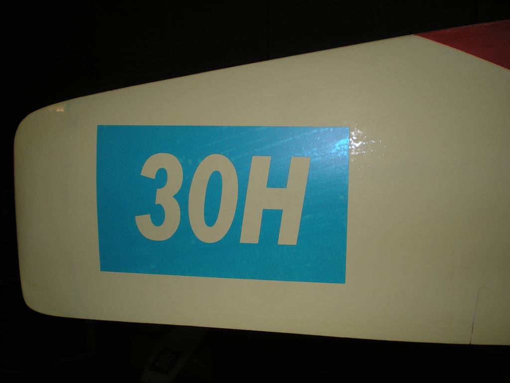

My models will have numbers and a painted canopy.
The stencils were made at the vinyl shop. They are available for reasonable prices.
The rest of the model will be masked off with paper prior to painting.

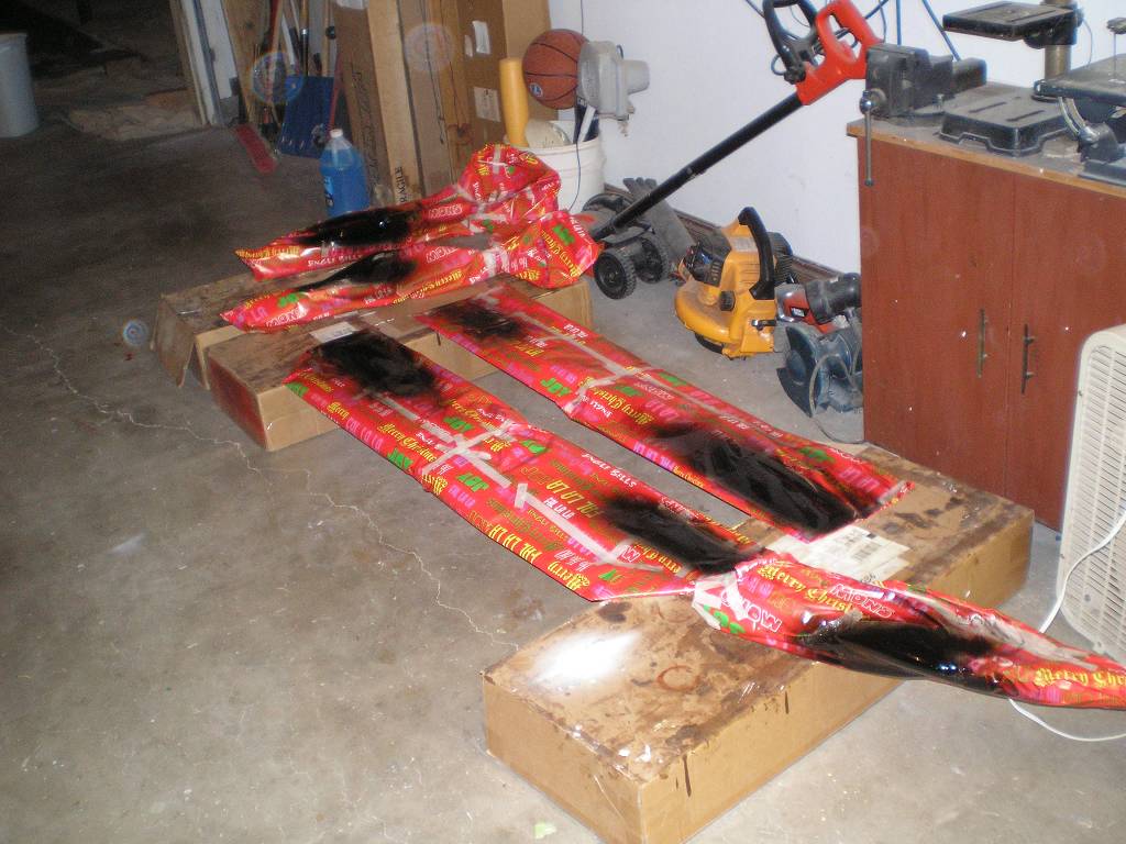

I sprayed on the black trim tonight.

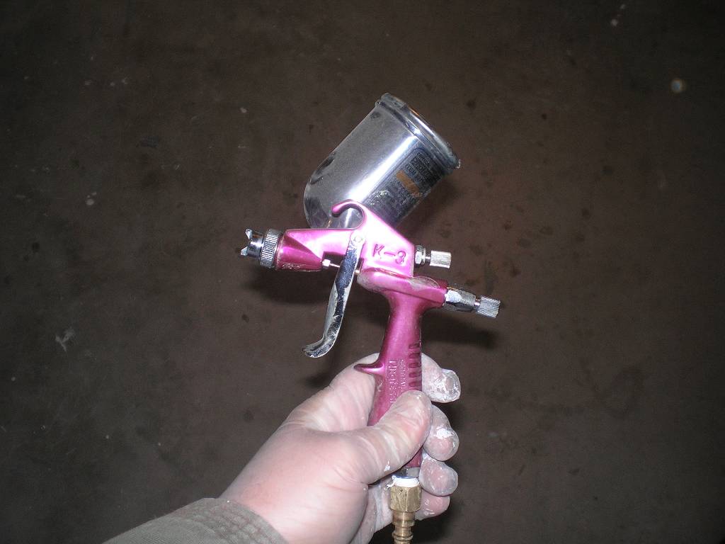

An air brush from Harbor Freight was tried out. This one has 5 small bottles that are easily removed for applying another color.
I just mix a small amount of trim color and sprayed on with the air brush. The bottles don't look like they will last very long with thinner so I just throw them away after I'm done.

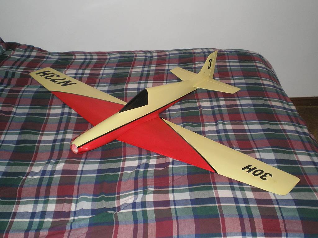

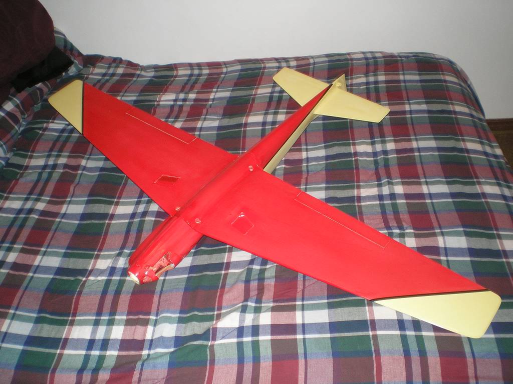

Some final wet sanding was done and the finish was touched up as needed.
High quality black pin stripe was applied to accent the red and yellow colors,
Here are a couple pictures before the clear coat is applied. Yea, I know its the same paint job as before. [8D]

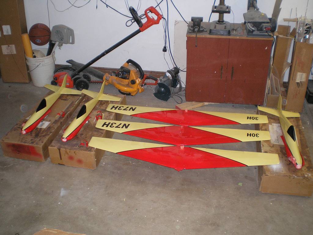

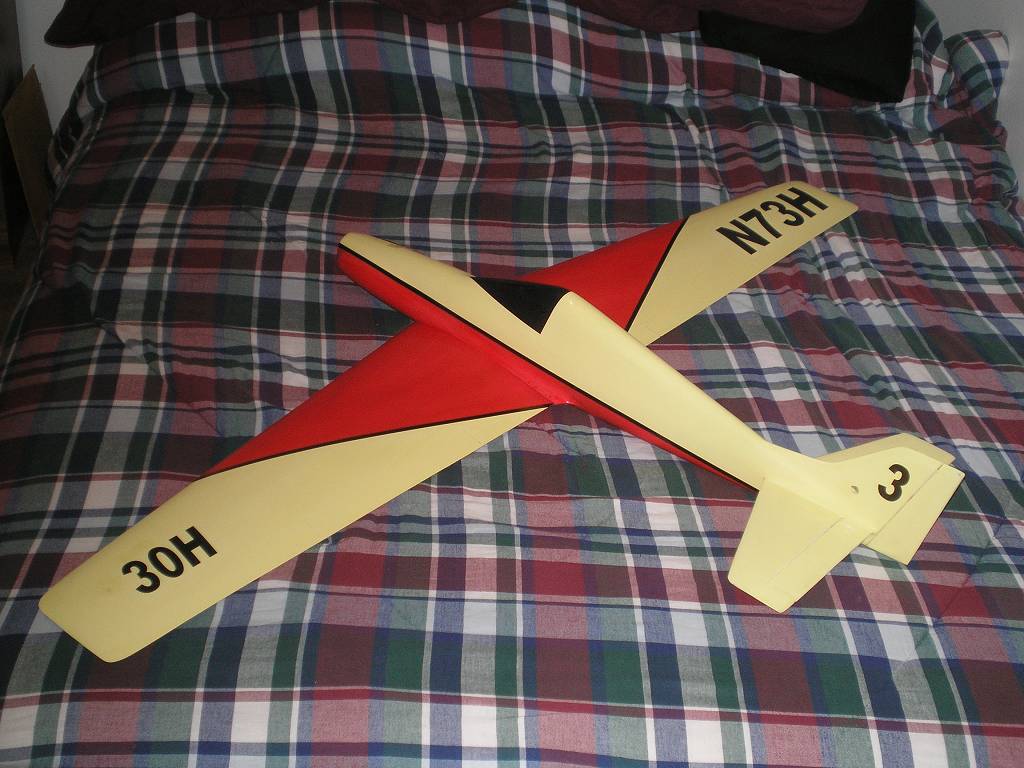

The clear coat went on tonight.
I used the fast hardener to increase the drying speed and reduce the potential for picking up dust.
The pin stripes are a high quality vinyl pin stripe available from most auto parts stores.
Next will be wet sanding with 2000 grit sandpaper and then buffing out. My paint shop is my garage and it takes wet sanding and buffing to get a good finish!
The model without numbers will probably be the official loaner.

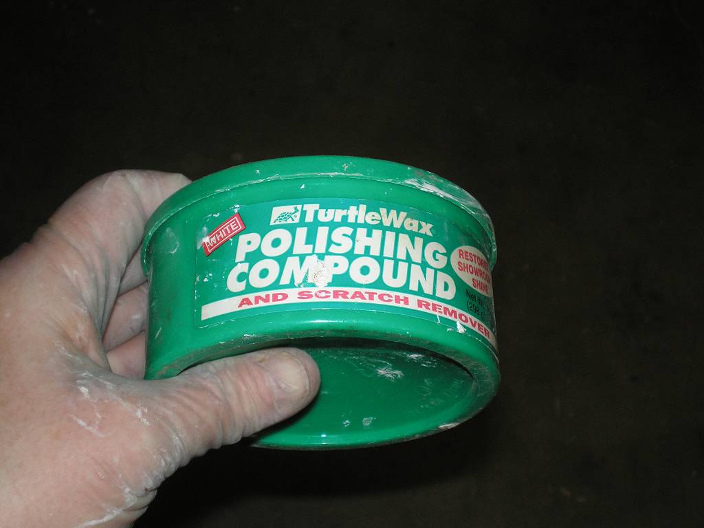

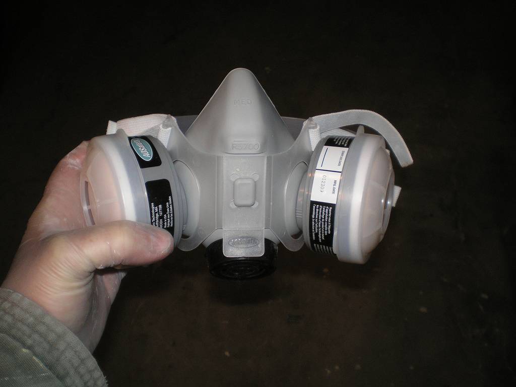

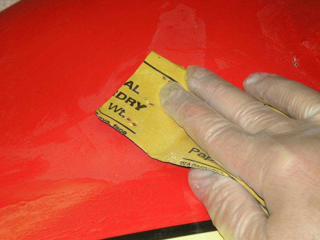

Concerning health effects:
I use a respirator when painting with KlassKote and when using automotive paints. Both are known for health effects so use a respirator. I got mine at Harbor Freight for about $25.
Wet sanding with 2000 grit sand paper doesn't take off much paint. I use it primarily to knock off the dust.
After the wet sanding I will use some white compound and a small buffer. This step gives the depth that you see in a car finish.

You have to be careful using the 2000 grit.. if you get dirt stuck in the backing, the backside can actually be more abrasive than the front! 2000 grit is pretty darned fine sandpaper.

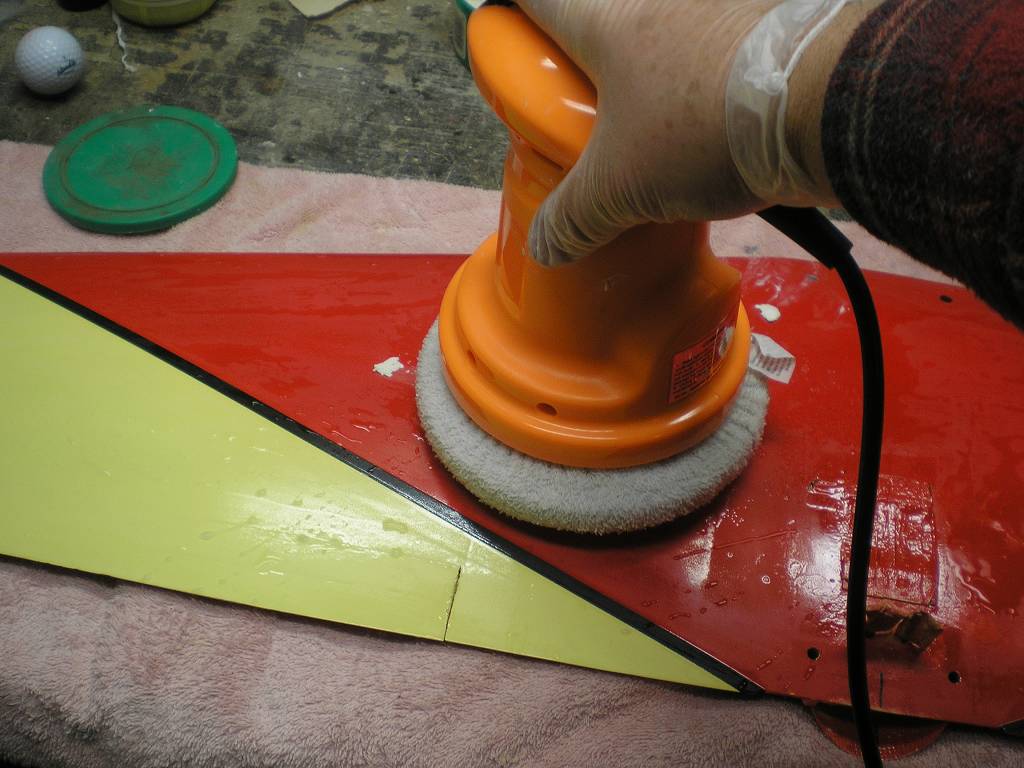

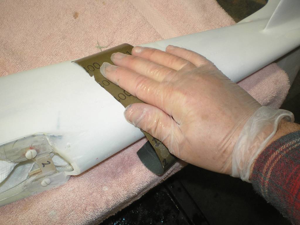

Here are a few photos showing wet sanding and buffing.
Some 2000 grit wet and dry sandpaper was used. This is primarily to remove the dust on the surface.
After the model is wet sanded then buff it out with some white polishing compound and 6" electric buffer.
This leaves the finish a uniform satin. I usually stop here as the satin finish hides minor imperfections.
If you want the highly polished look then continue the polishing with a liquid car polish.

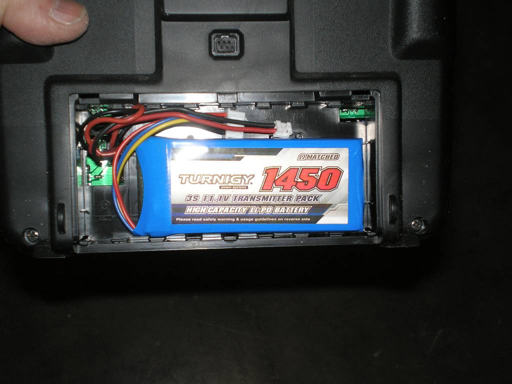

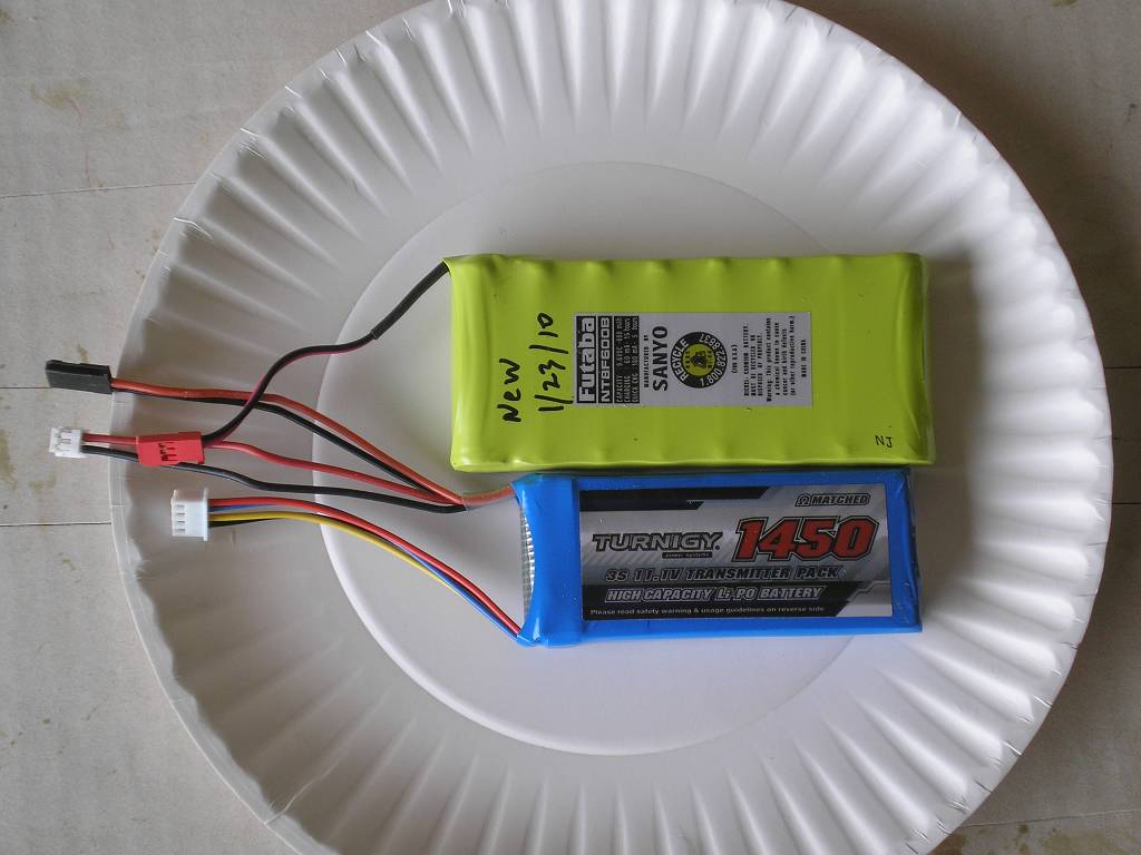

I put a 1450 ma lipo in my transmitter.
The rated current draw is 170 maH so the pack should last around 8 hours per charge.

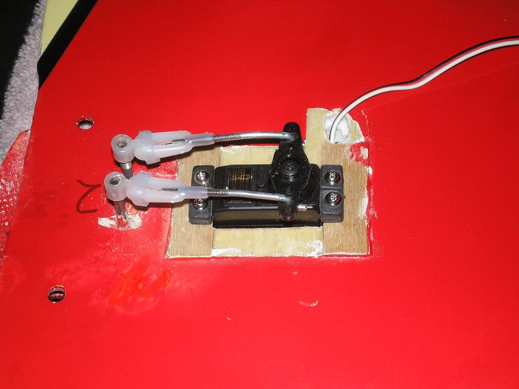

The aileron servo was mounted using the provided hardware.
At low rate the throw is about 1/8" to 3/16" each way.
At high rates the throw is about 5/16" each way.
