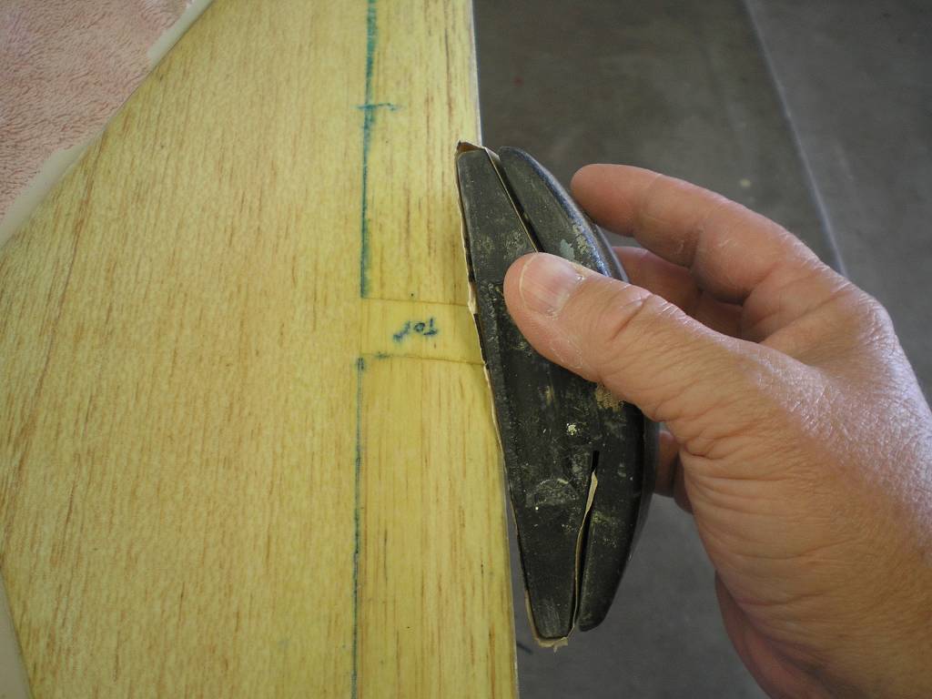

Old 08-08-2009 | 04:33 PM
  #77
Joined: Nov 2007
Posts: 2,060
From: Fritch, TX
Default RE: Proud Bird Construction Thread
Trim the excess fiberglass from the wing tips with a sanding block.

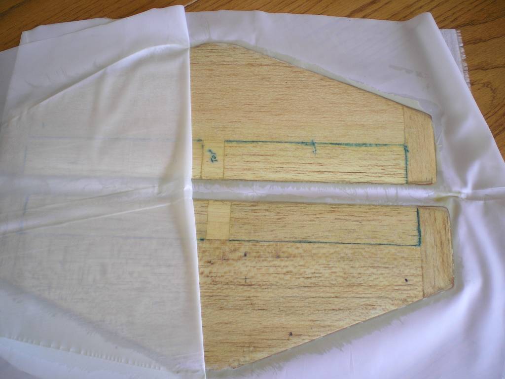

Old 08-08-2009 | 04:36 PM
  #78
Joined: Nov 2007
Posts: 2,060
From: Fritch, TX

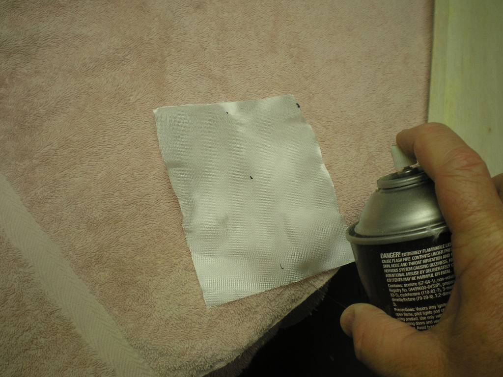

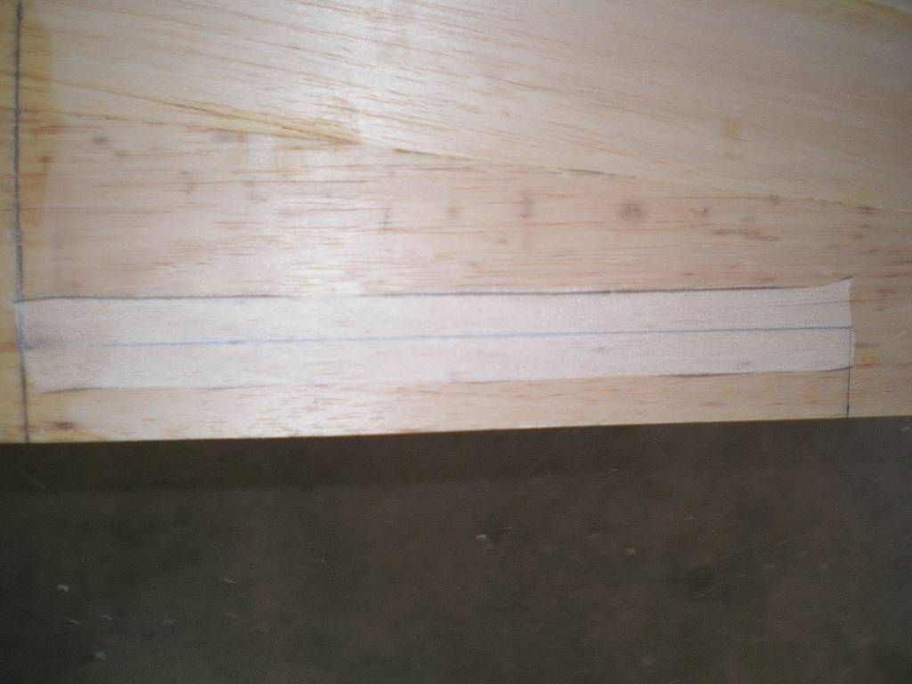

Here's another method how to make a gapless hinge. Kevin Matney told me how.
Cut a piece of taffeta (nylon fabric available from Michaels or wedding shop) about 1.25" wide.
Tack it on with some 3M 77 contact glue.
ID:	1252389   Click image for larger version
ID:	1252390   Click image for larger version

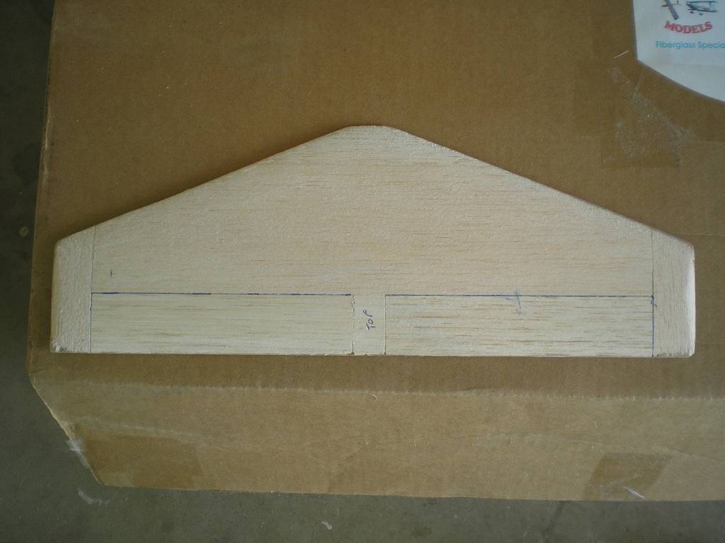

Old 08-08-2009 | 04:39 PM
  #79
Joined: Nov 2007
Posts: 2,060
From: Fritch, TX
Tack on the 3/4 ounce fiberglass to the wood with 3M 77.
Mix up some Skin It epoxy glue and apply it with a plastic squeegee.
Put the parts between layers of peel ply (polyester fabric).
ID:	1252392   Click image for larger version
Old 08-08-2009 | 04:42 PM
  #80
Joined: Nov 2007
Posts: 2,060
From: Fritch, TX
Put the peel ply and parts in a vacuum bag. I used 4 mil plastic and sealed it with latex caulking.
Turn on your vacuum pump (6" of HG vacuum) and allow the air to be removed.
Leave the parts alone and let dry overnight.
ID:	1252394   Click image for larger version

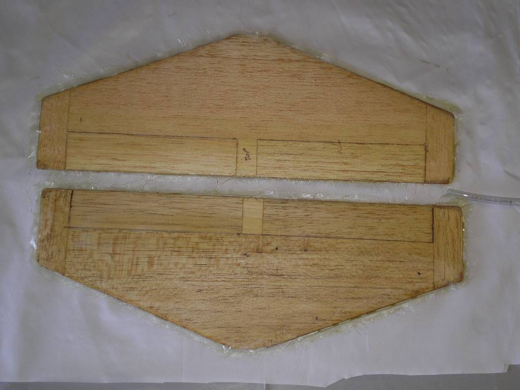

Old 08-09-2009 | 12:33 PM
  #81
Joined: Nov 2007
Posts: 2,060
From: Fritch, TX

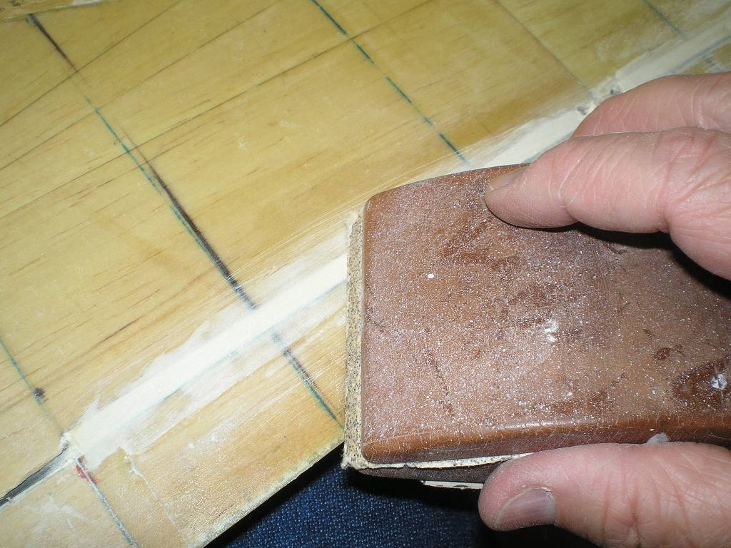

The next morning you can open the bag and remove the tail surface from the peel ply.
Just pull the sheets apart to remove the parts.

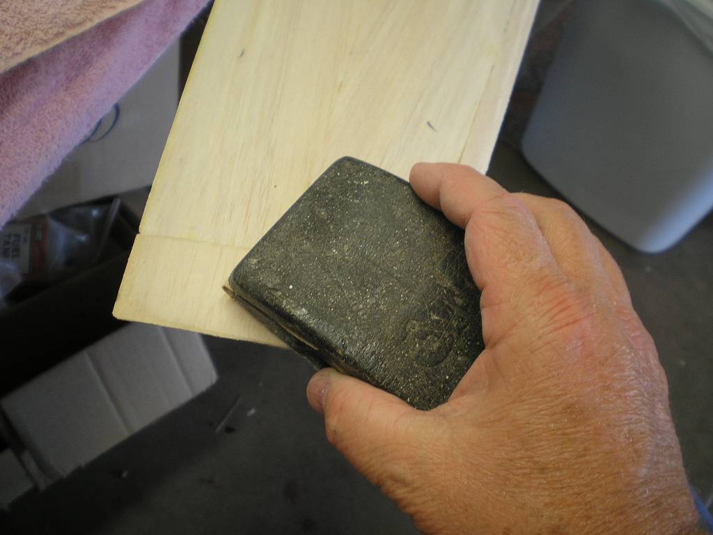

Use a sanding block to trim the edges.

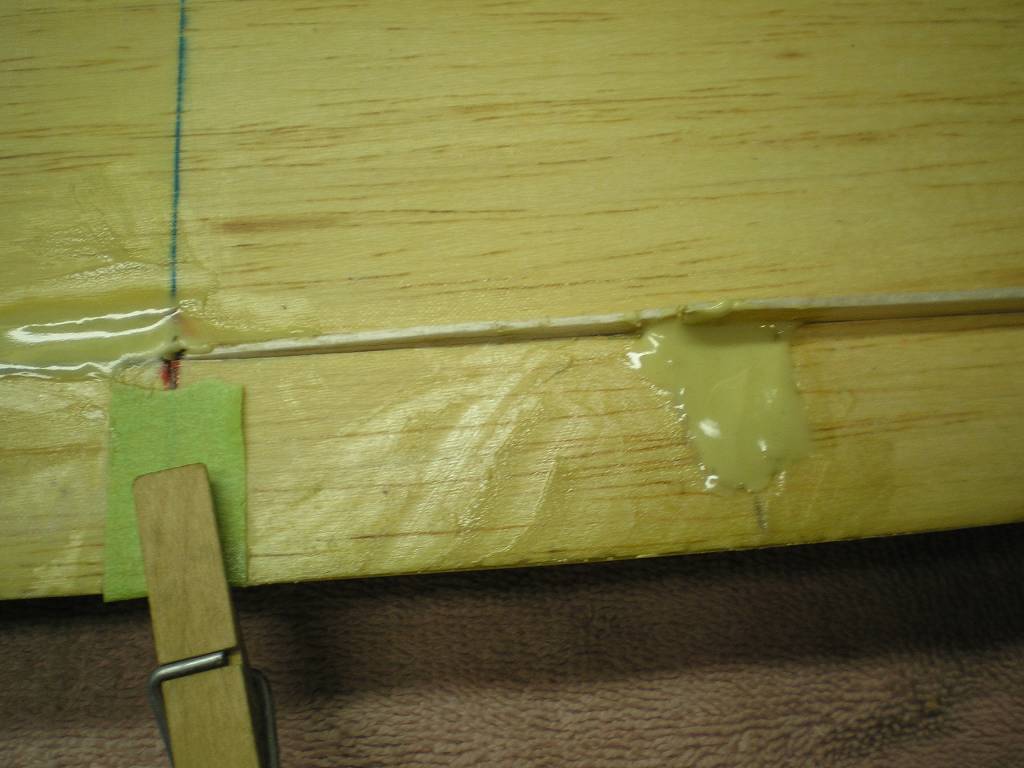

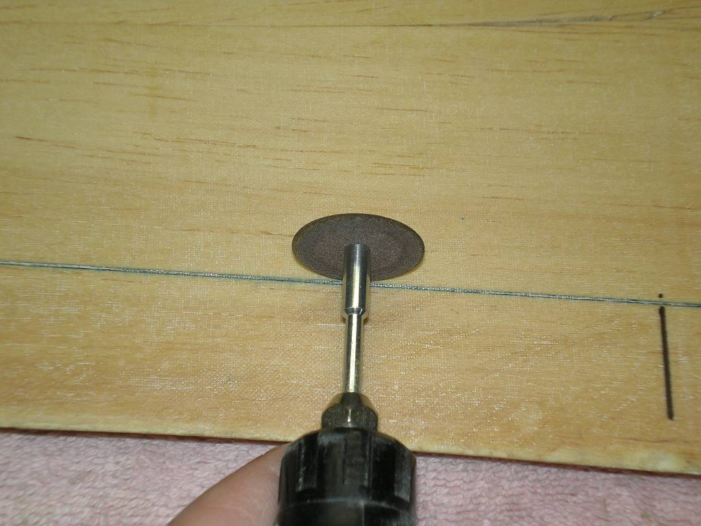

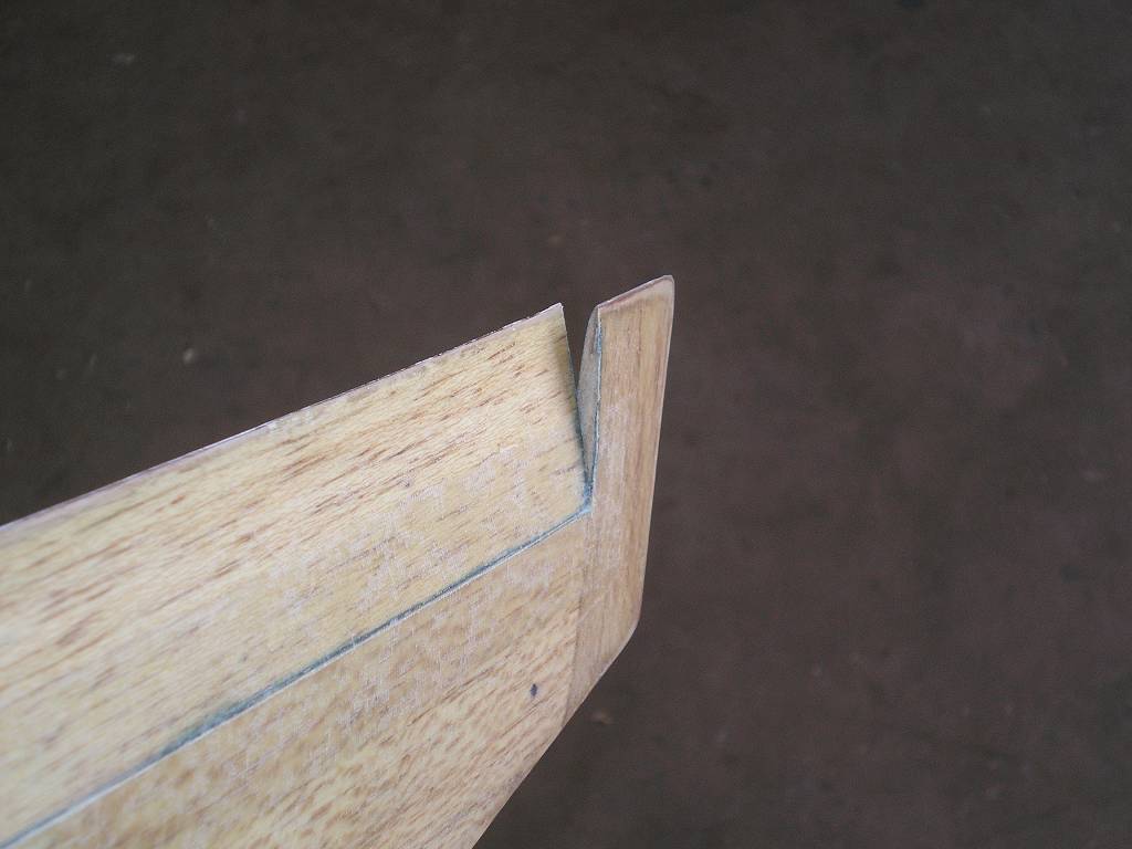

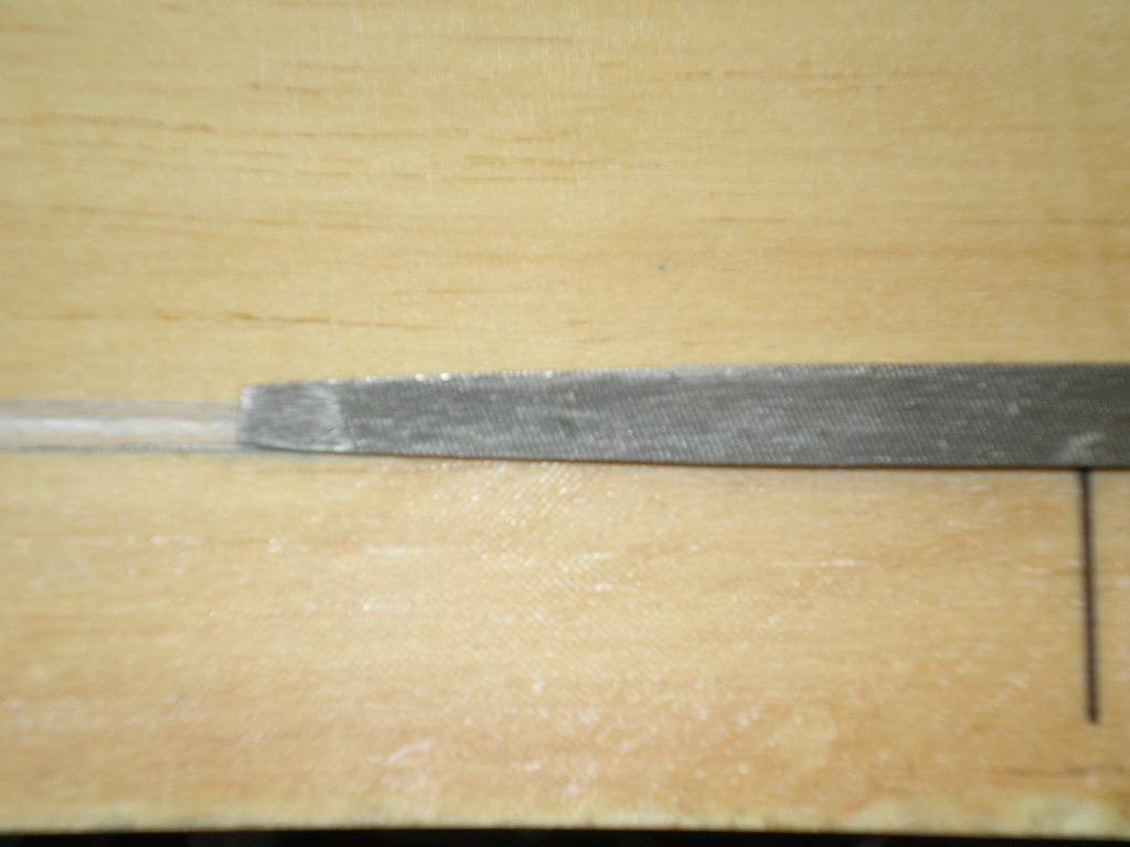

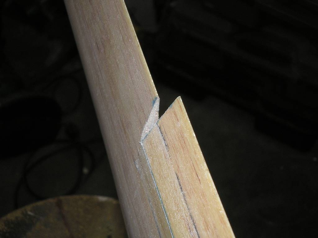

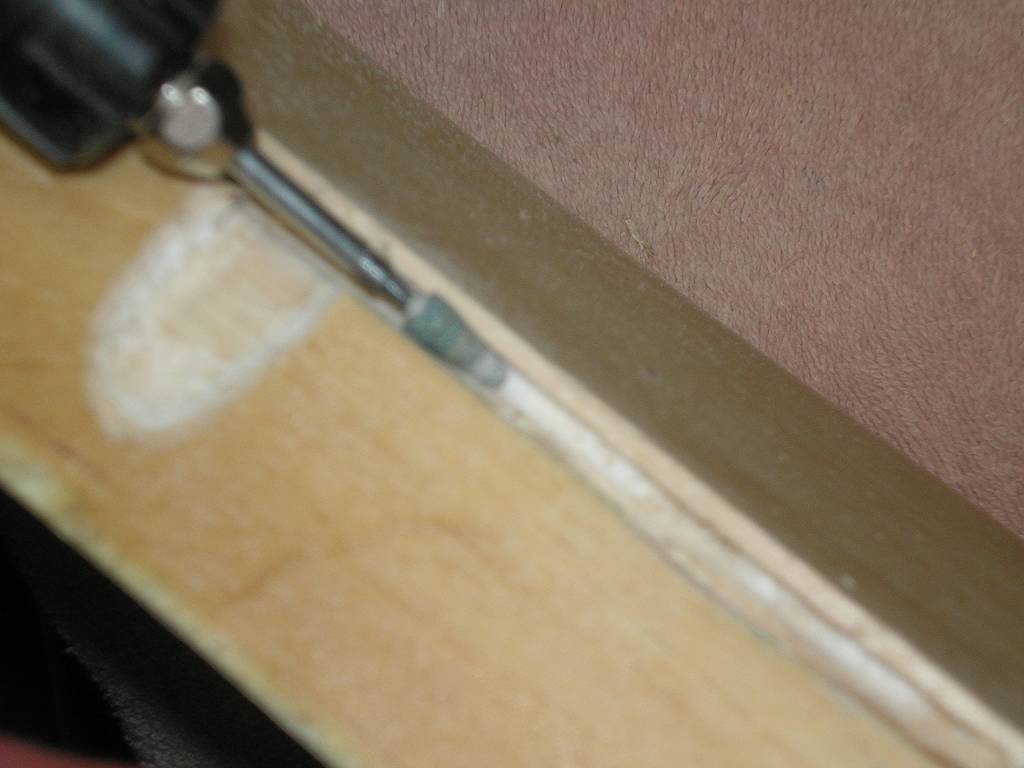

Use a Dremel tool and cut off disk to cut a slot on the bottom at the hinge line.
A razor saw is used to cut the hinged surface free.
Use a small file to widen the slot enough to allow about 5/16" down elevator.

You're using a triangle file, right?
Old 08-09-2009 | 06:20 PM
  #84
Joined: Nov 2007
Posts: 2,060
From: Fritch, TX
A triangle file was used but you can also fold the surface back and use sandpaper or a flat file.
Just be careful not to sand through the hinge.

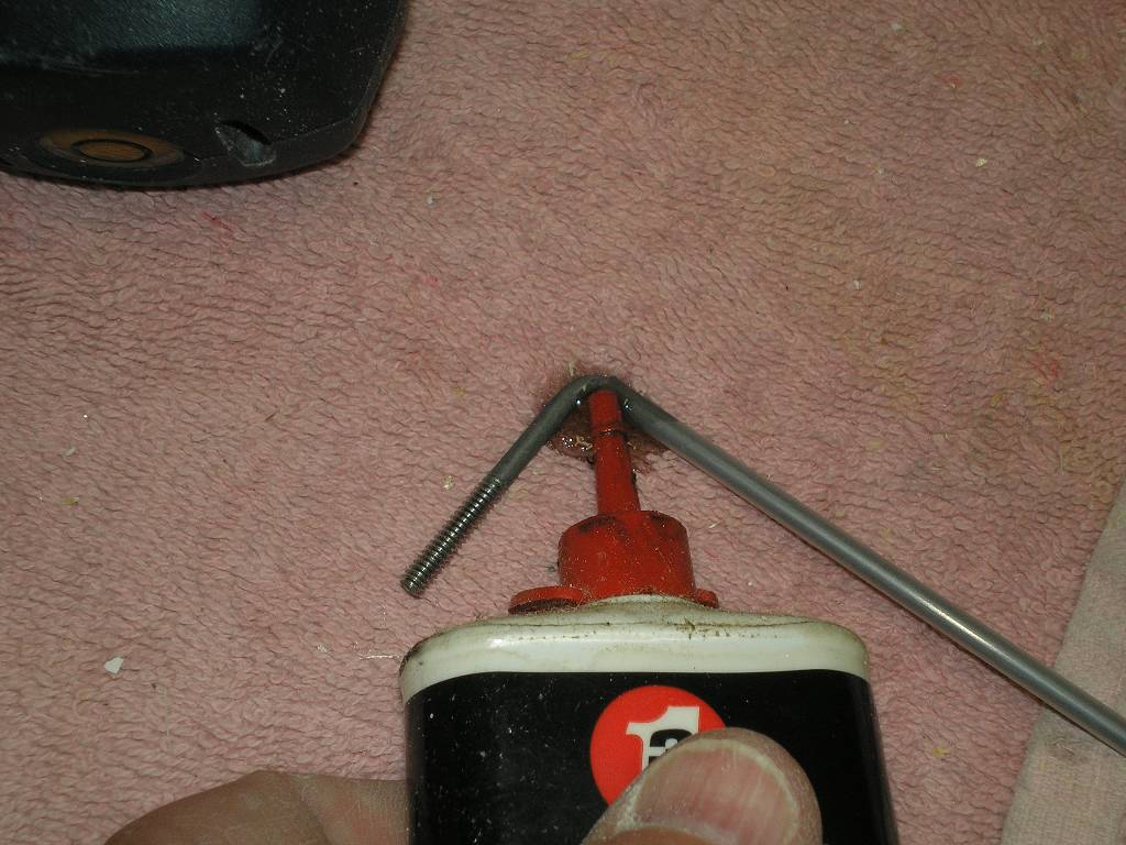

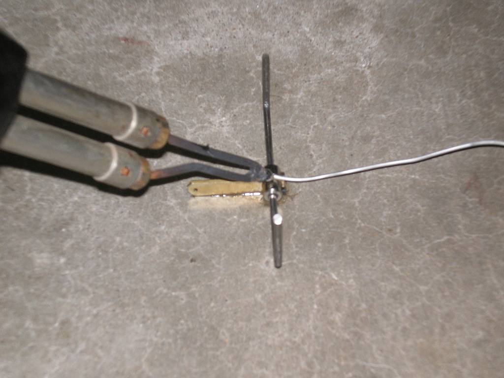

The elevator horn was made out of a piece of 3/32" wire, 3/32" wheel collars, and a piece of sheet brass.
Solder the parts together with silver solder.

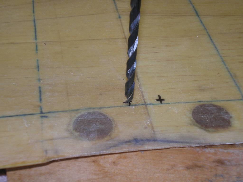

Align and tape the wing to the fuselage.
Drill some test holes to confirm you have the correct location for the dowel pieces.
If the holes are off a little adjust the location and try again.

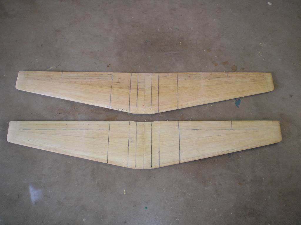

Old 08-11-2009 | 11:39 PM
  #88
Joined: Nov 2007
Posts: 2,060
From: Fritch, TX

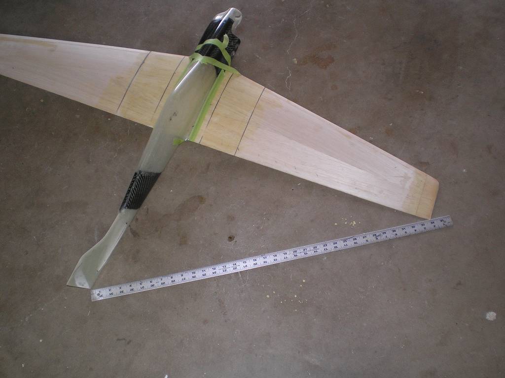

I vacuum bagged the wings similar to that done on the tail. This method was explained to me by Ed Smith and Kevin Matney.
One wing uses a piece of 2 ounce fiberglass cloth as a hinge. The other uses taffeta as the hinge.
Lightweight 3/4 ounce fiberglass cloth goes over the entire wing.
Skin It epoxy was applied and spread with a squeegee.
The wings were places between pieces of polyester cloth (peel ply) and then placed in the vacuum bag.
The pump was turned on and parts were let to dry overnight.

I actually applied the fiberglass cloth on the bottom of the wing in addition to the top. Sorry I don't think there were pictures.
1) There were three layers of fiberglasss cloth applied to the center section. This time widths of 4", 10", and 14" were tacked on with 3M 77.
2) The aileron hinge (2 ounce glass or taffeta) was also tacked on with 3M 77.
3) Lightweight 3/4 ounce cloth was appled to both the top and bottom of the wing.
4) About 1.5 ounces of Skin It was applied on the bottom of the wing. It was spread with a squeegee.
5) About 1.25 ounces of Skin It was applied on the top of the wing. It was spread with a squeegee.
These were then placed in the peel ply and vacuum bag to dry.
The torque rods will be installed later.

Old 08-12-2009 | 08:11 PM
  #93
Joined: Nov 2007
Posts: 2,060
From: Fritch, TX
The finish is smooth but it is not perfect.
You get a smoother finish using the peel ply in the bag than if you just applied the finishing epoxy with a squeegee alone.
The surface is only as smooth as the peel ply and bag. I ironed the peel ply so there were no wrinkles.
The following picture shows what the wing looks like after some sanding.
The hinge made of 2 ounce glass is smoother than the one done with taffeta. We will see what holds up better.

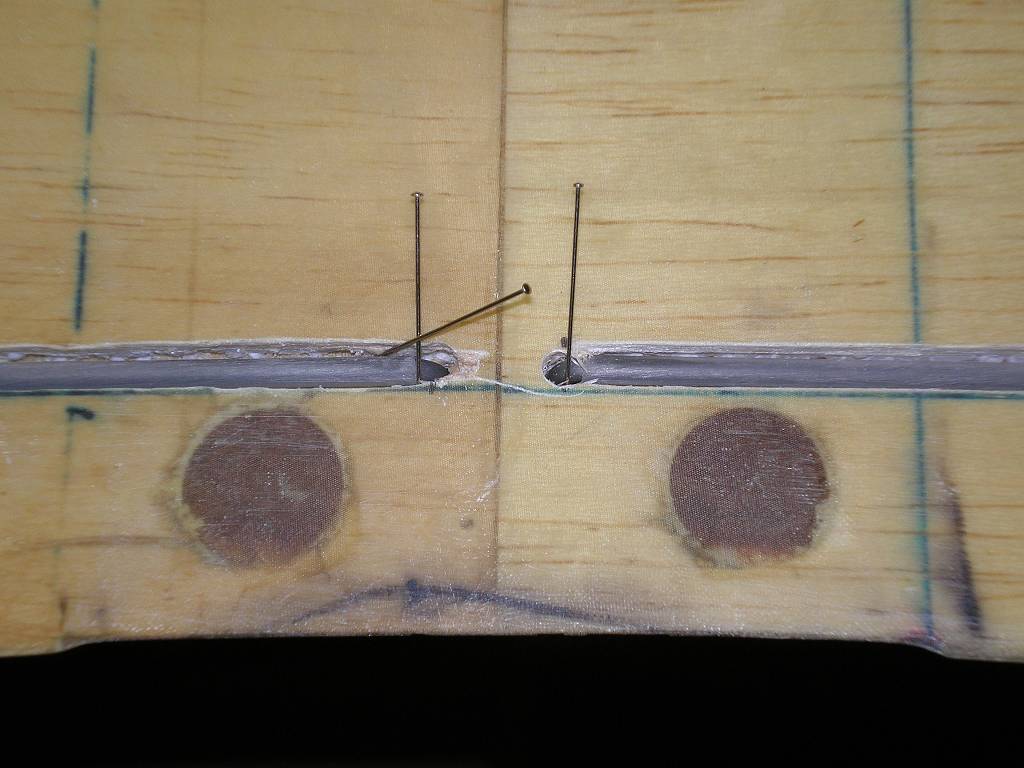

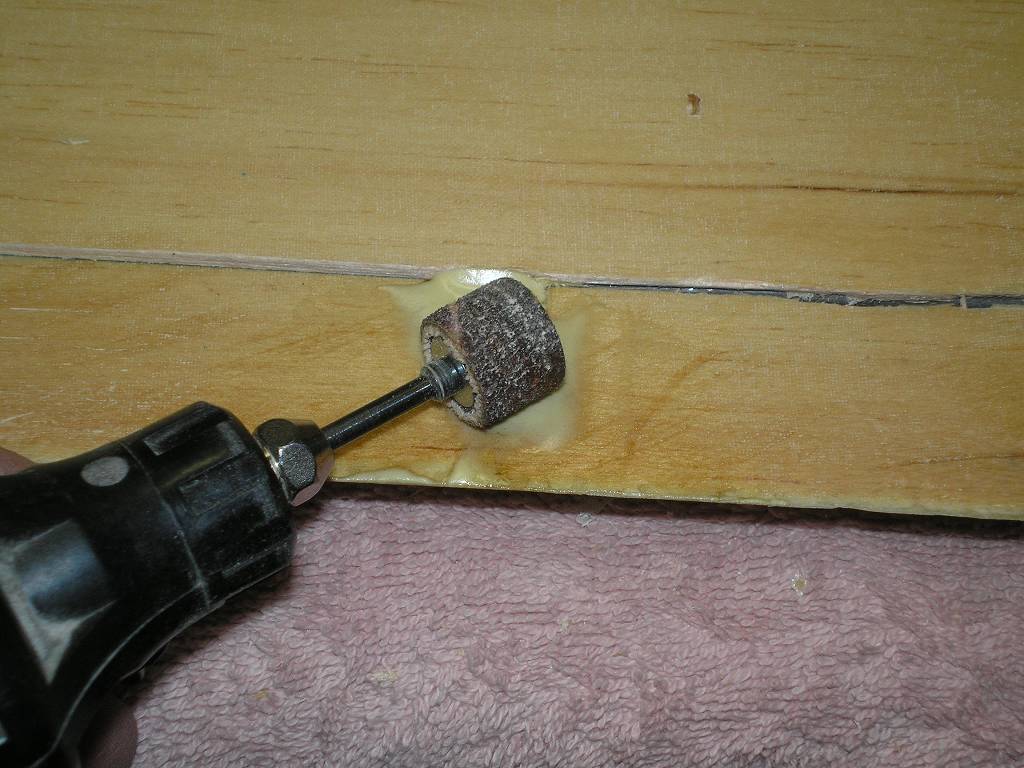

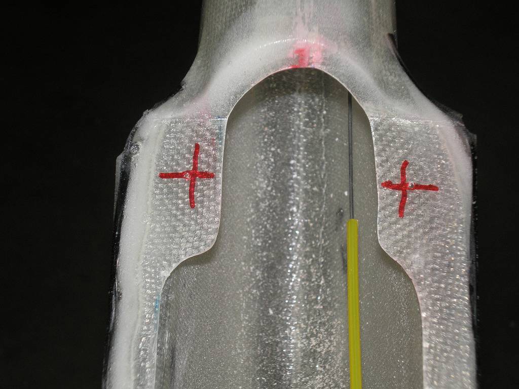

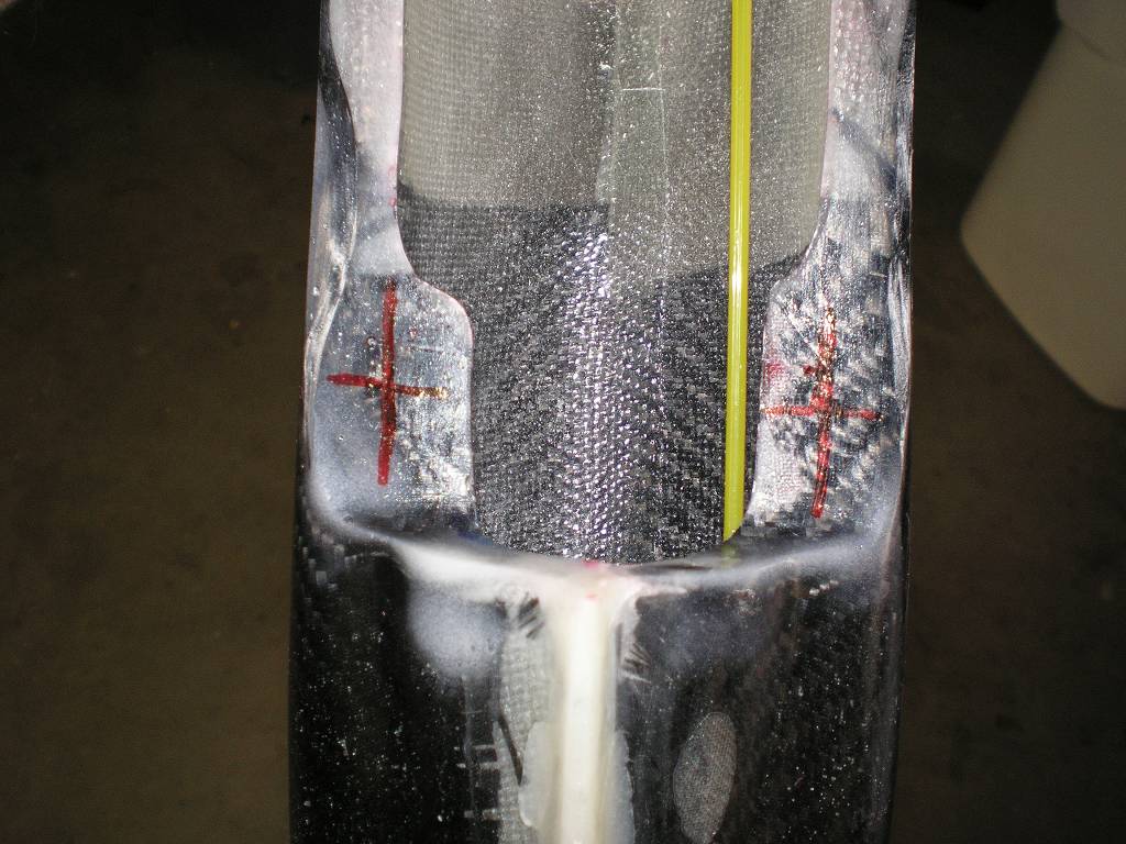

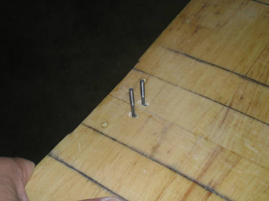

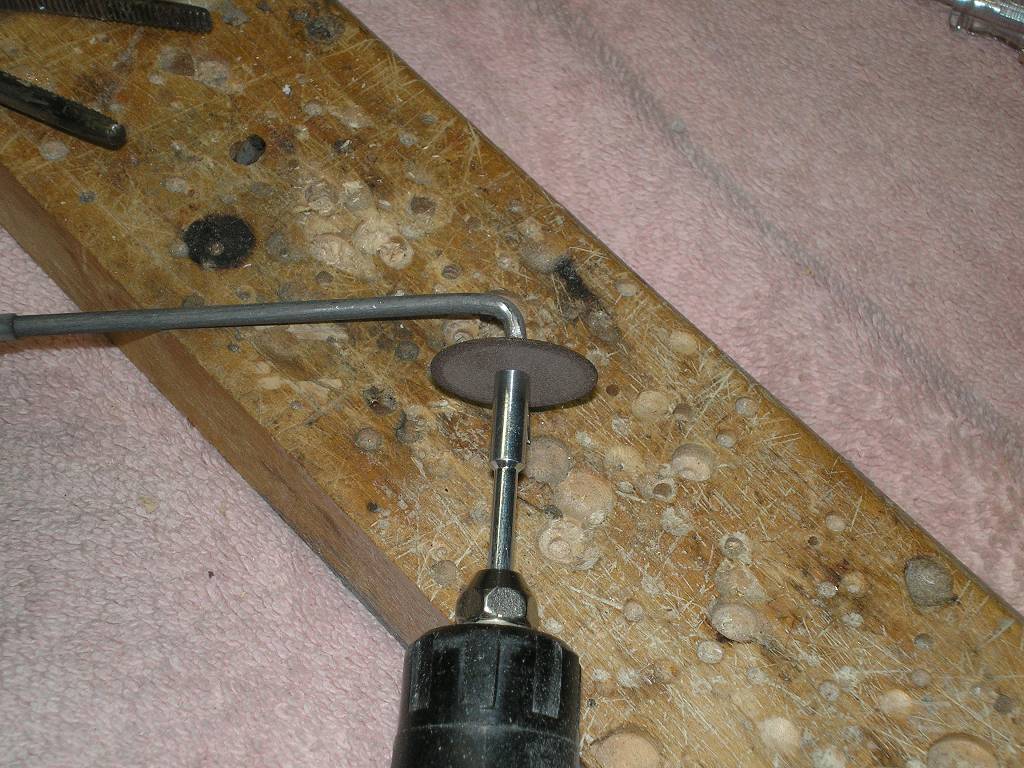

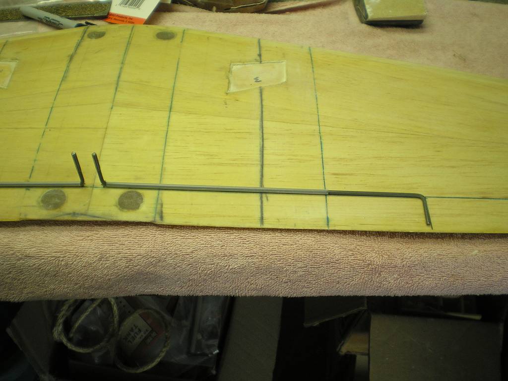

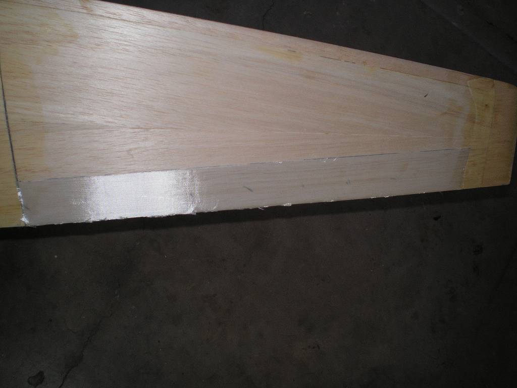

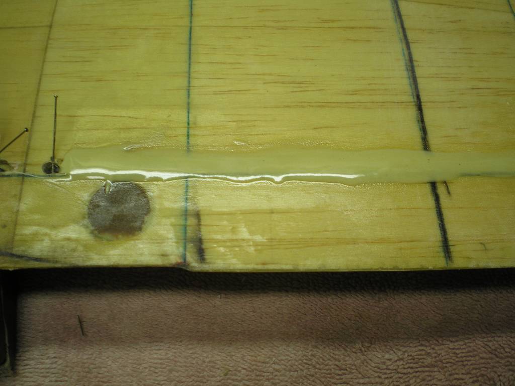

The following pictures show how ailerons were installed based upon the taffeta hinge.
Heavy duty aileron rods are used.
Drill 3/16" holes to route the rods to the other side.
Use a Dremel tool with cut off disk to cut a slot for the ailerons.
Use a file or sanding block to widen the slot to about 3/32".
Use a razor saw to free up the ends and adjust the slot to allow about 5/16" throw each way.
ID:	1255690   Click image for larger version
ID:	1255691   Click image for larger version
ID:	1255692   Click image for larger version
ID:	1255693   Click image for larger version
ID:	1255694   Click image for larger version

Cut the slot for the torque rod as needed.
A hobby knife was used in the center section.
A small Dremel tool was used behind the ailerons.
A small amount of oil was applied to the torque rods.
The ends were tapered as needed to fit.
ID:	1255697   Click image for larger version
ID:	1255698   Click image for larger version
ID:	1255699   Click image for larger version
ID:	1255700   Click image for larger version

Scrap pieces of balsa were used to block off the hinge line from glue.
Some Skin It epoxy and micro-balloons were mixed for a relatively thick mix.
The mixture was applied to cover the aileron torque rods. These will have to be overfilled a little as the glue settles as it dries.

I used a Dremel tool to grind the epoxy and micro-balloon almost flush with the surface.
A sanding block was used to finish the sanding.
ID:	1256202   Click image for larger version
ID:	1256203   Click image for larger version
