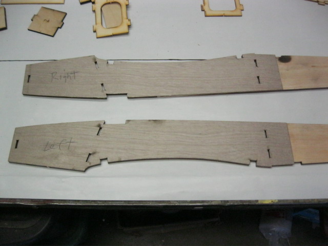

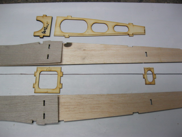

The photos show approximately the layout of the formers and landing gear blocks
ID:	1740201   Click image for larger version
ID:	1740202   Click image for larger version

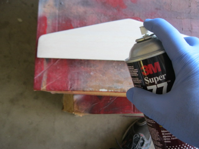

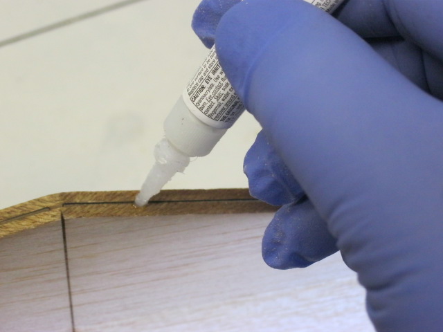

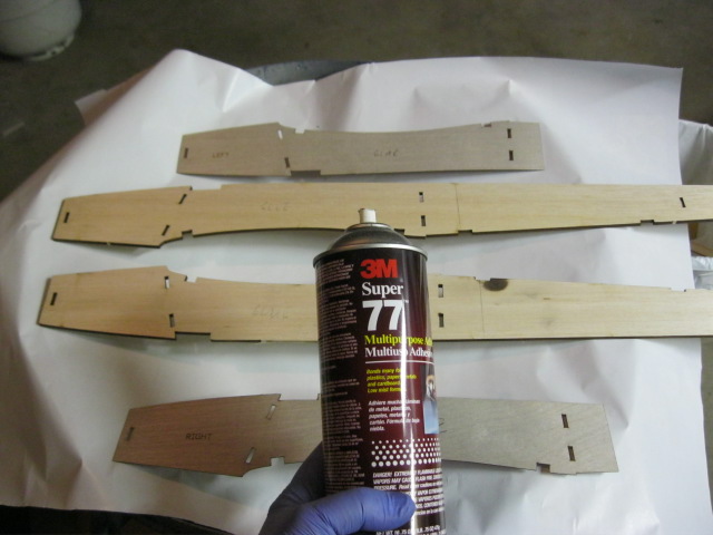

I used 3M77 spray contact adhesive to glue on the doublers.
Both surfaces were sprayed. Wait about a minute and join the surfaces.
These stick immediately so insure you place them in the proper areas.
ID:	1740204   Click image for larger version

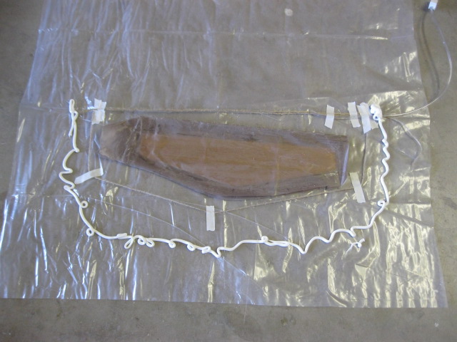

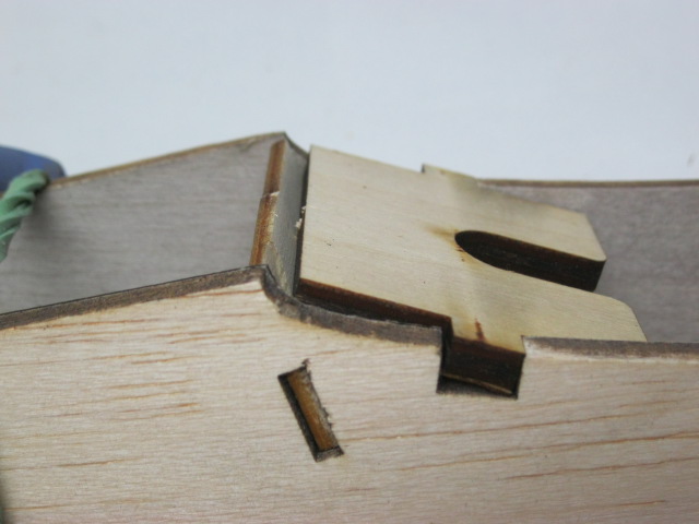

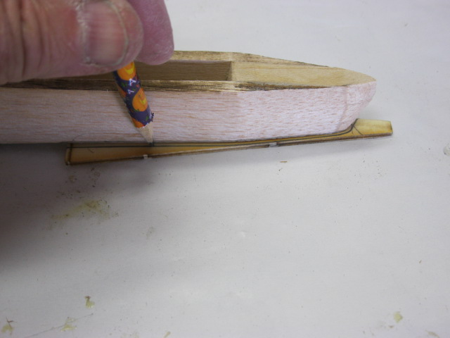

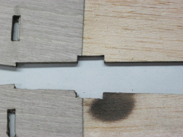

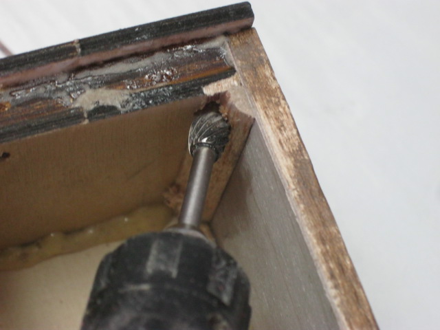

There were a few areas where parts did not quite fit. Take a couple minutes to fit parts, using a knife and sanding block, before going to the next step.
ID:	1740206   Click image for larger version
ID:	1740207   Click image for larger version
ID:	1740208   Click image for larger version

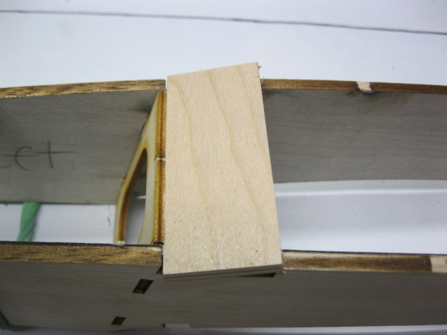

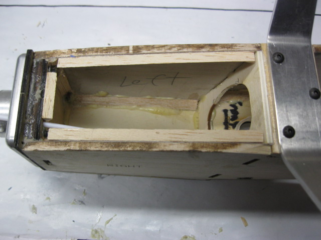

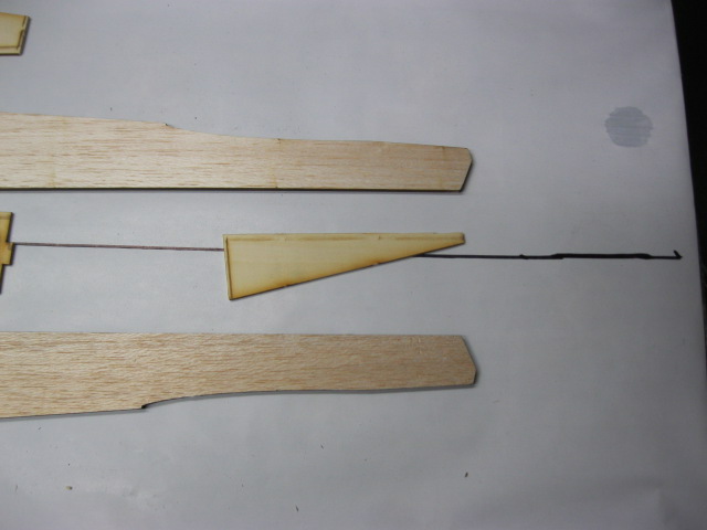

My model will have internal pushrods.
A 3/8" thick piece of balsa wood was glued in place at the tail to provide room for the pushrods.

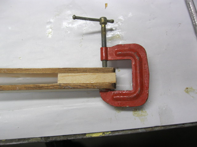

Old 03-18-2012 | 11:21 AM
  #31
Joined: Nov 2007
Posts: 2,060
From: Fritch, TX
Default RE: Intimidator II Construction Thread

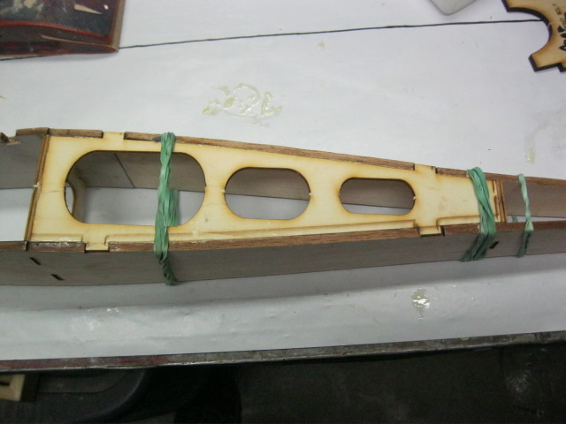

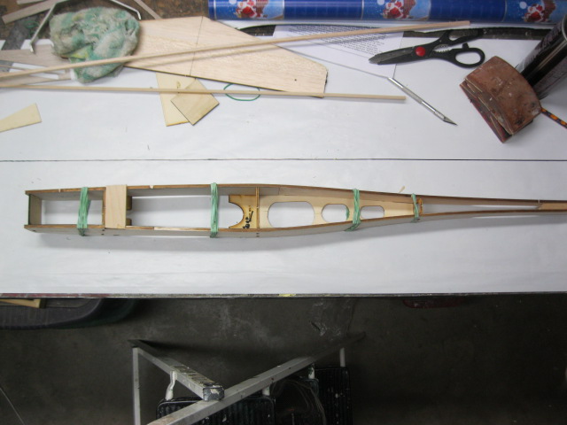

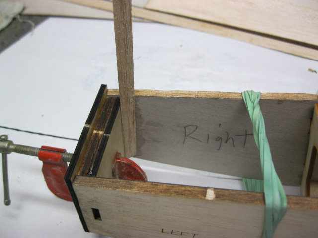

The formers were test fit on the fuselage.
After parts were confirmed to fit, they were glued in place using Gorilla Glue. When using that type of glue the surfaces are lightly dampened prior to gluing.
Rubber bands and "C" Clamps holds parts in place until the glue dries.

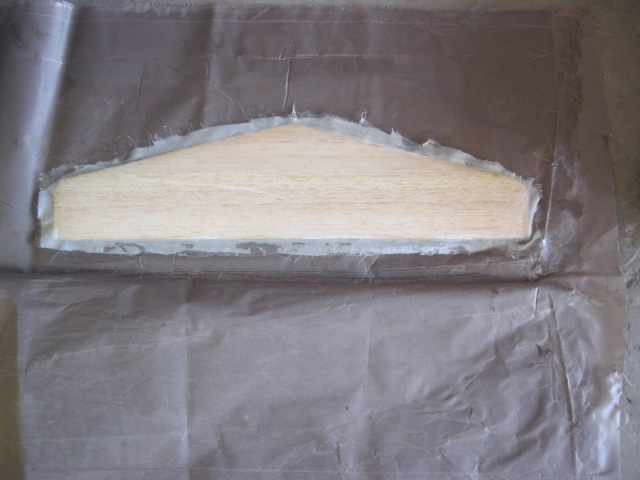

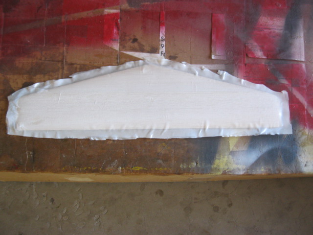

A piece of light ply was fitted and then glued to the bottom of the tail surface.

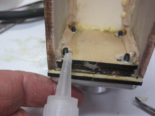

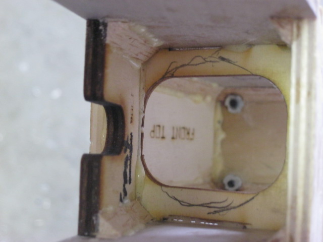

Tape the motor mount on the firewall and install blind nuts.
Dubro blind nuts are recommended as they are smaller and are easier to install.

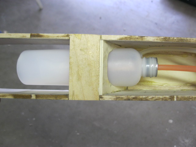

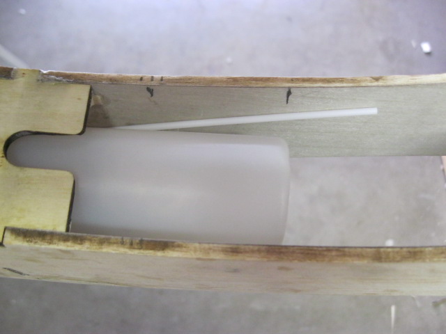

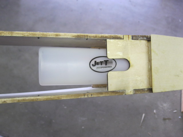

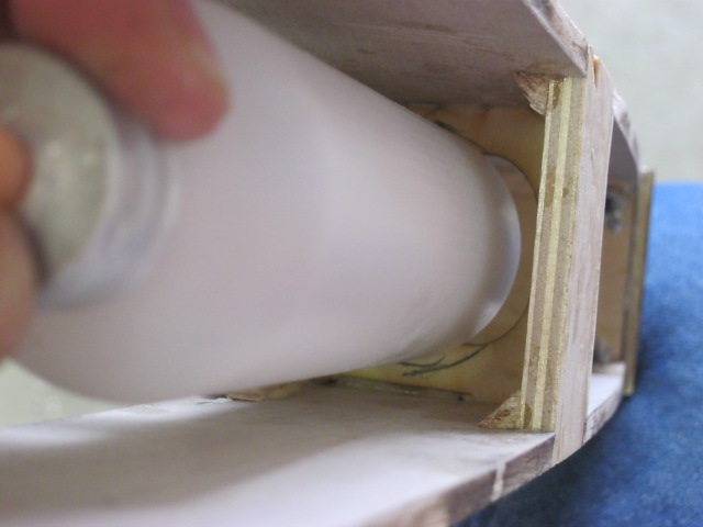

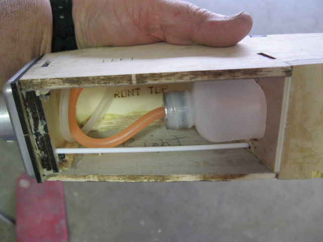

The former at the leading edge of the wing must be modified to fit the tank.
The pictures show a 6 ounce Jett slim tank.

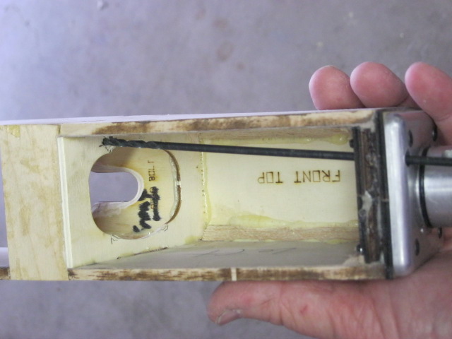

A hole for the throttle tube was drilled and the tube was temporarily installed.
I just use an antenna tube and will later slide a piece of thin music wire in it.

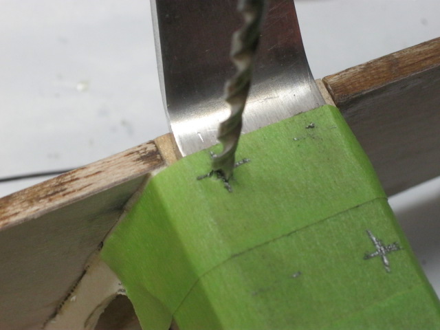

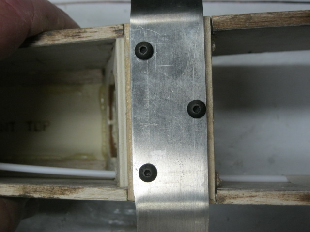

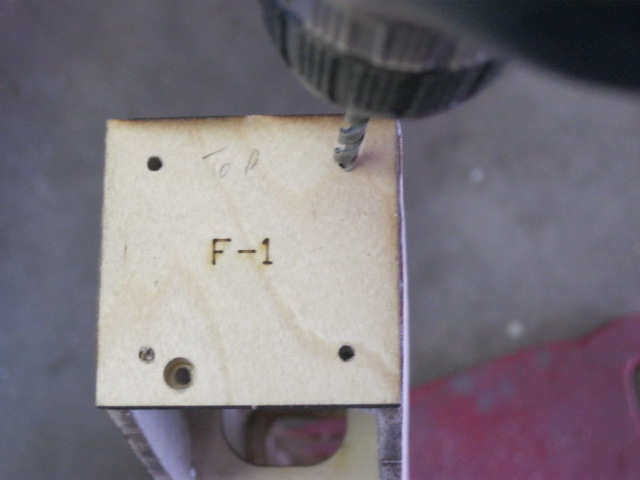

The landing gear was installed.

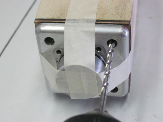

Begin by drilling holes for the 6 x 32 bolts and blind nuts.
ID:	1741285   Click image for larger version
ID:	1741286   Click image for larger version
ID:	1741287   Click image for larger version

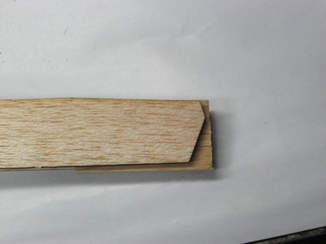

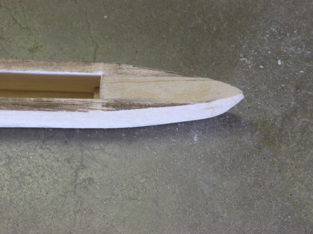

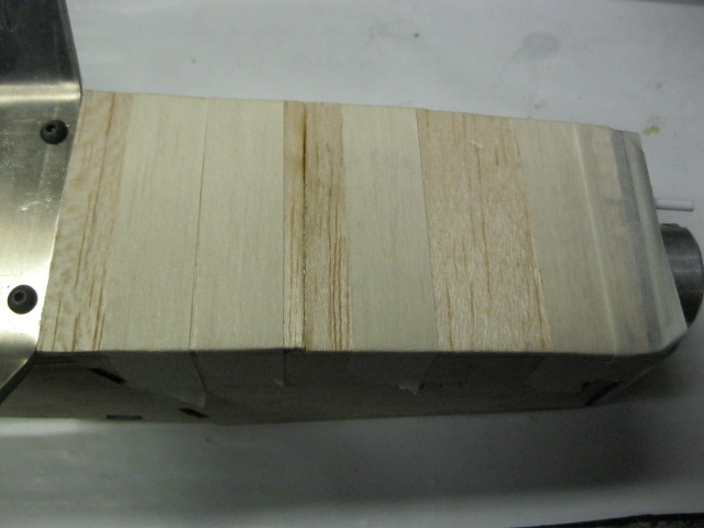

Triangle stock was glued in place in the nose.
The balsa sheeting was cut to shape and glued in place. Masking tape is used to hold parts in place until the glue dries.

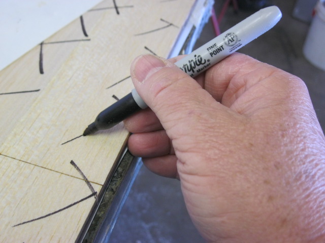

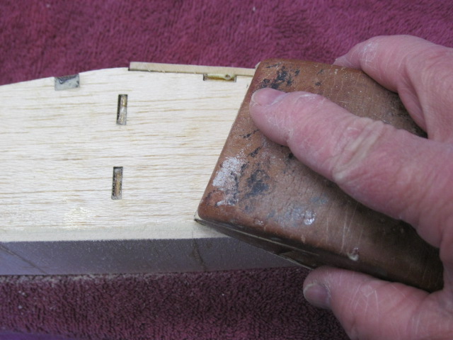

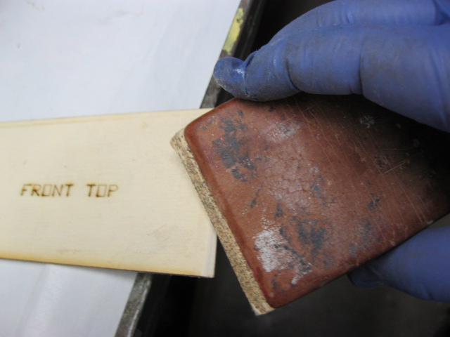

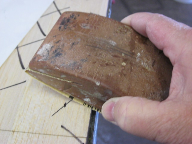

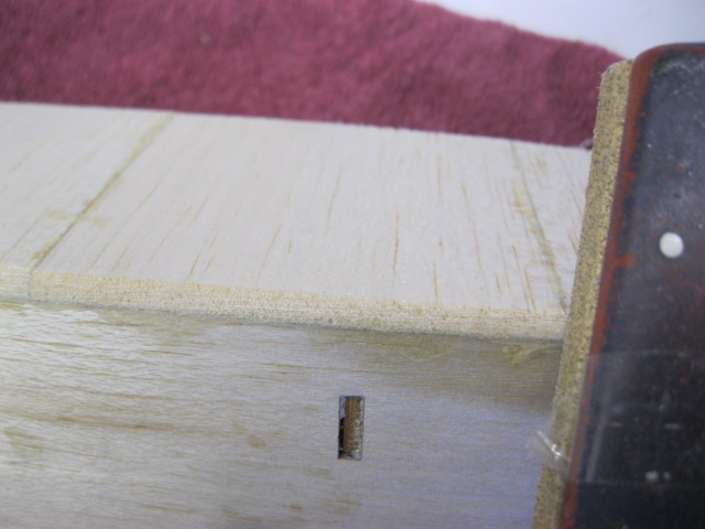

Sand the surfaces flush with a sanding block and 60 to 80 grit sandpaper.
Lightly round the edges with the sanding block with 100 grit sandpaper.
ID:	1742123   Click image for larger version

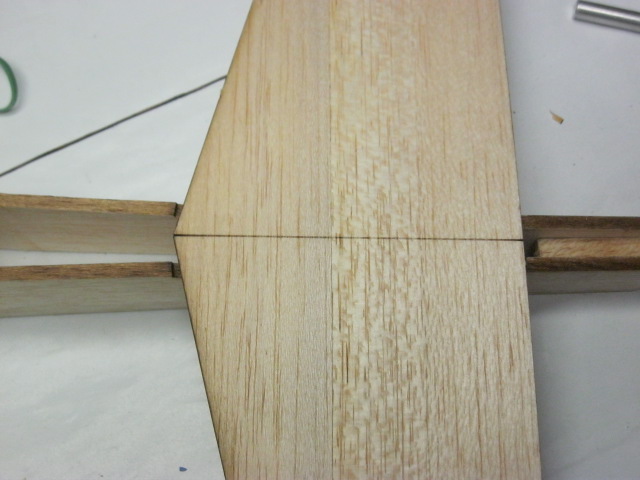

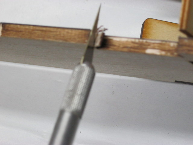

Old 03-24-2012 | 11:17 AM
  #47
Joined: Nov 2007
Posts: 2,060
From: Fritch, TX

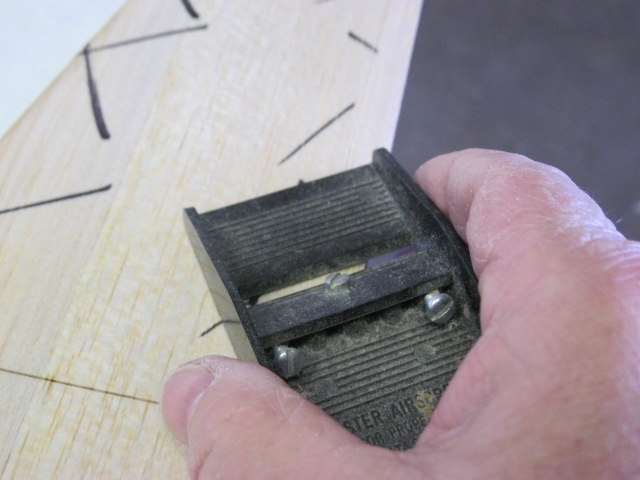

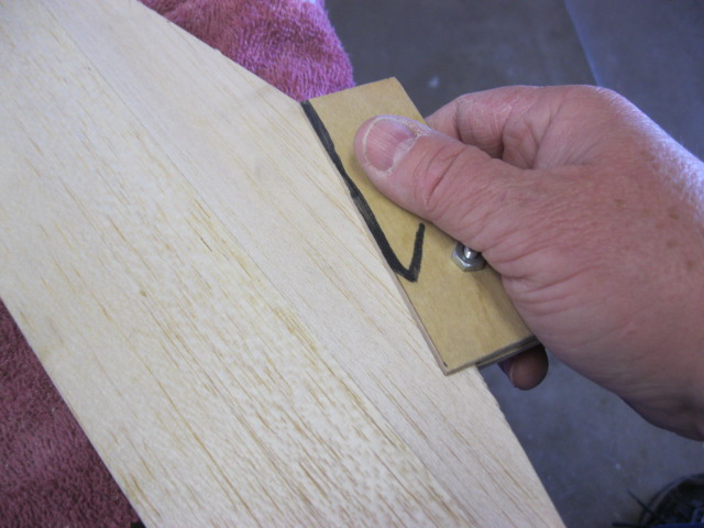

Use a slotting tool to slot the 1/4" thick balsa tail surface.
Shove the 1/64" thick pieces of plywood in the slot until flush.
Glue the parts in place with thin CA.

Shape the tail surface with balsa plane and sanding block.
From a side view the surfaces should resemble an airfoil.

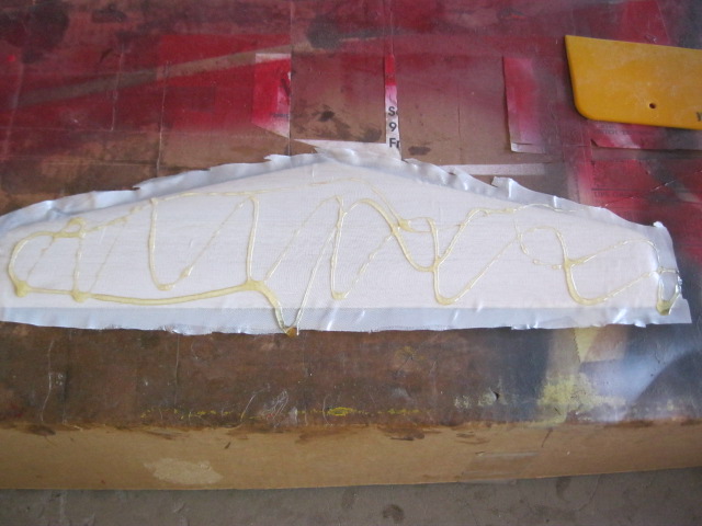

Spray a small amount of 3M77 on the top tail surface and tack a piece of window sheer to the wood. The sheer should be large enough to cover the entire top surface.
Apply 3/4 ounce fiberglass cloth over the window sheer the same way.
Apply another piece of 3/4 ounce fiberglass cloth on the other side.
ID:	1742135   Click image for larger version
Old 03-24-2012 | 11:28 AM
  #50
Joined: Nov 2007
Posts: 2,060
From: Fritch, TX
Mix about 1/2 ounce of finishing epoxy and squeegee it onto the top and bottom surfaces. Make sure the entire surface is sealed.
Place the tail surface between layers of peel ply (polyester or nylon fabric).
Place the tail in the vacuum bag and apply the vacuum (about 6"). The bag is made from 4 mil thick plastic and is sealed with latex caulking.
Allow the surface to dry.
