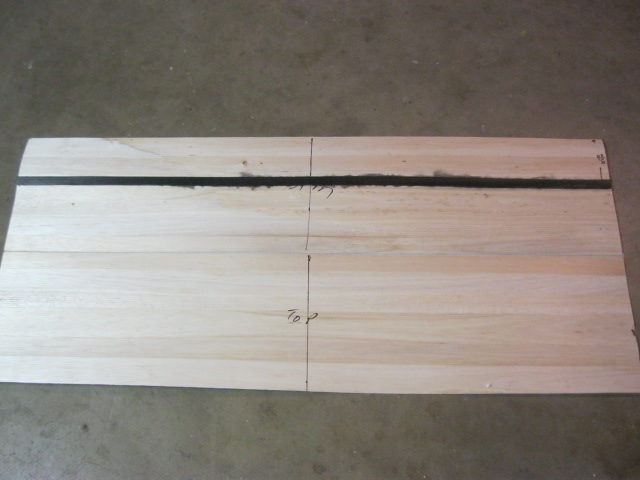

Join the two wide balsa skins as a book cover.
Leave a 1/8" gap between the skins.
Masking tape works fine.

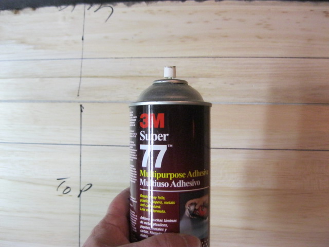

Old 03-10-2012 | 03:08 PM
Joined: Nov 2007
Posts: 2,060
From: Fritch, TX
Default RE: Intimidator II Construction Thread
Tear a 3/4" wide piece of 7 thousandths thick piece of carbon laminant.
Tack it in place on the bottom skin with 3M77.

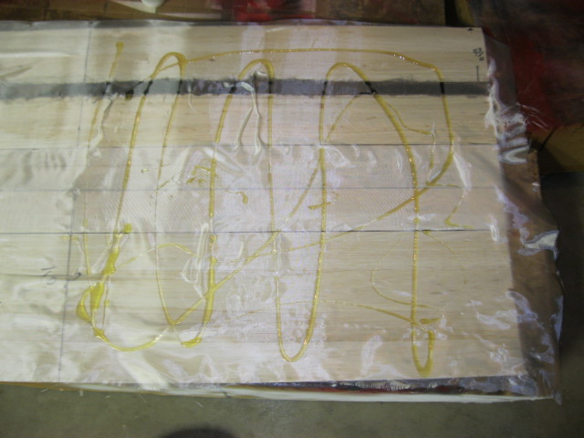

Mix about an ounce of finishing resin and then add about a 10% (cap full) of 91% alcohol. The total weight with alcohol is about 1.1 ounces.
This is then applied to the right or left side of the skin. Squeegee the epoxy as needed to spread out.
The other side is done the same way.
Slide the wing core between the balsa skins.

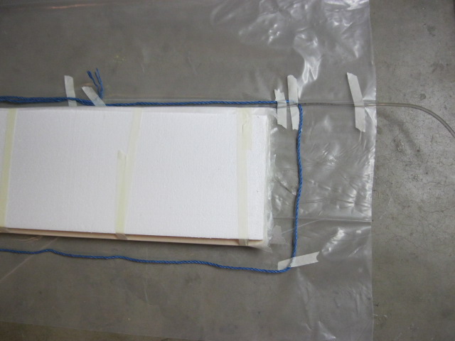

Old 03-10-2012 | 03:36 PM
Joined: Nov 2007
Posts: 2,060
From: Fritch, TX
Temporarily pin the wing shucks together making sure the parts are lined up.
Tape parts together with masking tape and remove the pins. You don't want to puncture the vacuum bag.
A piece of rope is taped in place around the wing parts.
Lay a long piece of paper towel on the top of the cores.
Tape the vacuum tube in place and apply a bead of caulking around the cores as needed.

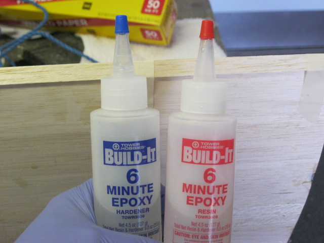

Old 03-10-2012 | 03:43 PM
Joined: Nov 2007
Posts: 2,060
From: Fritch, TX
The top of the tarp is folded over and the caulking is sealed. I just step on the edges to join the surfaces.
Turn on the vacuum pump to remove the air from the bag. Air pressure makes a superior clamp to hold parts in place while the glue is drying.
It was relatively cold in the garage so I placed the wing cores between layers of electric blanket. The warm surface insures that parts dry reasonably quickly (8 to 15 hours).

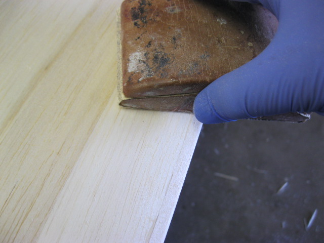

The leading edge was shaped with a sanding block.
The surface should rounded as needed. I used an old specialized sanding block for this service.

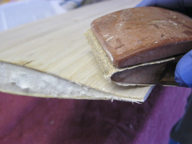

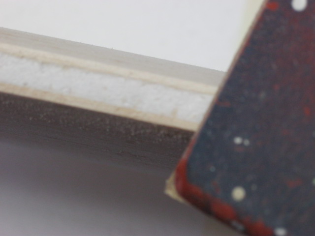

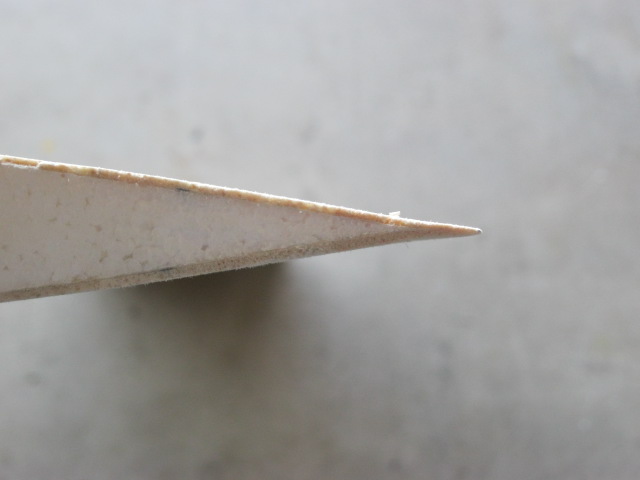

Old 03-11-2012 | 04:15 PM
Joined: Nov 2007
Posts: 2,060
From: Fritch, TX
Trim the trailing edge with a razor saw to make a 9 7/8" wide cord.
The trailing edge sheeting was shaped with a sanding block.
The fiberglass between the sheets makes a nice sharp trailing edge.
