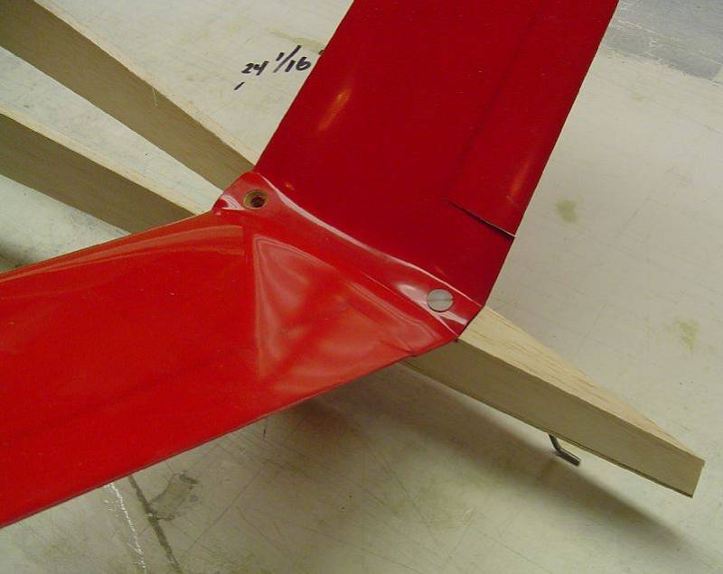

I had to raise the tail off of Dan's plate under the V-Tail. I used a couple blocks of 1/4" ply which was about right to get the Neme-Q tail even with the fuse sides. I trimmed the height of the fuse both in front of, and behind the tail to make everything look "correct".
I lost a little side area since the tail sits a little lower than designed, but since the Neme tail is so tall, I think I will be fine.
