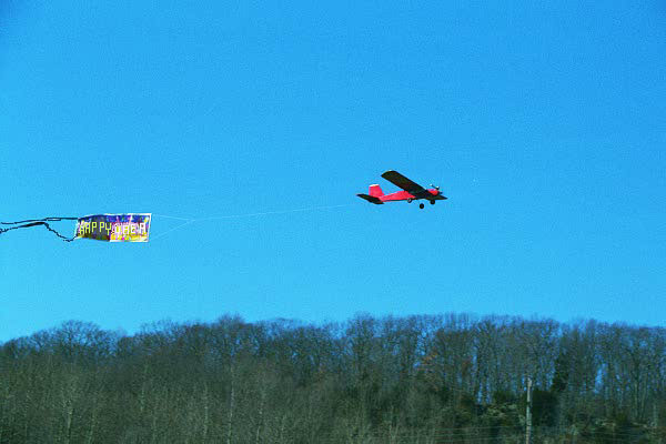

Hi Folk's That's my Kadet LT 40 powered by a Magnum 90 four stroke, pulliing that six foot banner!
The Banner is a Plastic New Year's Sign bought at a party store!
The lead edge is wrapped in a yard stick then stapled and taped! On the bottom of the sticks is about 4 onces of Flat lead from a Printer !A crushed sinker would do! The string pulling it is nylon cord you can by at any hardware store. It's important that the top string is a little shorter than the bottom one! I put about 20 or thirty feet of string from the Plane to the Banner! It is attached to a custom made hook in the bottom of the Plane in the center at CG It is a T shapped piece of coat hanger hanging out a small hole to distribute the weight and the stress! I have enough power to take right off 10 foot take off roll at best! I tied some strips of torn trash can liners to the corners to keep it from whipping! Make Sure ( That You Engine It dependable ) You have no GLIDE capabilty with all that Drag It will drop like a rock! If the engine quit's Point the nose Down and Land! It will not Glide! Also You must attach it At The CG if you hook it to the tail you lose you rudder control!!!

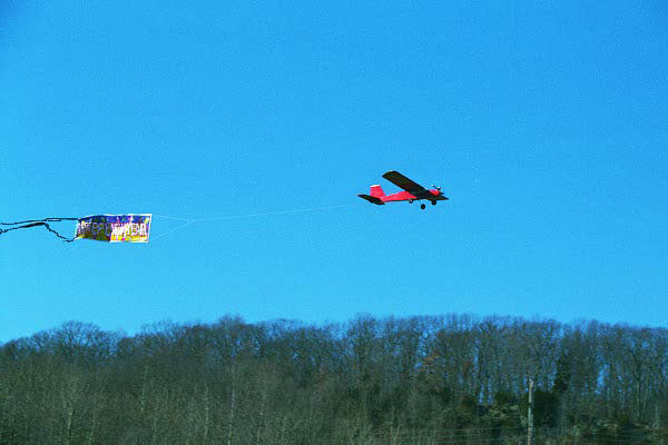

This one is a HAPPY NEW YEAR sign you hang on your wall! I put Two rows of three inch packing tape on both sides! I ran a piece of nylon string along the top and bottom. Again the top being shorter by a little! Then I hung a 2 once sinker on a 1 fot long piece of string to the front to keep it right side up! Then you need a steamer tail to keep it from whipping! Lay it on the ground then take off! Think! You can do it with a Happy Birthday or Happy Anniversary! The Possibilities are Endless!
I've been thinking of making one up to adverties SPAD's to club members?
I'm having way to much fun with this!!!

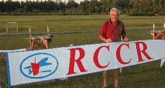

A club member, who has sewn sails for RC yachts, made the banner from ripstop Dacron, wood dowels, dacron (non-stretch) cord which is presently 30 feet in length. He cut out the club's logo and the letters RCCR and has stitched them to the sailcloth. The entire assembly weighs 9.6 ounces. At 30 mph it flies about 20 feet below the level flight path of the plane. It applies a rather 'large' drag force, and a large amount of flutter may cause damage to the banner. Any member may fly the banner. The towing point should be on the bottom of the plane very near the CG point. It is advised to have a controlled tow release to permit dropping the banner before landing.
The GP Kadet Senior ARF with a Saito 80 does a good tow.
(The December 1977 AMA Model Aviation article about how to fly signs was useful. It's on line in the members only archives.)
