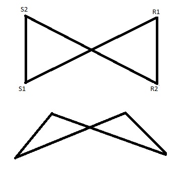

With crossed wires there is NO geometry that will exactly maintain the same line tension.
With straight wires, you can set the length of the servo arm to the same length as the control horn and achieve a perfect parallelogram. the lines stay the same tightness throughout the range of motion.
If you don't believe me about the crossed lines, draw it up in CAD and measure the lengths of the wires. Draw up something that looks like this attached picture.
Draw something like the first picture with both the servo arm and rudder horn the same length. measure the distance of the "wire" S1-R1 and S2-R2.
Then draw the next picture with the servo arm at 45 degrees and the rudder at 45 degrees. Measure the two "wires". They will not be the same as in the non-rotated picture and the sum of the two lengths will not match the sum of the original (unrotated) wires. No matter what angle you draw the rudder, you will not be able to get both wires to match the original drawing.

if length(R1,R2) = length(S1,S2), and the pivotal points are at the center of (R1,R2), and (S1,S2), then amount of travel of both wires should be the same.
I don't think so. I have drawn it up in CAD and I have also calculated it using trigonometry. When the servo is deflected 45 degrees, the rudder goes the opposite way (when the lines are crossed), but does not end up at 45 degrees (if you keep the line from the servo arm to the rudder at the same length. And the other wire must get either tighter or looser than before it was rotated. Not a whole lot, but a few millimeters different.
Yes - the amount of travel is the same, but both change from the original length by the same amount. The distance decreases, giving you slack in the wire.
Is the decrease linear to the angle of rotation? Could one measure and install the wires at the max decrease to have a slack-free setup?
