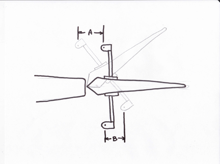

ORIGINAL: Lnewqban
Why is so important that the control horn holes align with the hinge's line?
See drawing attached. Because the horns are not aligned with the hinge line, length A does not equal length B for any angle of deflection. In this scenario, the cable on the non-pulling side will have slack. A couple of trig calculations prove it.[X(]
Kurt

Old 12-12-2011 | 12:18 PM
  #66
My Feedback: (15)
Joined: Apr 2004

ORIGINAL: gaRCfield
It is better to have the line go slack on one side, rather than get tighter. Both of my pull-pull setups go slack with rudder input due to imperfections in symmetry.
I still don't see the advantage of the servo 'wheel' other than changing the rate at which the rudder moves.
Call me biased, but I think the best engineers are the ones who grew up with hammers in their hands and ended up graduating from an engineering school.
I agree with you completely.
Kurt

Right, slack is better than getting tighter. If the attach point on the horn is aft of the hinge point, that is positive Ackerman (where the non pulled line get a bit of slack as you move off neutral). If in front of the hinge point, the line not being pulled will get tighter as you move away from neutral. Depending on how much offset is present, this can cause the servo to be overloaded and will certainly result in high servo current being drawn

Excellent bit of info. As shown, positive Ackerman is good. That slack in the line not being pulled has absolutely no bad effects on response and does not induce flutter as some have predicted. As one who has been using pull pull on all sizes of models for the last 20 years and on many models I am convinced it is the most trouble free and reliable way to control elevator and rudder control. I've also tried it on ailerons but did have some problems when the wing deflection (spar bending or deflecting under G loads) caused excessive changes in line tension if trying to use a single servo (long lines) for aileron control.

ORIGINAL: Bozarth
ORIGINAL: Lnewqban
Kurt
But the article proposes to move the horns aft the hinge line. Why?

Why Joe?
This is elementary trigonometry that is learned in high school.
It doesn't require engineering studies to understand that rotational to linear movement creates an asymmetry.
That is why pistons moved by a crankshaft have a max and a min translation speed, while the crankshaft keeps constant rpm's.
Using a pushrod is not problematic because the other side is free to move as it pleases.
As long as the pushrod is perpendicular to the lever from the point of rotation, the horn will deflect the same in both directions, without any differential.
Using two cables instead of one pushrod, forces us to compensate for that asymmetrical movement of one side respect to the other.
How do we do it? Introducing another asymmetry, by making the lever from the point of rotation non-perpendicular respect to the cables.
In other words, positioning the holes of the horn in line with the hinge works for pushrods, but not for pull-pull.
Crossed and parallel cables require different geometry, as the schematics below show.
The greatest the distance between servo arm and horns, the less evident it is.
The practical difference in slack and movements may be small and we may live with it, but it is there.

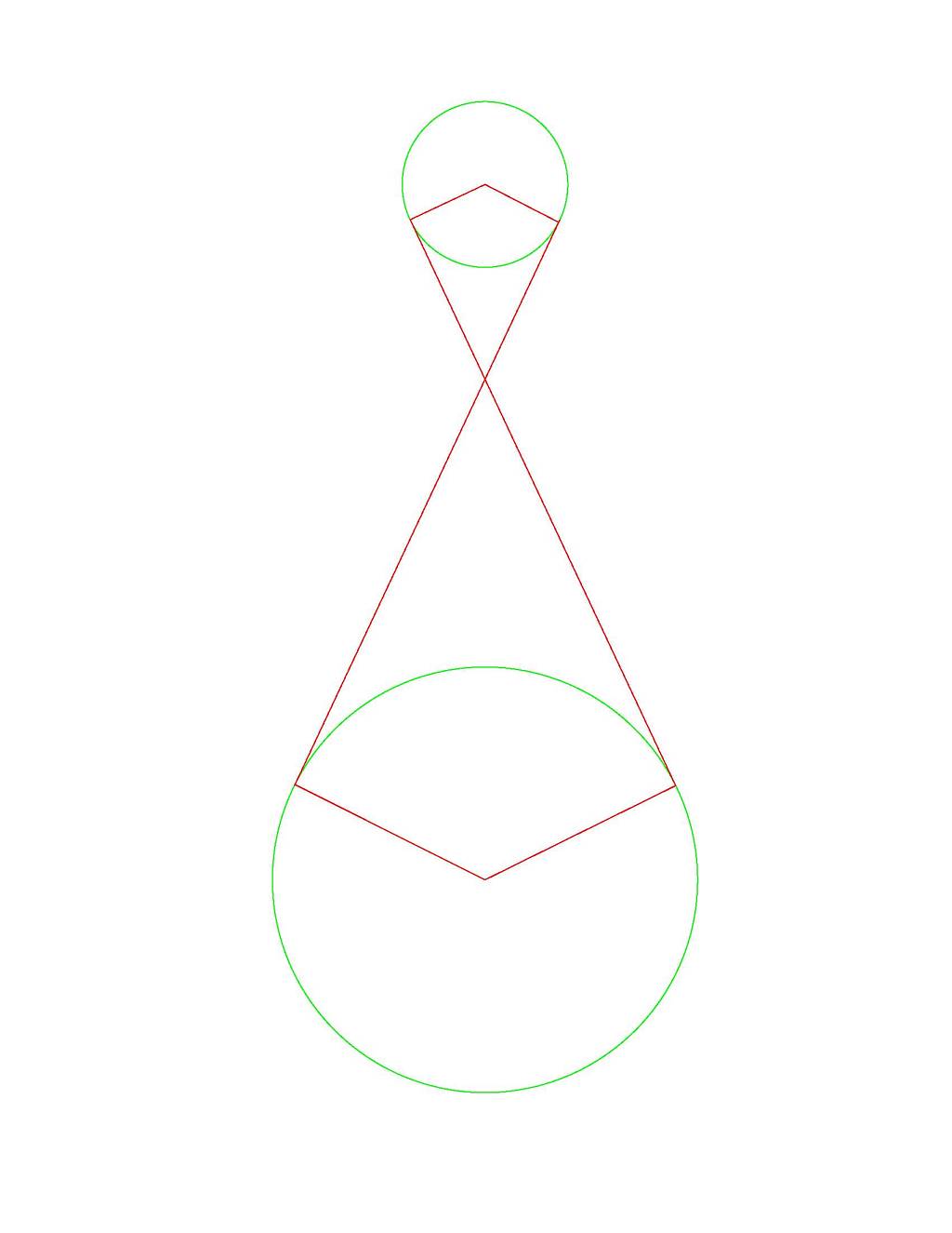

Why the top and bottom sections of a belt moving two pulleys, or a chain moving two sprockets never develop any slack, regardless of the direction of the rotation?
Because the belt or chain is always connected to the wheels at the points at which they are perpendicular to the lever from the point of rotation.
