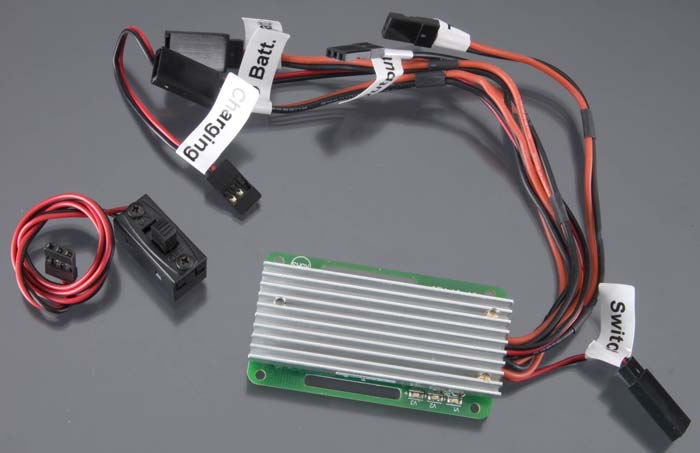

I am using the reg http://www3.towerhobbies.com/cgi-bin...&I=LXVDB1&P=ML with this battery http://www3.towerhobbies.com/cgi-bin...&I=LXVDB1&P=ML . I just got the set up and have not finished the plane. I like the system because it has so much fail safe built into it.
Posting pics in next post, david

These are the pics to match the links.
david

I use 3 cell lipos and regulator b/c my charger doesnt handle A123 plus my servos dont all handle 6+v. The balance chargers and proper charging techniques by the consumer have all but eliminated fire dangers though it is still a possiblity. I gve up nimh last year as well.
