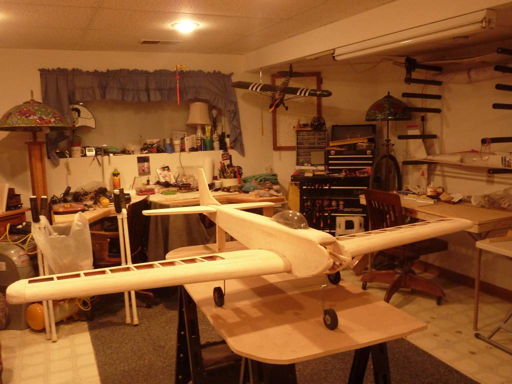

i am building the Ed Kazmirski's Taurus and i need to know what the throws are for this bird, rudder - ailerions and eleavtor, i am using 2 wing servos and i cut off 8" of the alierions so i know i am going to have to increst the throws on the ailerions,but i need to know where to start,thanks

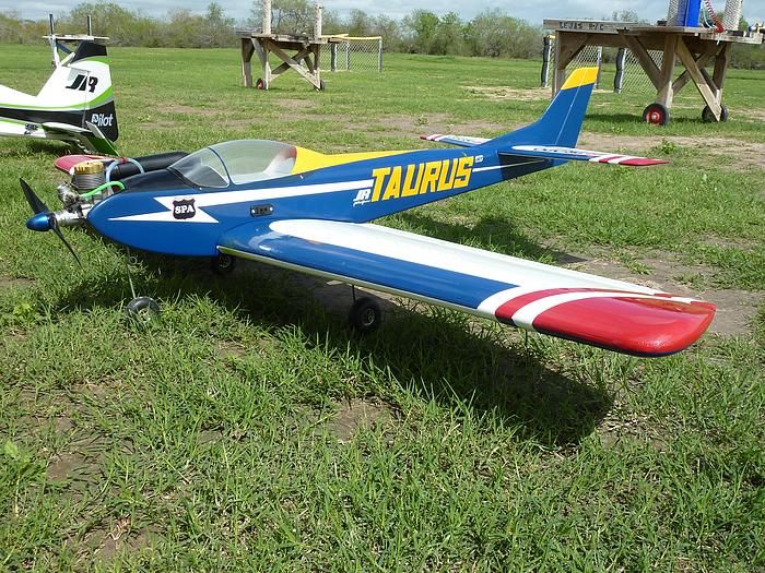

i just eyeballed my throws...i did max out the rudder to get it to knife edge a little better... its a really docile flying plane.... you'll love it....

Is that a K&B .48 on your plane? If so how do you like it?

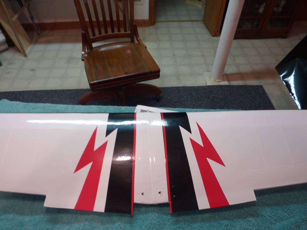

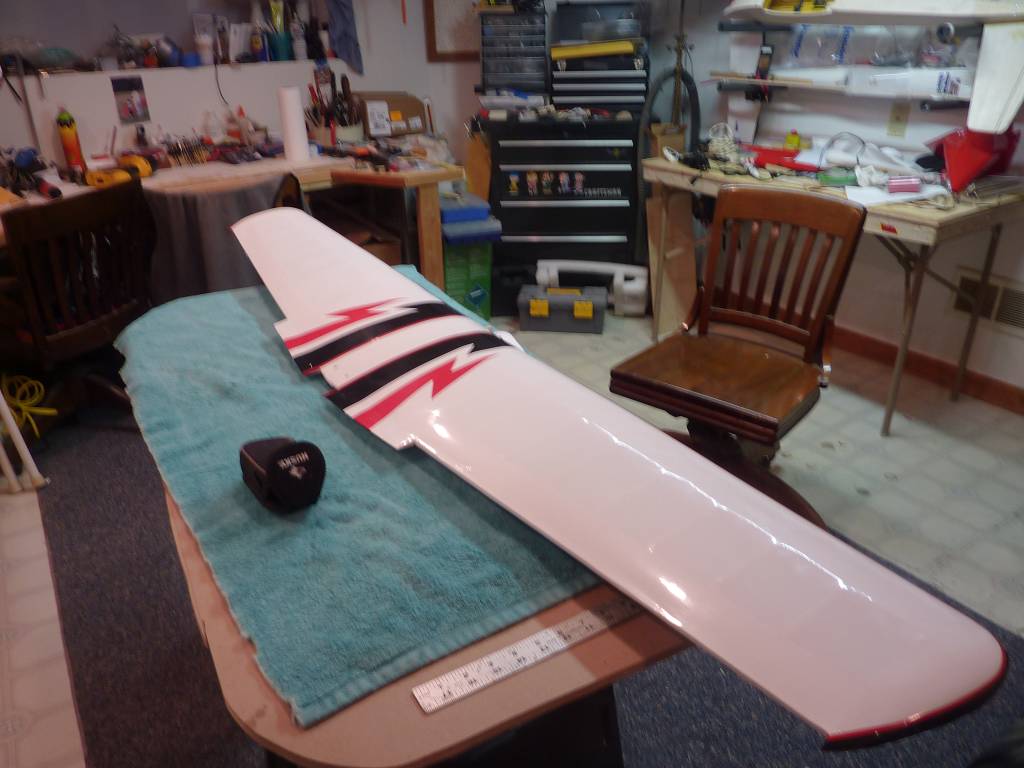

i am using two wing servos and made the wing a bolt on so i took out the center section where the wing servo was to make it stronger and added more wing to the ends where i cut off the 8 inches of ailerions
