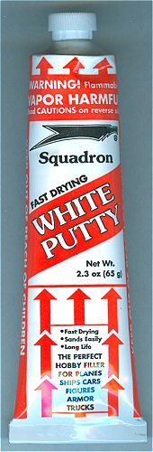

If the cowling is ABS.. Squardron putty works wonders.. its available in white or green... it makes for a seamless seam.

ORIGINAL: DGrant
Nothing better in the hobby world!

Is "Squadron" a brand name or what? Where do you get it? Is it a brand of spot putty?
Old 03-15-2013 | 06:06 PM
My Feedback: (15)
Joined: Apr 2004
Posts: 1,297
From: Aurora, CO
Default RE: microballoons and what?
It is a brand, and is sold at most hobby shops that cater to the plastic model builder. They sell two versions:
ID:	1862458   Click image for larger version

Well, the closest hobby shop to me is Branson, Mo. which is 90+ miles and the closest one that I would expect to have that is in Springfield, Mo. which is 125 miles. I have an auto body shop supply store about two miles from me. I guess I will go there and get some auto body spot putty.

Bondo spot putty and the epoxy/micro balloons will not work well on ABS. The squadron puddy will work best. The best thing you could do is use the ABS parts as a mold and fabricate some epoxy fiberglass parts.
