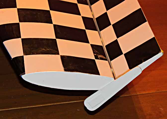

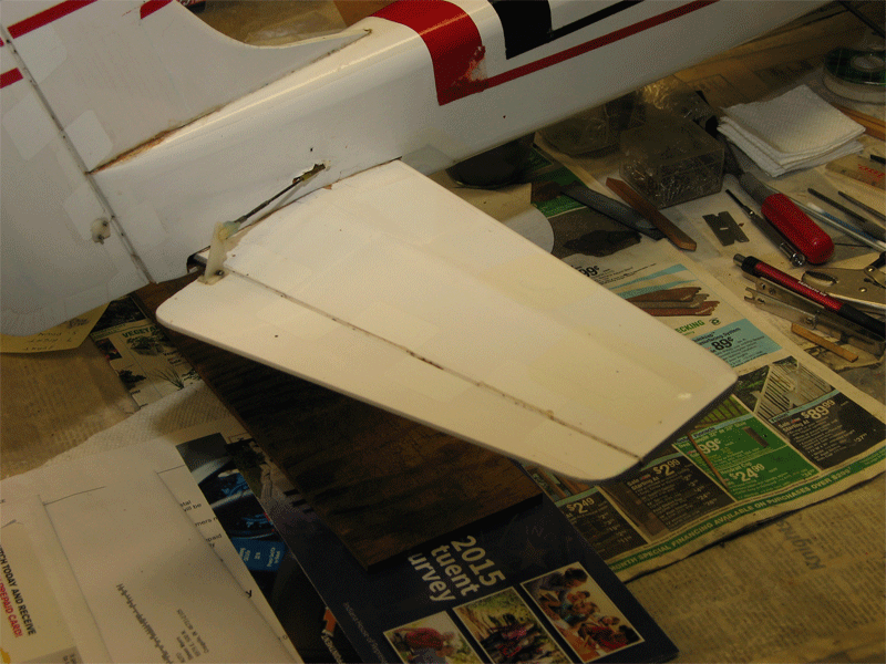

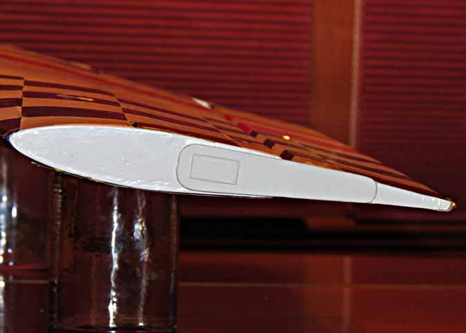

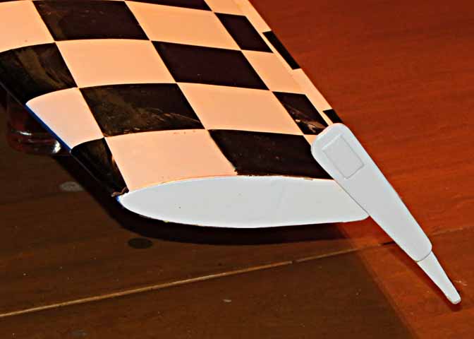

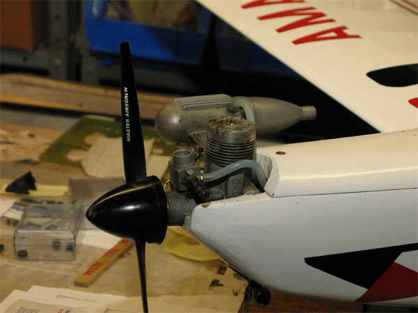

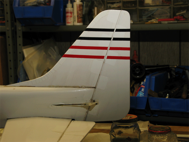

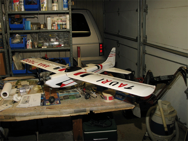

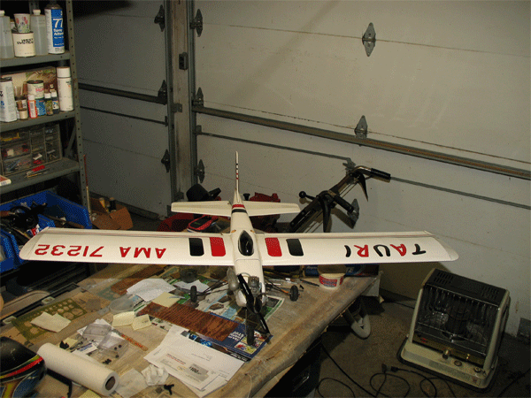

Here's some photos of what things look like.
ID:	2065171   Click image for larger version
ID:	2065172   Click image for larger version
ID:	2065173   Click image for larger version
ID:	2065177   Click image for larger version
ID:	2065178   Click image for larger version

Do you have any pics of the ailerons? The tip s especially, and the linkages.

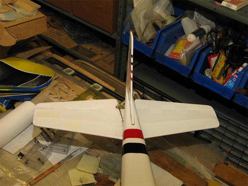

Also, how strong is the connection between the elevator halves? You could have the side not connected to the pushrod flexing loose.

If that airframe has experienced numerous flights where Flutter was a factor then I would have serious concerns about the glue joints as that plane is rather vintage.

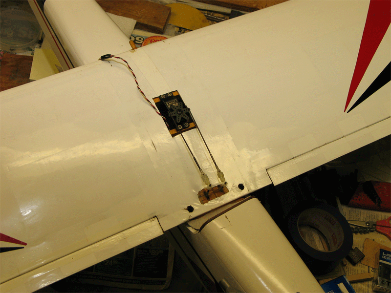

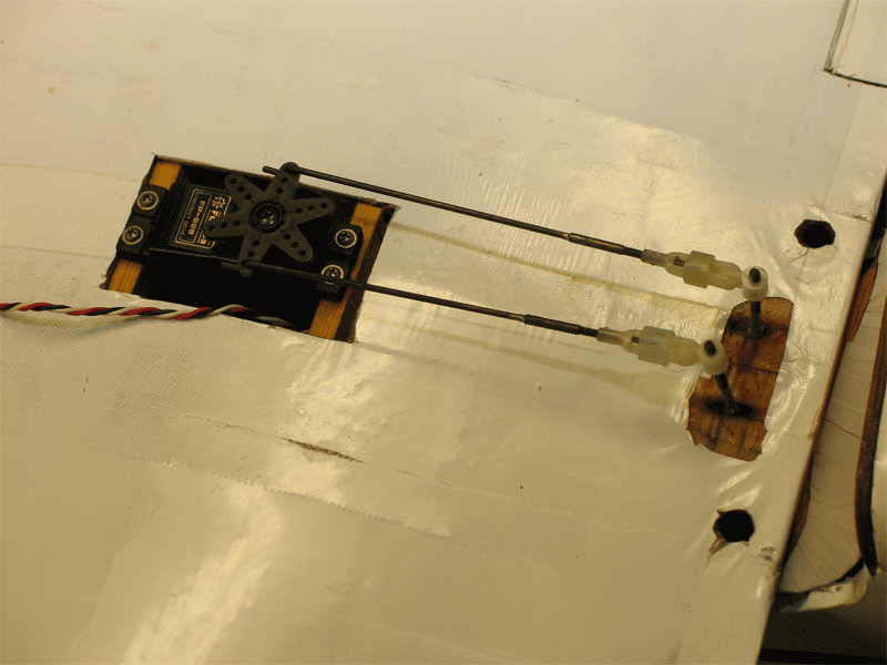

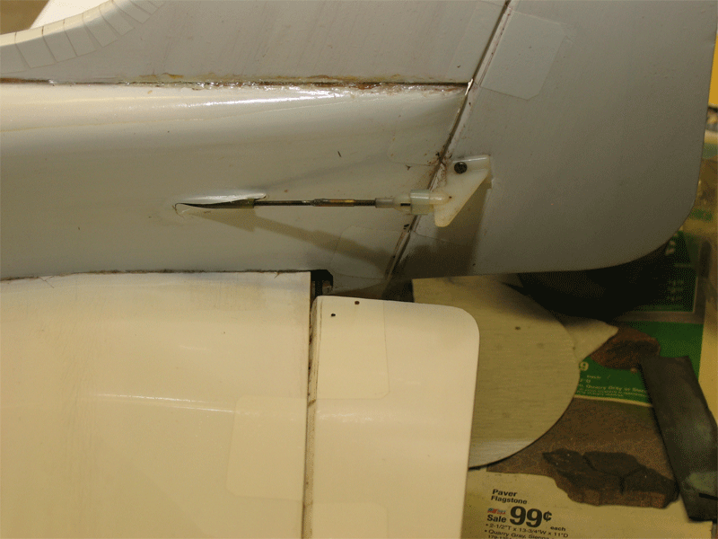

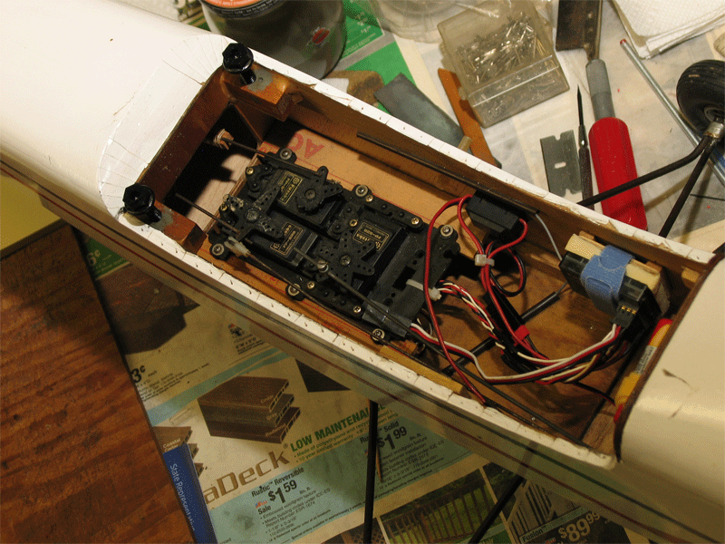

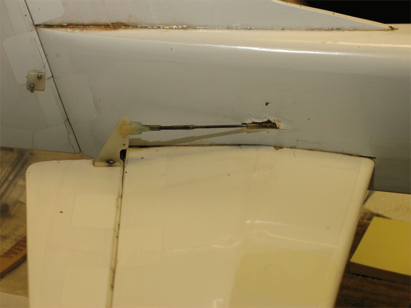

More photos
ID:	2065253   Click image for larger version
ID:	2065254   Click image for larger version
ID:	2065255   Click image for larger version
ID:	2065256   Click image for larger version

I don't see anything that jumps out at me. Maybe the elevator joiner. Could be some loose covering buzzing. Usually an airplane in best case scenario survives flutter once.

It is almost impossible to ascertain without seeing the plane in real life. Especially considering the surface that is fluttering is unknown.

I'd guess it aileron flex a the wing tips just the balsa itself flexing. If you're not wanting to change the aileron set up, that is cut them down and put 2 servos out in the wings, then you could try tapering the tips down. That should help.

While taking photos I looked things over close again. The ailerons and elevator are pretty solid, as good as any
other planes I have built. The rudder has some play in the hinge probably more than it should have. I have the idea
to disconnect the rudder control and pin the rudder so it can't move then fly. Maybe if the rudder is fluttering that's why
I haven't seen the flutter and it hasn't destroyed itself. I have had smaller planes with just aileron
and elevator control but have never seen or heard of a plane of this size with only aileron and elevator control. Does anyone see
any problems with trying this.

I'd check your exit tubes for buzzin of those long wood push-rods, could also try a slow speed run-up with a slightly unbalanced prop and look and listen.

I believe I have found where the flutter is coming from. It's the ailerons. The guys at the field though the rudder had a lot of slop on the hinge. They suggested taking the monokote hinge off and replace it with mylar hinges. So I did that. Still had flutter with the new hinges. Then I put a 6 to 8in piece of cellorphane tape on the end of each aileron. Still had so flutter but the sound had changed. Then added another piece to the bottom. All the flutter then was gone. I could fly fast as I wanted and dive as hard I wanted with no flutter.
