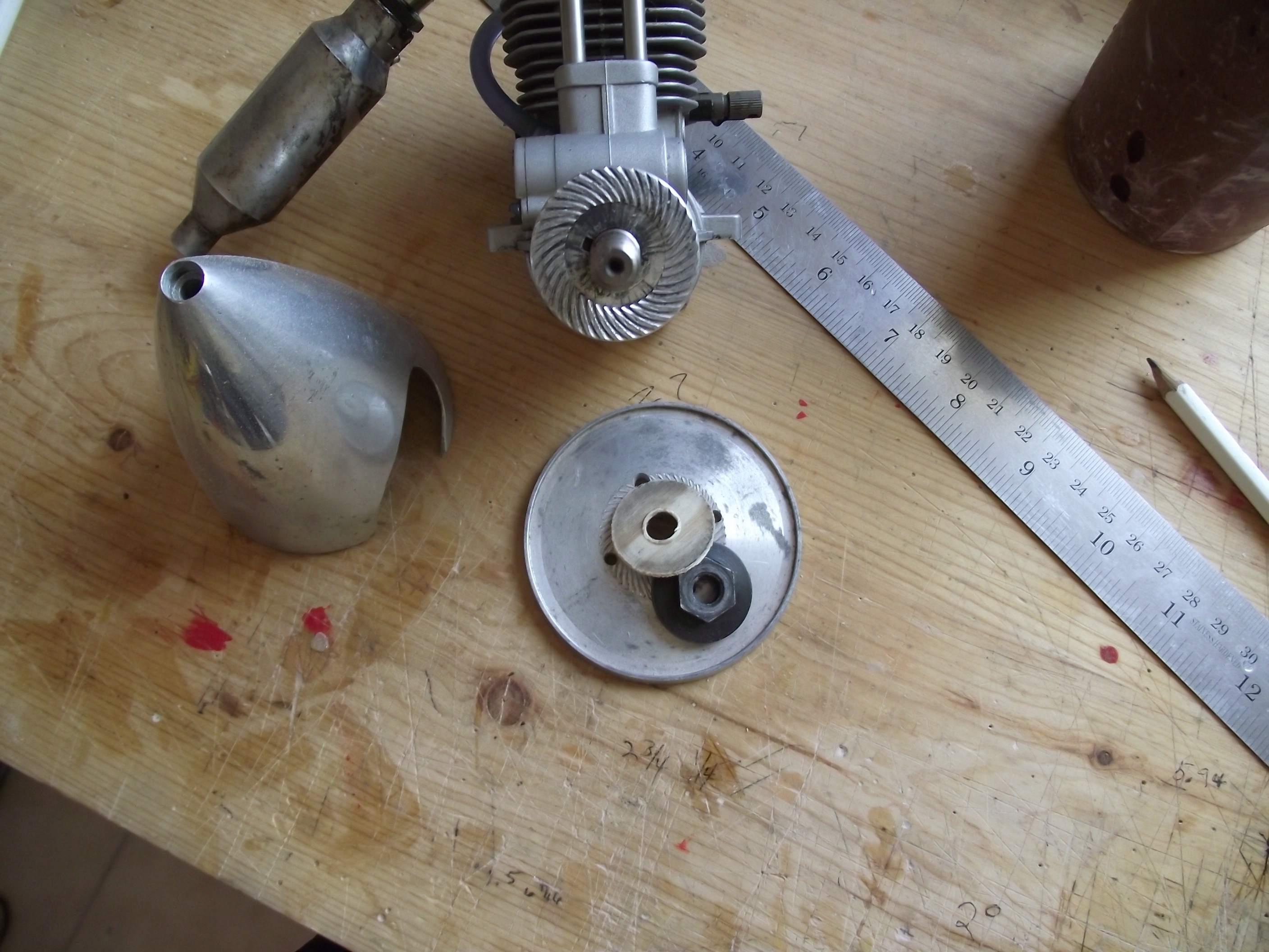

This is what Jenny mentioned, it's just a 1/16 piece of ply that was used to keep the prop off the back plate.
Makes you wonder why Great Planes doesn't make their aluminum spinner backplates with a raised, knurled center so that only the hub of the prop comes in contact with the backplate. I haven't found any other brand of spinner that doesn't do this.
