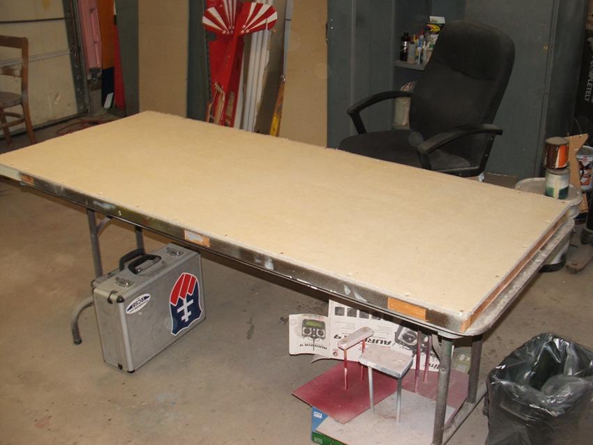

I have a piece of 1/2 sheetrock on top of my build table I noticed thre are ridges appearing in it now it is no longer flat does anybody have any ideas what I could use in place of the sheetrock?

I am using 3/4 inch particle board as my table top I was using 1/2 sheetrock to pin plane down on but now it has ridges in it and is no longer flat I need something I could use instead

I personally like a product called Homasoate, bought it at Menards. You might look at it and see. Holds t-pins GREAT, after cutting to fit the table I tape the edges as they sort of soften or round a bit.. But this is my favorite table top surface so far..
I'm think that there may be part of your problem. My other hobby is model railroading, and the consensus is that particle board warps, shift, and degrades over time. I would get a solid or hollow core door blank and use that as your table top. I have read where by people both swear at and by each type, so there's probably not a lot of difference. Use drywall or Homasote over the door blank.

I've been building on a solid core door for many years. dead flat and took about 2 minutes to throw it on top of a couple of sawhorses. Go to Lowes or somewhere they sell them and ask if they have one that's been scratched up and can't be sold as new for a discount.
I use homasote, too.
