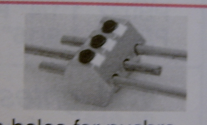

Hello; I was wondering if anyone out there have have seen a system that allows you to run two push rods from one servo for split elevators. I saw it in one of the RC airplane magazines but I can't remember where. I will try and describe it, It had three metal horns attached to a metal rod, and the servo hooks to the center horn and the two push rods hooks to the two outside horns allowing you to run two push rods from one servo. If anyone knows about this system or knows where I could get one I would sure appreciate it. Thanks George.

Sullivan make an "elevator splitter".
http://www.sullivanproducts.com/ContSysAccMainFrame.htm
If the servo is mounted with the arm motion happening in the same plane as the "dumbbell" (see the picture on Sullivan's site) then the dumbell will rotate slightly and the you will end up with differential movement between the push rods.
If you setup things up so that the servo arm and dumbbell are perpendicular then this is not a problem. If it can't be done this way, I wouldn't recommend it (having tried myself).
That may not be clear.... how about this: you don't want the little dumbell moving side to side as the servo arm moves because it (the dumbell) will rotate slightly.
Here's the luxury solution: http://www.centralhobbies.com/contro.../Bellcrnk.html
.... soldering two pushrods together will work as well.

For my Kaos with split elevators, I used the Dave Brown fibreglass pushrods. These come with several different plastic tips that allow you to attach metal rods to each end of the pushrod. Included in the set is a tip with two holes so that you can make a Y fitting and have one rod on the servo end and two rods on the elevator end. Cut slots on both sides of the fuselage and bend the rods to exit the fuselage through the slots. I flew this plane for several years and never had any problems with this set up.

Hello Stew99; Thanks for the info. I just went to the web site of the hobby shop I deal with up here in Canada and they do have the Dave Brown push rods you are talking about. It comes with two fiberglass push rods and five fittings and the one fitting is the one that is drilled for two wires for split elevators. Thanks again guys for all your help! It is sure nice to have a place to go to like RC Universe to get information like this. Merry Xmas to all you guys out there!

Hobby Lobby catalog#42 page 117 Graupner #GR9034 price $8.20 plus shipping. Anything else I can do for you?...JIM And happy Boxing Day to you! (These will work with nyrods, too)
