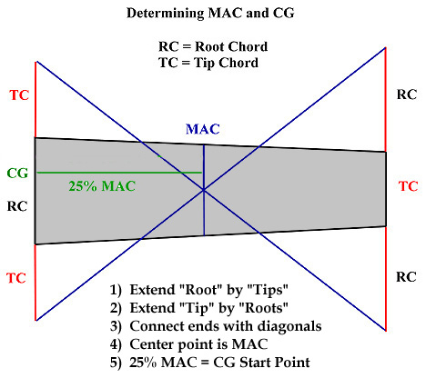

Here's a graphic that may help. You can determine the CG of pretty much any plane by using it.
Keep in mind, that ideally you want to start out by balancing at 25% of the "Mean Aerodynamic Chord" or "MAC". This graphic will show you how to get the MAC, and from there the CG.
Spend a couple minutes looking it over, and pay attention to "root" and "tip" cords.

OK,
I found the 25% MAC and tried the balance at 25-28% CG This plane is VERY tail-hevy at that spot. At around 30%(slightly fore of the spar tube) it is still tail-heavy, but less. If I need nose weight, where would be a good place to put it? I have a large plywood engine mounting block under the cowl, should I add lead to the top surface? Add a small (2 oz.) Heavy Spinner, and aluminum Spinner after that? Where do most of ya'all add your nose-weight?

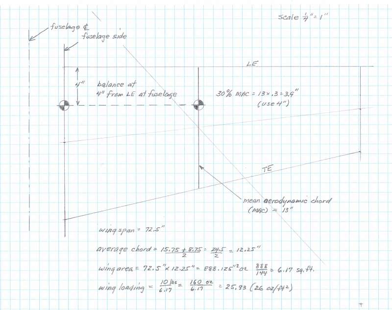

raynman:
First look over the attachment and see if I got your wing planform right.
the fuselage is 7 1/4" wide, root chord 15.75", tip chord 8.75" which means a wingspan of 72.5". There is no sweep to the LE, and the TE is swept forward.
If all that is correct, then the wing area is 6.17 sq ft and the wing loading is 26 oz/sq ft.
The balance point is 4" aft of the leading edge of the wing at the fuselage, put your finger at this point and make the airplane balance level. Balance upside-down if necessary.
Since you had a short flight already, you probably already have a feel for the control throws.
Good luck, and good flyin'
feihu[img][/img]

feihu,
Your drawing is almost spot-on!! My fuse is actually 6-3/4 at the leading edge of the wing.
At the 4" spot aft of the leading edge the plane "almost" balances I might need 1-2 oz. more weight in the nose. As far as angles of control throws I will use you measurements and re-adjust accoring to angle, not inches. I'll get a protractor and get the proper angle.
Thanks again for your posts!! I'll be back!!
