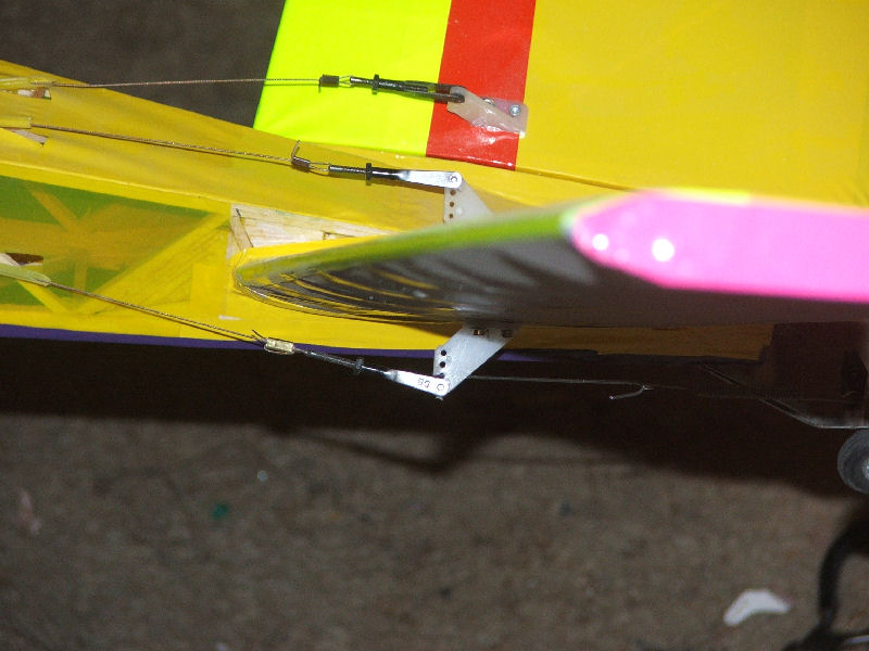

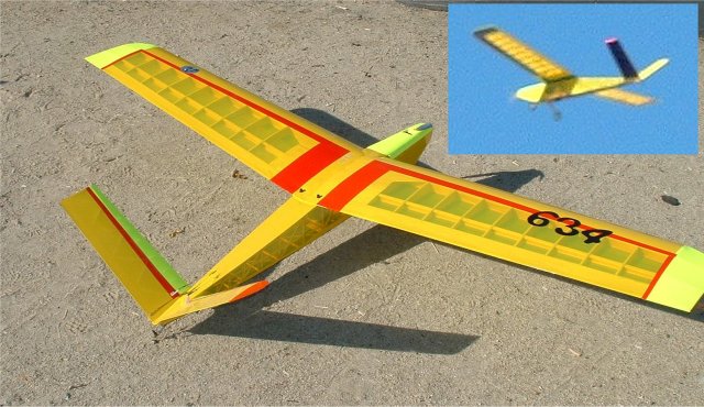

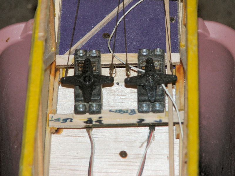

Old 01-25-2006 | 01:55 PM
Joined: Jun 2002
Posts: 5,211
From: Palmdale, CA
Default RE: Pull-pull system question!
I use this on a 100" flying vee-tail electric..
