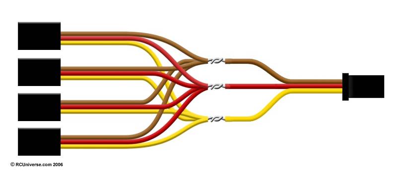

No problem, for 14 bucks you can buy four 6" extensions and make it yourself

I'm no electronics expert but the power drop thru 1 connector to 4 servos ( in my case 4 high torque digitals ) would be a problem.

I've never split digitals 4-ways, but I've run 4 analog servos this way many times with no problem.
In fact, this is better than using 3 "Y" cords due to the lack of connections
