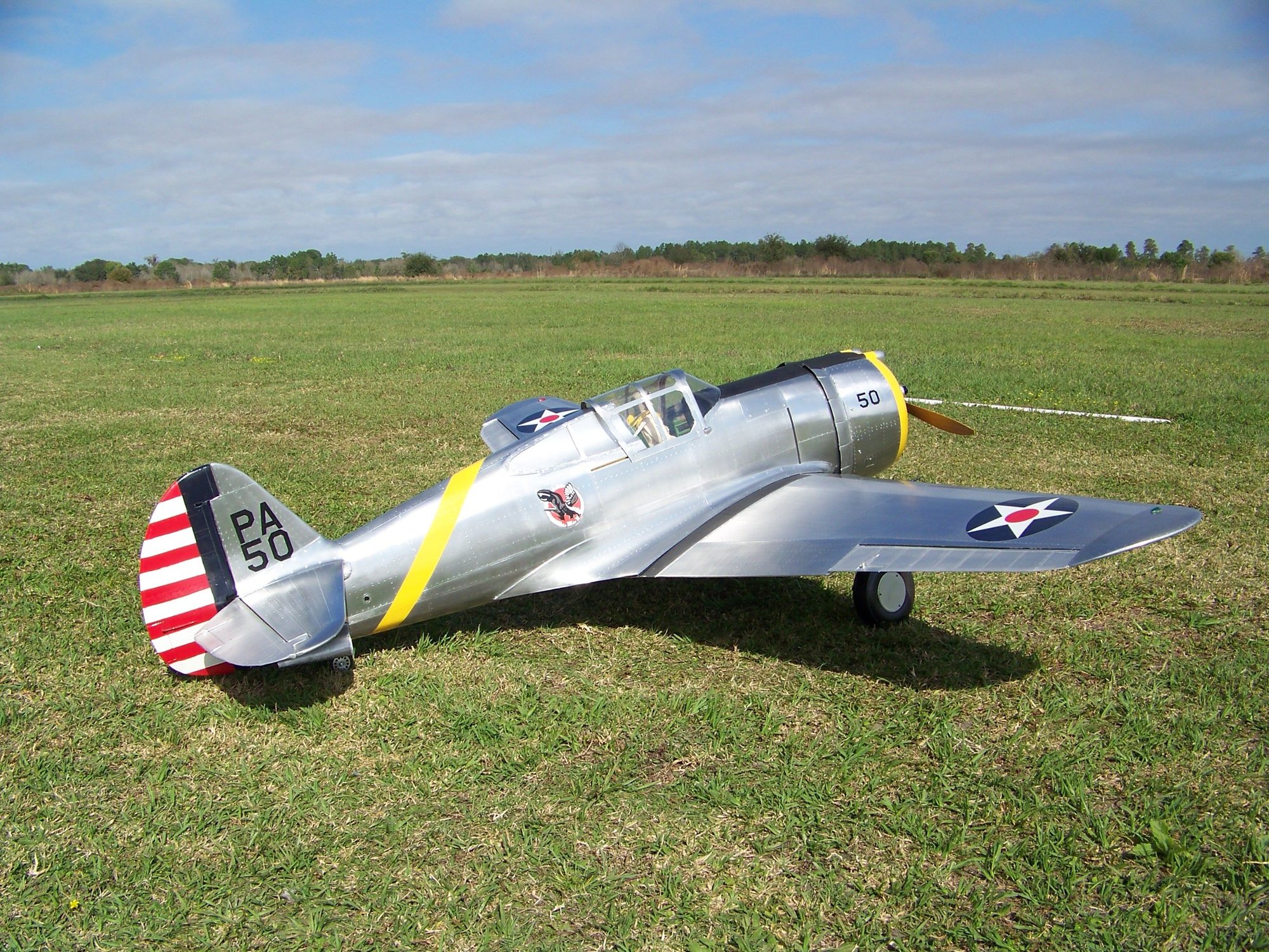

Hi Guys,
I am a believer of Flite-Metal and the way it brings the true colors from a model to the most realistic look. Yes, it is time consuming, but the final product is very rewarding.
I have done three jets and a P-36 from Jerry Bates plans (See photos). I am glad to see this Forum and the detail on how to produce a model to reality.

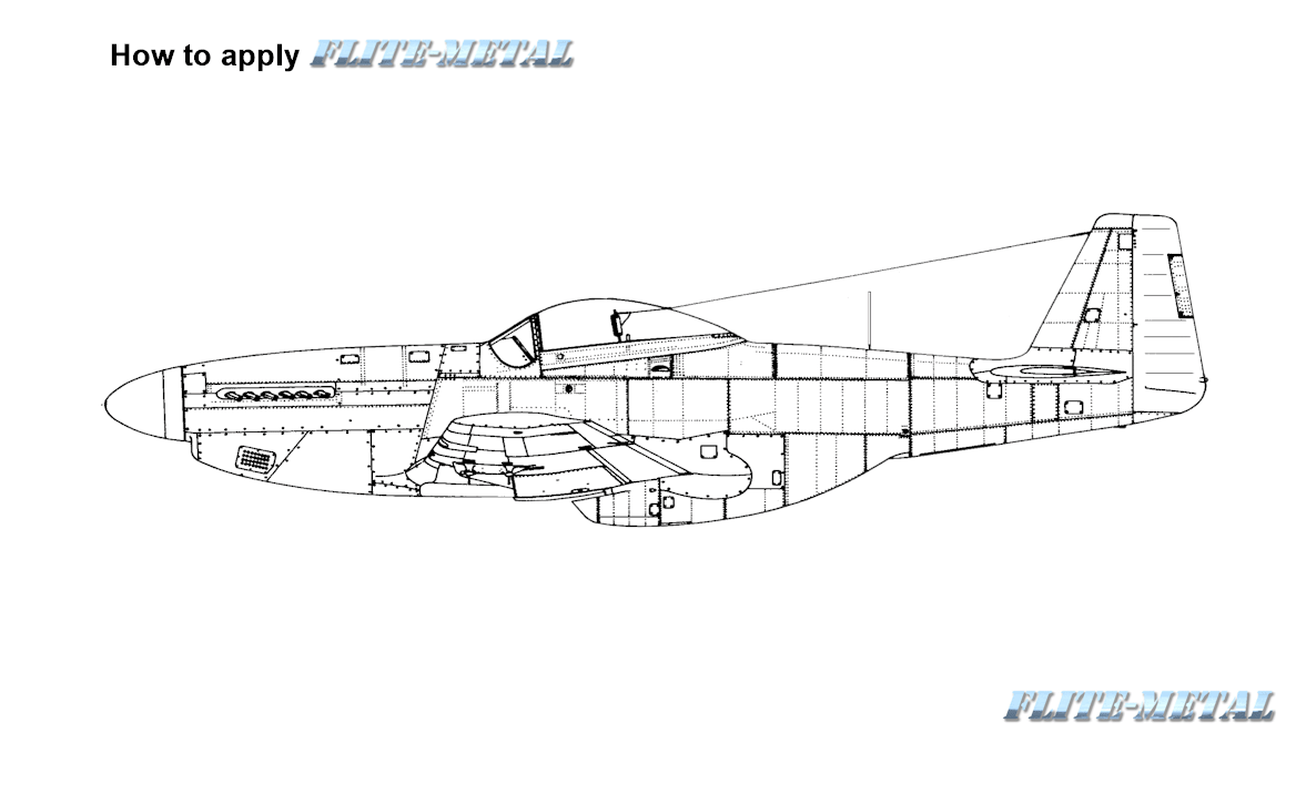

Do NOT apply any other way than
! Or it will wrinkle... Why ask here instead of emailing me?
Old 08-25-2025 | 09:43 AM
  #30
Flite-Metal's Avatar
Joined: Jun 2020
Posts: 371
Received 19 Likes on 17 Posts
There is an animated instruction and video instruction for two completely different covering circumstances. Follow the video and animated directions for a wrinkle free model.
