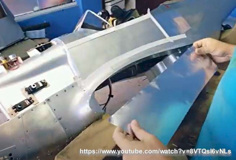

Well after years of buidling some nice aircraft I decided to try the flitemetal covering. The plane is glassed, primed and wet sanded to 1200 grit untill the primer is almost as glossy as paint. Ok.. so I read everything thing I can find on flight metal, lay out all of the panel lines off of scale drawings, measure my first panel (bottom rear of fuse) cut out the fight metal to fit the tape outlined panel I am going to cover. I carefully pull the backing off and find out that the adhesive is very agressive but manage to get the piece placed about right(once it touches it sticks and repositioning creates mega wrinkles). I use my index finger to start working the metal into place starting at the center and working out. The panel is curved but not componded so it should be easy.. right? Wrong.. part way around the piece a wrinkle develops. I keep working it down thinking that I can burnish the wrinkel out. I start with the fiberous tool and things go well untill I hit the wrinkle. No luck so I try the sharpie pen that also serves as the hard tool for working the surface. No luck and the pen actually creates its own problems. I made a tool that has a rounded end and buffed it as smooth as glass.. no luck the wrinkles are there to stay. Not as bad as at first but very noticiable. So I pull off the piece to start again.. I use heat per instructions but the glue is tanatious and aluminum conducts the heat so quickly that the primer is screwed up. Once off glues is every where, which comes off with elbow grease and paint thinners.
Moving on to a new piece, same problems as before but not as bad of wrinkels. I create the cut line by burnishing the material down along the 3M fine line tape then taking a sharp rounded exacto blade as per instructions try to cut. The blade drags and fights the cut. I make serval passes then pull up the excess. I find that I have cut through the flight metal but not its adhesive which stretches out from under the fixed part before it lets go. The adhesive snaps back and cause small blemishes under the metal along its finished edge.
I tried one panel using windex per an artical I read on RC universe about a Jug covering. It must take days to evaporate because try as hard as I could to squeegy out the windex the panel remains wet, getting trapped between the fite metal and the primer. Mean while the tape that defines the outline lifts off from the wet and the panel lines put on with the supplied pen start to bleed and make a mess. It is impossible to cut the metal when it is wet as it slides around. Now what????
So.. anyone out there have a lot of experience with this product. How do you get the wrinkles out... I can only guess that this is going to get worse as I move onto more and more complex areas. And how do you cut the material so you do not go too deep or too shallow? Any help is appreciated

I spoke with the supplier yesterday. I tried using just a light, very light mist of windex and things went much better. Layed in place, adjusted it and started spreading out with my finger, pushing the windex ahead as I went. This way the material will not start to grab ahead of its self and cause the wrinkles. The panels I did went on nicely. The other thing I learned was that you cannot just look at one panel, you will see small scratches and any other blemish. Once a few are on the small things tend to not be seen. I also learned that after the panels are on I should wet sand the entire surface with 600-800 grit wet and dry, used wet. Then you scuff or polish the metal. I tried this on a scrap placed on my glass work top and discovered that I had a lot of scratches in my glass..lol... but the sanding goes very slowly, probablay take half as long to sand it as it does to lay it on the plane.
They say to use a ruler to find the greatest contact patch but I must not be understanding this part too well. I thought it ment to look for the straightest point of contact, but that did not work on the compont piece I tried putting on dry. I will have to rethink that part.
Well, though not for the unpatient, I think I am slowly getting the hang of it.

Learned an very important secrete this weekend. When cutting the flight metal, dip the knife into paint thinners before each cut. This way, the lubrication allows a much smoother cut but more importantly.. the thinners desolves the glue along the cut allowing the waste to be pealed off cleanly. Before this I had to cut way to hard and deep to make a clean seperation. The difference is day and night and the blade lasts 10 X longer
Getting the hang of it more and more.. still have problems getting enough stretch for complex shapes. I think the trick is to creat excess material further back so there is enough material to work into or around a concave or convexed area. I keep getting close but the material finally splits just as I think I may finally get it all down.
Also, though a shoot of windex allows repostioning, it takes several days before you can add the next panel next to it or the tape will pull the first panel up. When ever possible, I found that making a template just big enough to cover the panel + the tape outline, then carefully lay the piece on the plane dry.. If it is curved area, find the longest run with in the panel, usually diagonally, then cup the flitemetal so it can only contact a center point. I then use my finger to work it down along the longest point being sure to keep the edges cupped up so you do not have premature grab. I keep working the the piece down using my finger,slowly allowing more and more of the cuppled sheet to come into contact. Your finger is less likely to cause stretch, but when stretch is need, the artists stump used at the point allows a smooth application.
The one thing I think the supplier should do is supply much better instructions on the application methods. The pictures are too small and the text is very brief. I know he did not want to confuse but in reallity, the lack of info is the real problem. The material is very pricey, I dont think adding a few more pages of instruction would subtract from the bottom line.

Hello Randy:
I'm actually rewriting the application instructions. There are many hints and suggestions which we can add to
the instructions as well. These will appear with the CD I plan to offer thanks to Mr. McFarland's camera work
as he covered his P-47.
Ian Richardson's BVM F-100
Placing a plastic ruler on its thin edge in the center of a panel and rotating it about its center will help you to
see the largest contact patch between the surface and the yet to be applied Flite-Metal. Placing the rectangle
of Flite-Metal square to the center of the masked off panel then making the initial burnishing with your finger
along the line of the largest/longest contact patch will permit Flite-Metal to gently stretch while you burnish.
When stretch is needed, simply burnish with greater force across the shape change, working outward across
the entire panel area rather than concentrating in one area. Think in terms of covering with plastic film. It has
to be ironed on over a large area to prevent wrinkles...being evenly ironed as you move forward and across
the surface.
Hope these suggestions helped.

I agree Jaka...I did some test panels up on some very smooth plexi I had. I wet sanded starting at 400 grit and worked up to 1200 girt.. did not like the finished product. I polished it with several different polishes.. mothers etc... but while it got shinier.. never really came up like I expected it.. in fact so far just polishing the flite metal on the plane unsanded looks better.. so another learning curve I guess, lol...
I have the plane and wing completely covered.. The wing tips were the worst, while I have the stretching part down now... (I work the metal ahead of the surface creating stretch before it contact). There just is not enough stretch to cover a bulbous compond curve. Eventually the metal just tears. So I did the bottom first to the the 1/3 point, then did the the center front to tip, then finished with the top over lapping the center. The lap line is just about invisiable because it is in the curve. I tried 6 different times, started the piece in different locations but no way I could get it to conform to such a complex piece with out spitting or bunch up (you cannot shrink the material so if you start in the wrong spot you will eventuall wind up with wrinkles.)
Ok.. Now what the plane is covered.. Do I wet sand??? As I said, I tried a test piece that had a lap on it and sanded to 1200 grit with not great results..
Also, do you apply the rivets before polishing?? The stuff is so soft that I would think you should imprint the rivets first then polish as other wise you will have a million more scratchs as you handle the parts. I want to have all of the rivets imprinted before I paint the anti-glare panel on the cowl and the wing walk stripes... decals etc...
Thanks for any help...

There isn't a specific sequence to marking rivet locations, making the actual rivet, and polishing Flite-Metal because there are multiple ways of accomplishing this, with results that vary from semi weathered to mirror polished surfaces. You should experiment with your resources to see what results in replicating your documentation.
There are as many surfacing methods as I have customers. That in itself is what makes Flite-Metal part of your model construction experience. I like to think of it in terms of combining one's model construction/finishing skill with Flite-Metal for a winning combination. For example, most customers cover a wing tip in two pieces. That would be the bottom to just below the shadow break line, then top down from the panel line to the shadow break line.
Stretching the aluminum at the surface contact point permits up to a 25% area mass stretch. Attempting to stretch off of the surface will result in under cupping the unburnished aluminum as it stretches. Under cupping typically results in immediate wrinkles when the overly stretched aluminum is pressed onto the surface. If the aluminum is permitted to simply be adhered to the surface without too much pressure applied to the surface, stretching and resulting wrinkles will be minimized to virtually non-existance.
The twelve inch packaging of Flite-Metal behaves entirely different from the six inch width product. Inidividuals whom have only used twelve inch widths are amazed at how much less aluminum is wasted in the application process and how quickly the six inch Flite-Metal is applied. Our twelve inch product is intended for use on larger than six inch width panels...period.
Attempting to cut down the twelve inch width product to achieve savings on the overall project is a false economy because of inherient stretch factors of this specialty alloy. Each time the poduct is handled, it will stretch. To minimize wrinkles and reduce overall stretch of the aluminum, I arrived at a six inch width on three inch cores for ease of packaging and application of Flite-Metal.
Originally, Flite-Metal was not backwound onto cardboard cores, it was simply converted to a loosly wound 25 or 50 foot length, placed in the plastic sleeve and a cardboard box. In order to reduce damage in transit and improve application results the cardboard core was introduced.

Nothing about applying and finishing our product is an exact science. The majority of the finishes you have seen on our
web site and magazines covering domestic and international scale competition are achieved by customers whom have
experimented with the application and finishing of Flite-Metal to achieve replication of an actual airframe surfacee.
For the sake of anyone reading this thread in the future I include the
animated application instructions
found on our web site and on the CD accompanying FK packaged products sold on the site. This should make it much easier
to understand since unlike videos it takes the hands out of the way so you can clearly see the model surface and process of
application "after" identifying the largest contact patch in the "to be covered" model panel.
Click the animated
.gif below to view the recommended method of applying our products. .
Click the animated
Last edited by FliteMetal; 03-29-2014 at 09:59 AM. Reason: Clarify Referenced Application Process

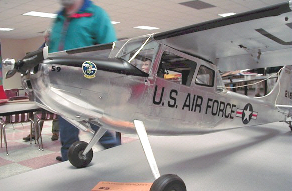

How close do you want to get to see "The Look Of The Real Thing"? The first image below was a pic taken of
Flite-Metal applied by the Toledo Show Best Of Show winner "just off the roll" with no finishing preparation at
all...that's raw Flite-Metal.
I have other pix of the Flite-Metal surface at about three to four inches...the above were
taken at around 6 inches as the closest.
