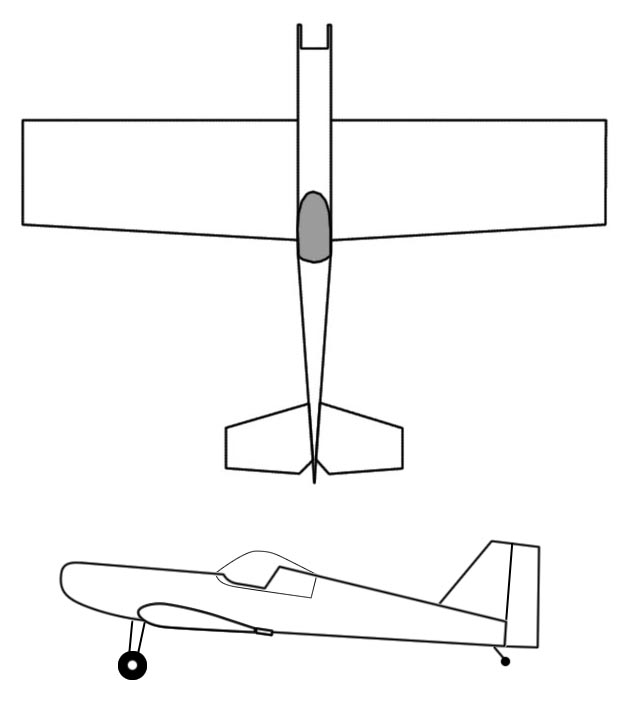

I posted it in another post but maybe you can help me. Do you have the 3 draws for a Sig Four-star that I can pop into Photoshop and use to practice covering colors on it and seeing the kind of design I might like to put on it when I finally get to my first build project this next winter?

Ask and ye shall receive
