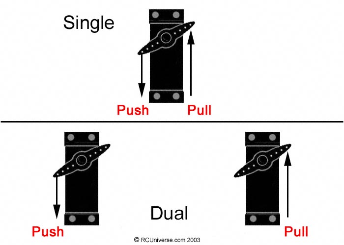

I am finishing up on my first attempt at building a P-51. The problem is this. My receiver has only one imput for the aileron so I had to use a Y harness with a reverse function. I have messed around with it some but found that the ajuster will move the servo but it wont return back to its position. Does anyone know how this works? I am using it with a JR transmitter and receiver. Thanks in advance for any help.

For ailerons you should use a regular Y-harness, not a reversing Y-harness.
Refer to attached diagram for connections to the aileron servos.

ailerons dont require a reversing Y...

Like everyone has said, just get an inexpensive standard Y harness for your ailerons. The reversing Y is mainly for things like dual elevator servos when your radio doesn't support it.

Thanks for all your advise. Thats what I did and I found that I had made a CARELESS mistake in mounting the servo. Thats why they were moving the same direction.
