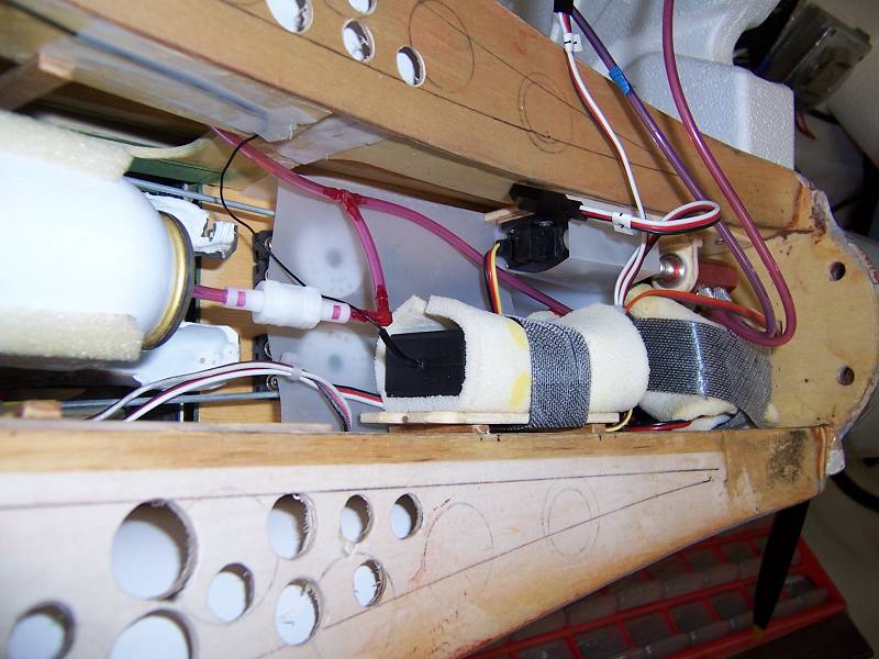

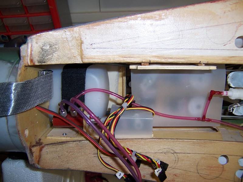

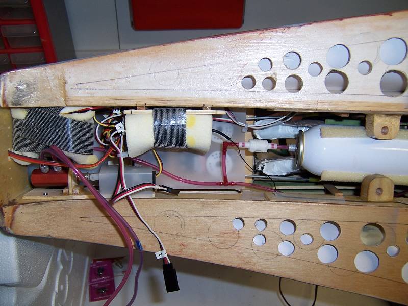

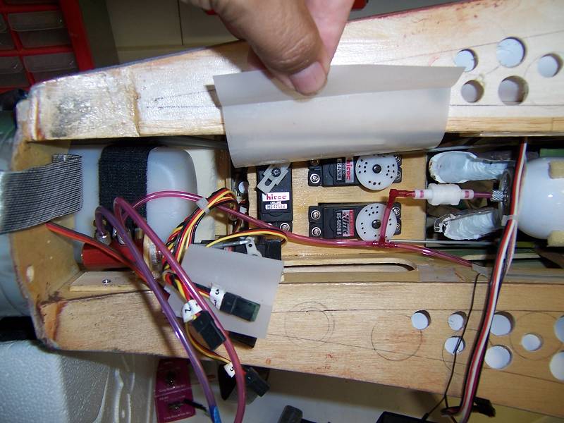

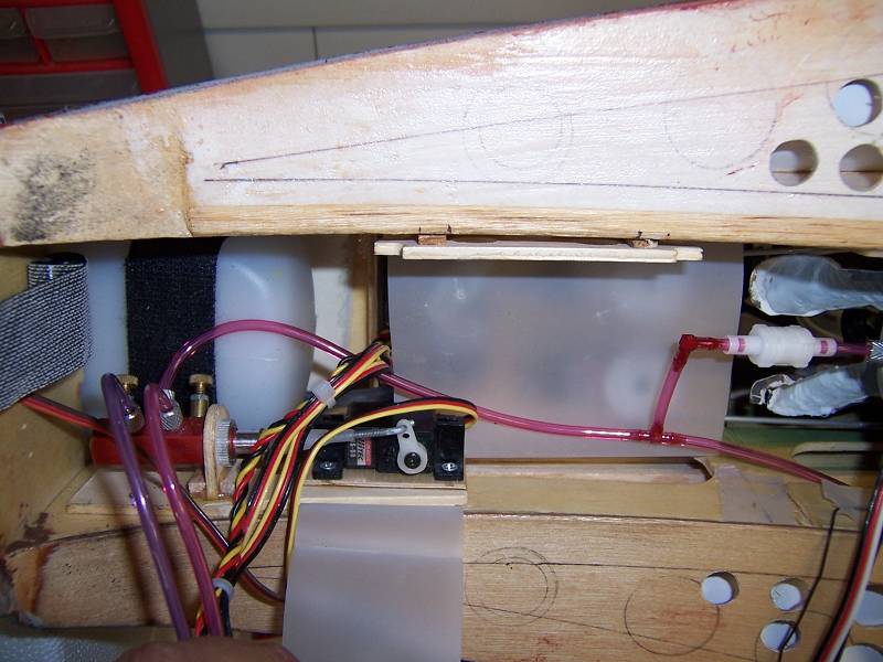

Here's the inside of my TopFlite Spitfire.
One of the things that I did was to make covers over the servos to prevent wires and tubes from getting caught up in the arms and rods. They were made from mylar. I also labled the wires by channel. The first two show the receiver and battery installed. They were removed in the other three photos. The servos shown are, gear, throttle, elevator and rudder. The trays were made from lite ply.
Scott
