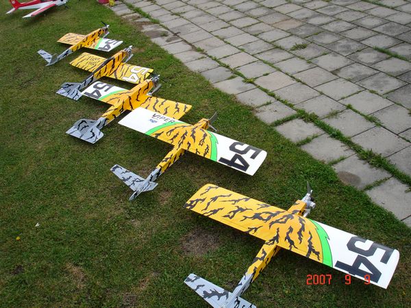

Default RE: elevator epoxy question
Hi!
It's simple! You don't use epoxy!
Use Ca glue instead!
I use "Flash" CA glue when building all my airplanes, pylon racers as well as scale
ID:	897043   Click image for larger version
