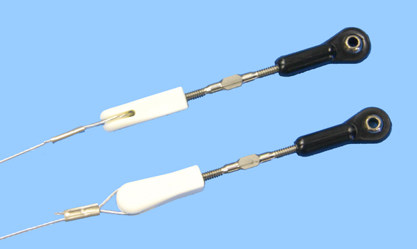

I have started using these from swb.
And if you go to servo arms, they have offset arms, this provide the ackerman without moveing the control horn up or back.

FYI, they are a little pricey, but they make life really simple when adjusting the tension as the wire stretches.
