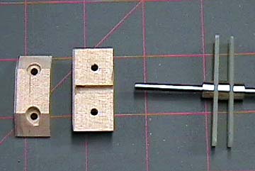

I'm using pull-pulls on my latest project for the elevator and rudder. The fuselage is not wide enough to use a servo horn wide enough to create a parallelagram. Therefore I am using an intermediate bellcrank for both controls arranged on a piece of music wire. The elevator cables will turn 90 degrees before exiting the fuselage.
The only thing I have a question about is the bellcrank material. I'm at the point now where I need to install them and don't want to wait for an order through the mail.
I have two choices - aircraft ply or fiberglass pc board. My concern is that the PC board may cut through the cables. I made the bellcranks already and radiused the edges. I'm just not confident in it.
Has anyone ever done this? If so, how did it hold up? Also, suggestions for other materials to make the bellcranks from are welcome.

Here's what I've got so far. I'm just playing around with this and haven't decided if I'm going ahead with it or not.
The two blocks are identical. They capture the music wire and will bolt to the top and bottom of the former behind the wing. The lower block will be glued in place permanently. The bolts are just to help clamp it while the glue dries and some added security.
The top block will remove so I can pull the assembly if needed. I plan to use 1/16" music wire with Z-bend at each end to hook up the bellcrank to the servo. All that seems to be fine. I'm just concerned about the fiberglass board cutting through the wire.

G10 is basically printed circuit board material, not the brown phenolic stuff..the translucent stuff (I'll bet it is what was in your pics).
And I have made the couplers using 4-40 screws..now I just buy the dang things. Never tried to make 2-56 ones!
Old 05-14-2003 | 01:25 AM
Posts: 4,734
From: Spring Hill, FL
Default Pull-Pull controls - Bellcrank material question
You are correct. In a former life that was fiberglass pc board. I used some etch to take off the copper.
The couplers are 2-56. I can make about 15-20 of them in an hour. The hardest part is getting the drill started. It wants to slip off to one side or the other of the rod. Once it gets started it cuts right through. These are tiny wire bits. It amazed me how easily they cut through that material.
So my question remains though. Do you think the PC board will cut through the pull cables?

I don't think it would cut through the plastic coated steel leaders, I use Spider Wire which is an aramid fiber and it will fray pretty easily. On the plane I'm hooking the wire directly to the G10 horn I'm using the coated steel cable. It probably wont live long enough to eat through.

All I want to know is if anyone knows if there will be a problem putting the wire directly through the holes drilled in the G10. I don't plan to use steel cable. The stuff I'm planning on using is the same as Spider Wire.

CafeenMan, it's hard to say... you might be better off to drill the holes just large enough to use a plastic clevis and a rig just like you have in post #8.

Well, I'm still not convinced. If the pc board can cut through the cable then it can probably cut through a plastic clevis. Fiberglass is very abrasive. I'm thinking either go with plywood or use metal clevises and watch them for wear. What I'd really like to do is hook up directly to the servo horn, but there just isn't room to use a large enough horn.

Yes but the clevis is already round therefor leaving a lesser chance for it to cut through it. With just a cable it will be sliding back and forth in the hole...

I agree that a clevis is the way to go if using the fiberglass. I was just saying that I would trust a metal clevis more. I check stuff like that often enough that if I noticed wear on the metal clevis I could replace it before catastrophe strikes. If I had some nylon material I would make the bellcranks from it and not worry about any of this stuff.

If you are using fishing line, why not use fishing tackle? Like swivel links at the bellcranks.
