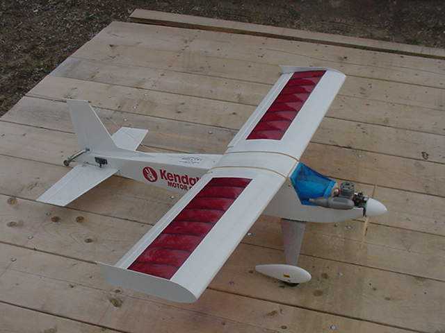

My SST .40 was a trike gear design I bought as a framed-up project. I added a 1/4" ply plate and a set of aluminum main gear (1" forward of LE), a Klett tailwheel, and pants. On takeoff, throttleup must be made gradually, and the spring steering of the tailwheel makes for wide radius turns. The tendency is for a lot of rudder to counter the mushy tailwheel response, but when the tail lifts, you now have full left rudder causing a ground loop. I'm going to experiment with a little braided dacron fishing line to limit the stretch of the springs to firm up tailwheel response. The mains work fine, and the plane looks sportier, especially with the pants.

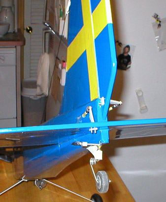

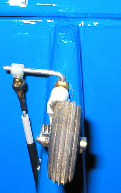

As for the steerable tail wheel, I also have a taildragger trainer with a rudder that doesn't extend below the elevator. I used a Sullivan tailwheel bracket with a pushrod running from the rudder sevo to an arm I drilled through the brass bearing. I hope you can see enough detail in this picture.
Old 06-08-2003 | 08:23 PM
Posts: 212
From: Barnegat, NJ
Default Tail wheels on Trainers?
Maybe this one is better... It is from underneath looking up at the wheel.

Woodpile.. Thats a great idea. I wonder if there is any other way?
Thanks for you input.
Mac
