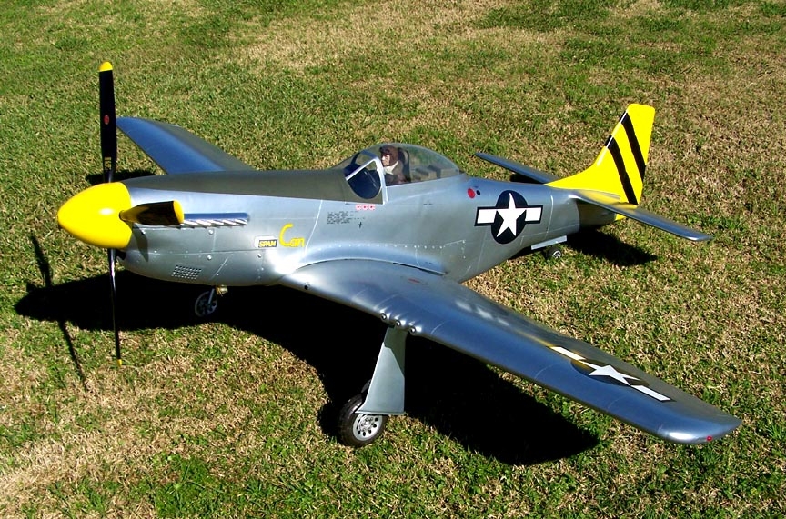

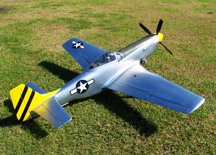

I used Dupont paint on this aircraft , I did'nt scuf the paint prior to applying the clear ,
somewhere around a weeks time between shooting the base coat & clear , just how are you supposed to apply your graphics that
go on before the clear , over wet paint ?
anyway , it's going on four years now & no problems !

as for letting the base dry for at least a day before i applyed the graphics , & also was around a week or longer before i had time to shoot the clear,
I'm not saying that i did it the right way , but it come out just fine , i'll try to get some pic's of this one this evening,
51-D GUY.
