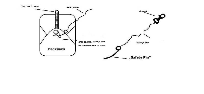

Hi Guys
I'm planning to attend a R/C Skydiving on mainland Europe and spotted that they impose a rule on safety devices to prevent inadvertant opening of the pack during the climb.
What I need is a couple of ideas on how to accomplish either method.
The rules below were cribbed from the Dutch website
"1. You make a safety switch, for instance 2 micro switches who turn the jumper off when it is mounted under the aircraft through use of a safety pin. When the doll is dropped, the switches will be turned and the jumper will be turned on.
2. A safety line attached to the back pack of the jumper. This is an
extra safety so the chute can not be opened when the jumper is mounted under the aircraft. When the jumper is dropped, the pin will be pulled from the pack and the pack can opened on command".

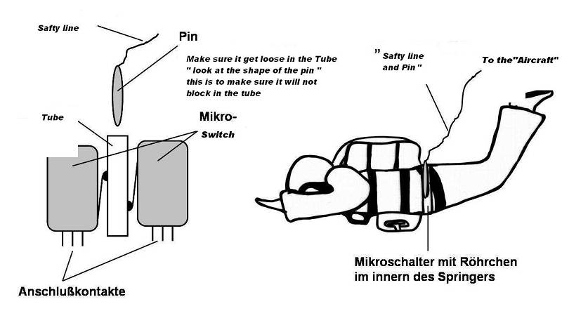

Hi Paul !
I have some drownings of the safety switch , so you have a look how it is ,
If not clear to you let me know .
Gordon

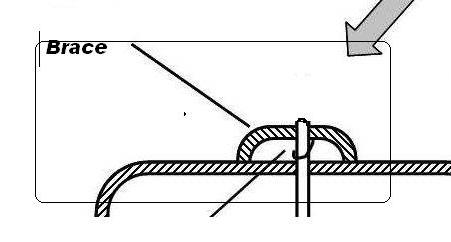

Many thanks for that. I see the switch-tube arrangement....but I'm struggling to work out what the second image is showing me.....I'll look again tomorrow when I've had some rest.

hello Gordon,
i am using both methods of safety.
first i used teh microswitch to turn off the jumper and have a safety line pull the pin. This line could be a electric wire you put in the tube.
This can bend all ways so it will pull all the times.
when you use a hard pin it sometimes sticks in the tube.
the one i use now is the safety pin on the backpack.
jumper is switched on all the time and the chute can only be opened when the pin is pulled.
this works best for me...
we had 2 chutes blown out when hanging under the jumpplane (ones without the safetypin in the backpack) and landing with the chute flapping behind the plane is no fun.....
it brakes like.......
but both landings were ok and no damage to the planes.
Pieter
