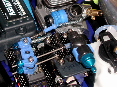

As I posted last weeK I suffered quite a bit of expense due to my car doing a "run away" on me ! [:@]
Somebody told me to put a Biro Pen spring on the throttle to stop it from doing this again.
Can anyone tell me how to do this or show me pics of it ?
Thanks.

I use two springs, could never get one spring to close the carb properly.

today that throttle return spring would really have helped me i always run with a failsafe but in this case it was useless.... i got up to full speed and my throttle servo scre came off and i had no breaks or power at the servo cause the horn came off and went down a road at full speed and if i had that spring it would have saved me... i am now going to buy one in case that happens in the future...thanks for the pic of how to do it

no failsafe will help you if your (not even your futaba radio) crystal pops out or fails, or for some reason power ( ie voltage) is severd from your servo you are stuffed without a mechanical failsafe. ( ie spring attached to the outer hole on your throttle horn and mounted onto one of the springs on your center diff tower )

No problem! I hear you on that case for sure! I do run a throttle return spring too just for that reason though. I hate run-a-ways, thats alot of money running out of control!

as rubber band does the same purpose as a return spring.
