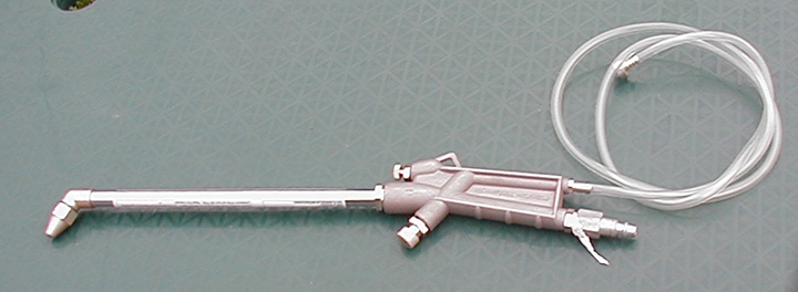

How I do it,,,
Remove body and wheels
Clean them with "simple green" and water, hold the wheels face up making sure you done get water entering the wheel vent holes. Soak down with the simple green, let sit a few minutes to soak in and then rinse with warm water, set aside or dry with a towel.
Chassis,
I use a air compressor, denatured alcohol and one of these siphoning spray guns, It acts like a mini pressure washer, then make sure to blow the car dry as much as possible and your looking good.
