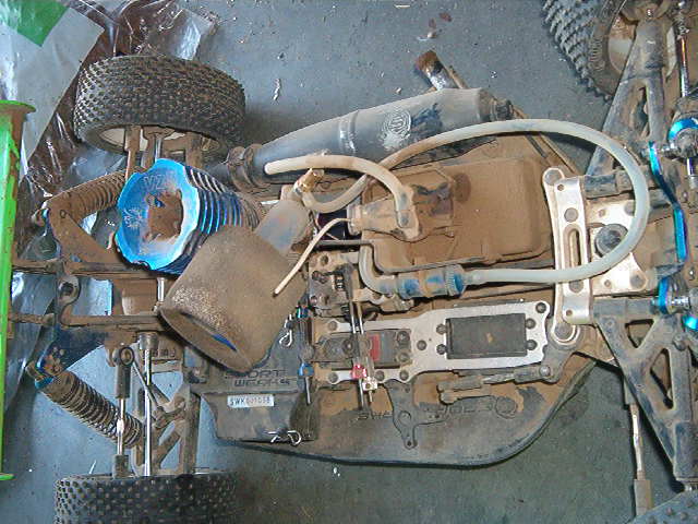

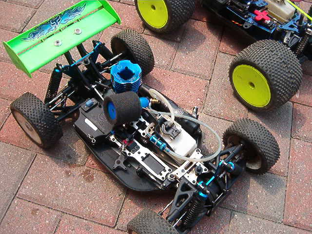

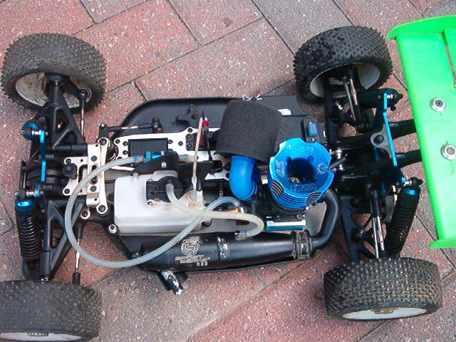

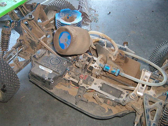

Just thought i would post some pics of my mayhem from the track practice last night in ontario canada....
I am very impressed with this buggy...
It was a little dusty at the track.. I almost couldnt see the buggy any more on certain areas of the track... I got home and all i could say was WOW... your a mess... then I cleaned it...

Tell us how you went about cleaning them up. I use denatured alcohol, tooth brush, air compressor and then followup with WD 40.
Rockman
Old 08-03-2005 | 05:34 PM
  #417
RC RAC3R's Avatar
Joined: Jan 2005
Posts: 558
From: Barrie, ON, CANADA
Default RE: Official Mayhem Thread
ORIGINAL: Rockman
Rockman
took engine out.. and electronics.. then let loose with a can of WD-40 then air compressored it off...
I let the WD-40 soak for a min or 2.. then just air compressor the rest of it off...
Old 08-03-2005 | 05:40 PM
  #418
Joined: Jan 2005
Posts: 469
From: Houston, TX
Remove engine/electronics................water, toothbrush, air compressor, wd-40, air compressor...............reassemble
