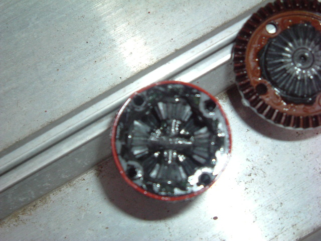

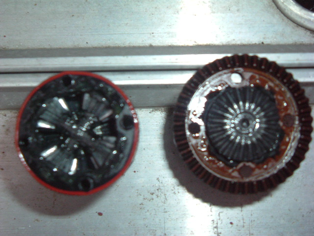

hi all, im having a bit of a dilema, i stripped the car today and washed it with wasing up liquid and water, well that went well it dryed, i took the elecs and engine bare in mind, but i turned the rear hub carriers and they were tight i stripped that and air compressed the gunk out, then re assembled it, but still the same i stripped the diff and water came out is this the problem?
please look at the pics, there is loads of gunk in there aswell do i need to take it all apart then wash it then wait to add my new oil in thanks

First off,, stop using a water hose to clean your car, it will rust up everything metal
Second, what is all the redish on the ring gear?? hi-temp silcone gasket materail (RTV)?
If this was an RTR, clean all the grease out (all the grease) and rebuild the diffs with Diff oil
5k front 7k middle and 1k rear is a good basic set up

hi it wasnt a rtr i was told by a friend to use 1k in the rear 4 k in the middle and 2 k in the front ok i wont use the hose anymore my bad, i have seen loads of people use jet washers, 2nd the redish is the colour of the actul thing, had anytips what to use to clean it out all the grease
thanks

Wow,
then that's rust,,, no more water my man
When I spray down my car I use Denatured alcohol and a siphon sprayer
The I make sure I dry the car completely with an air compressor spray nozzle
I used, lacquer thinner or acetone to clean the metal parts
and Simple green to clean the plastic parts
The simple green really cuts the grease and dirt

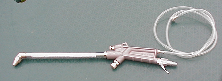

I use WD 40 for cleaning out oil from diffs and it works really well. I just spray some into an empty can, split the diff apart and chuck it in (not the o'ring). Use a tooth brush (old one preferably) to give it a good clean out. When finished, use kitchen towel or something to dry it off. Then fill it back up again with diff oil.
Talking of which, 4000 sounds a bit low in centre, 10,000 is more common. Dont mean to preach to you, you may have a good reason for running 4000, just thought it was worth mentioning.
